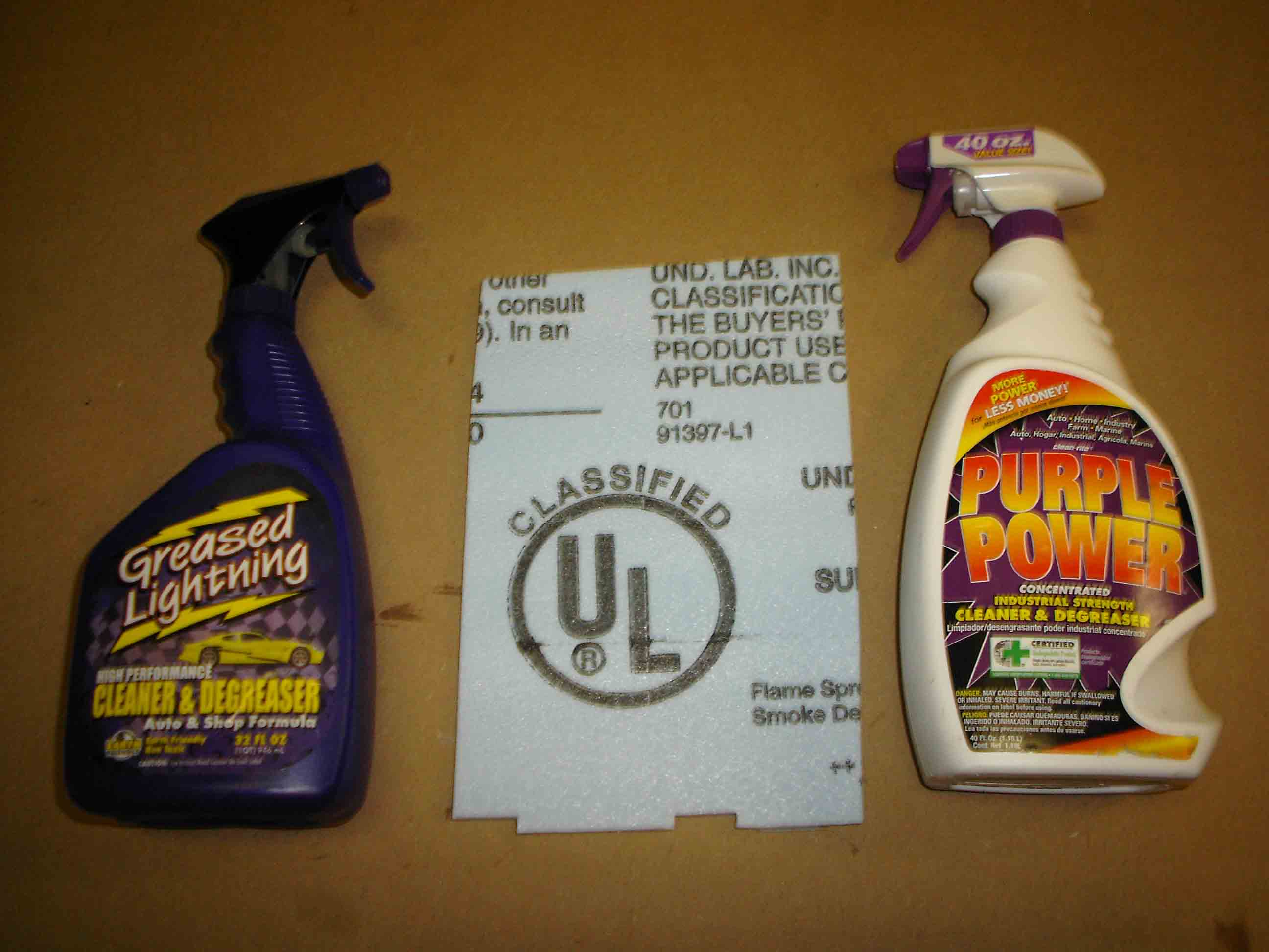

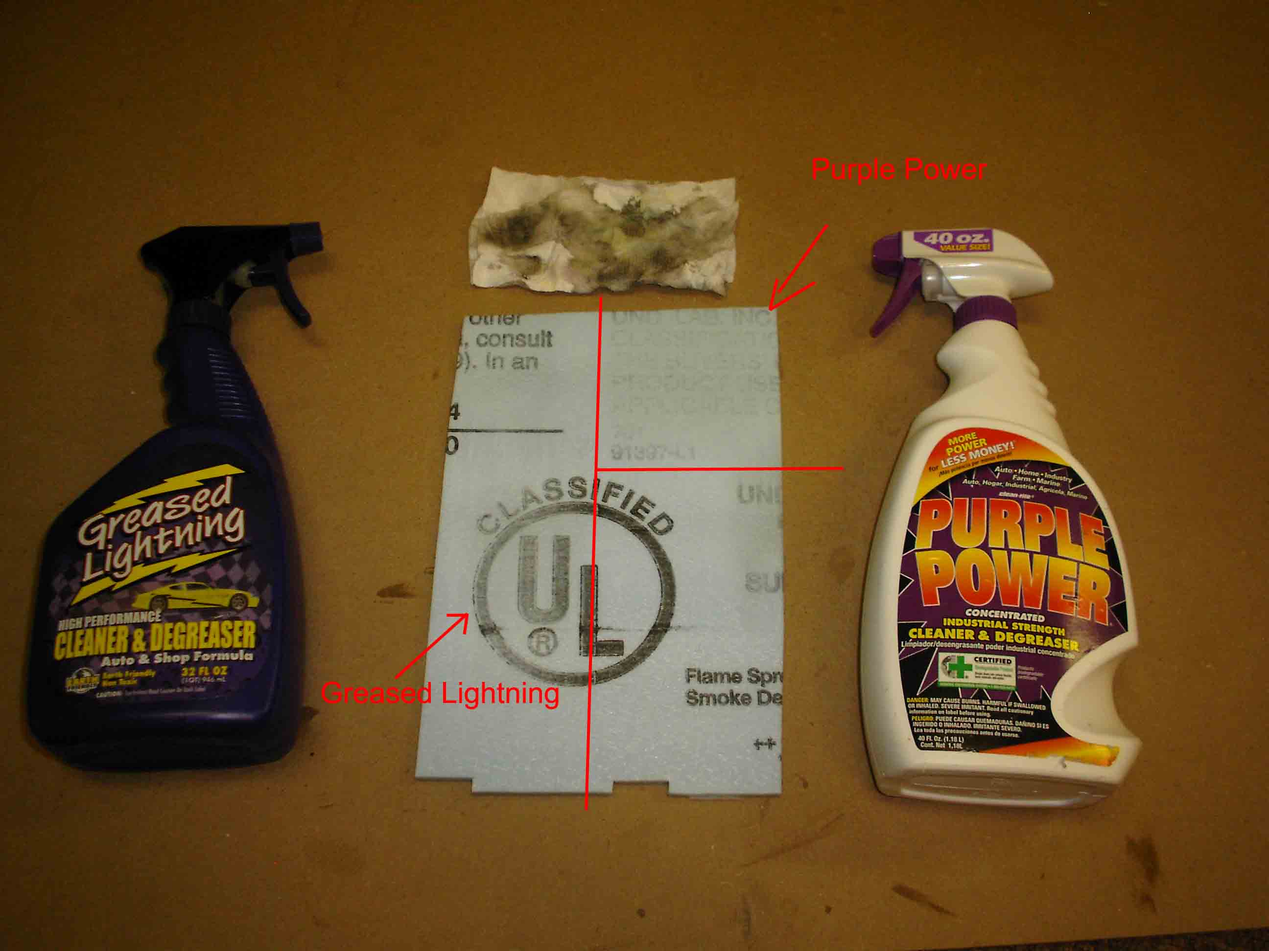

    Well I tried some tests today on some PBIII with the Greased Lightning and with some Purple Power I had here.
    I found the results were a lot better with the Purple Power. I treated the foam 3 times to get the results shown in the pics. I couldn't get all the ink off but it did a pretty good job. I did try it on another piece of foam where the ink wasn't as dark and the Purple Power took all the ink off. I guess it depends how bad the ink is on there.
    One thing though, the Greased Lightning I have had sitting around for quite a while and maybe it just lost its punch but here are some pics of my tests. Attached files [​IMG] [​IMG]
