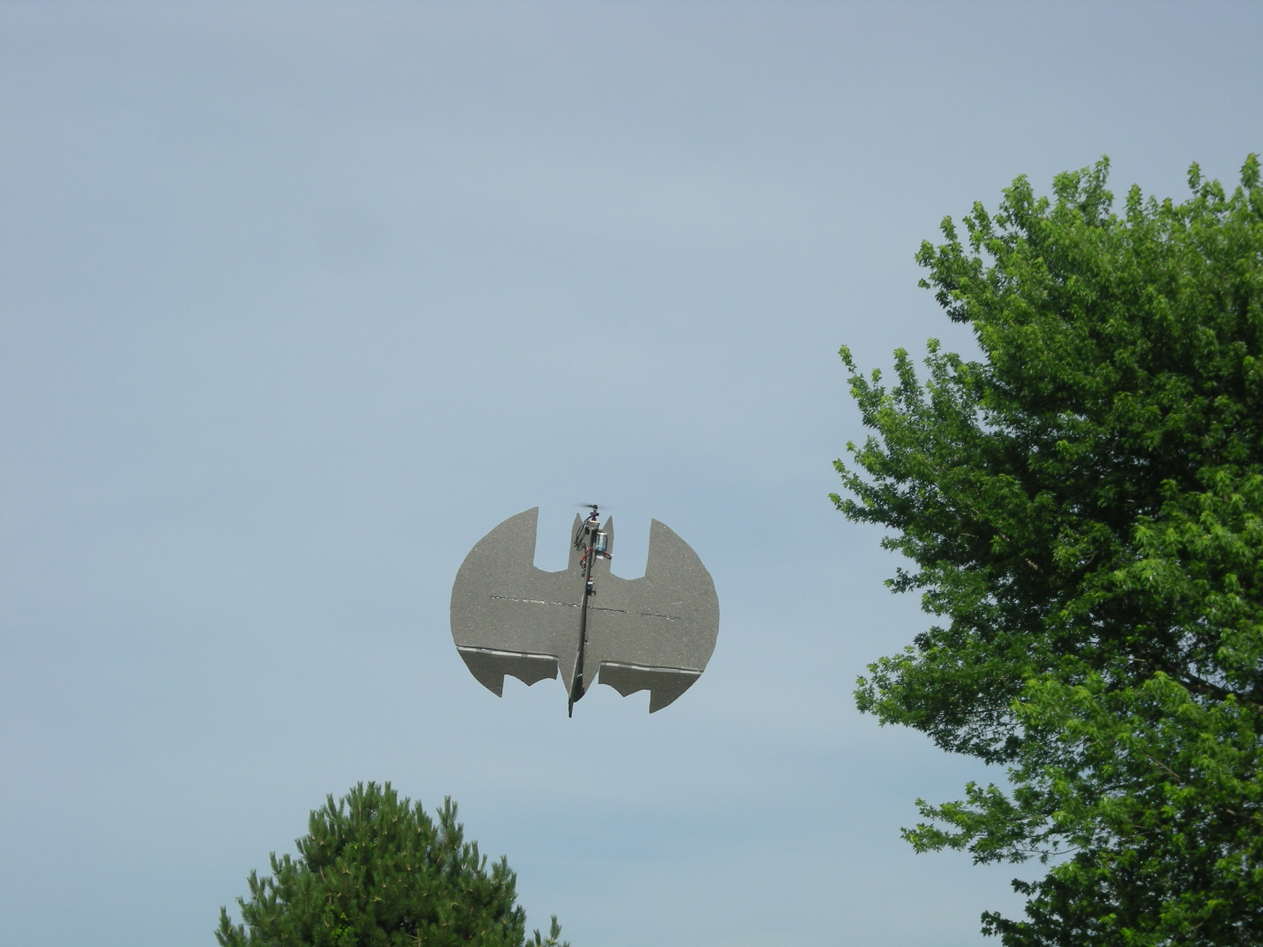

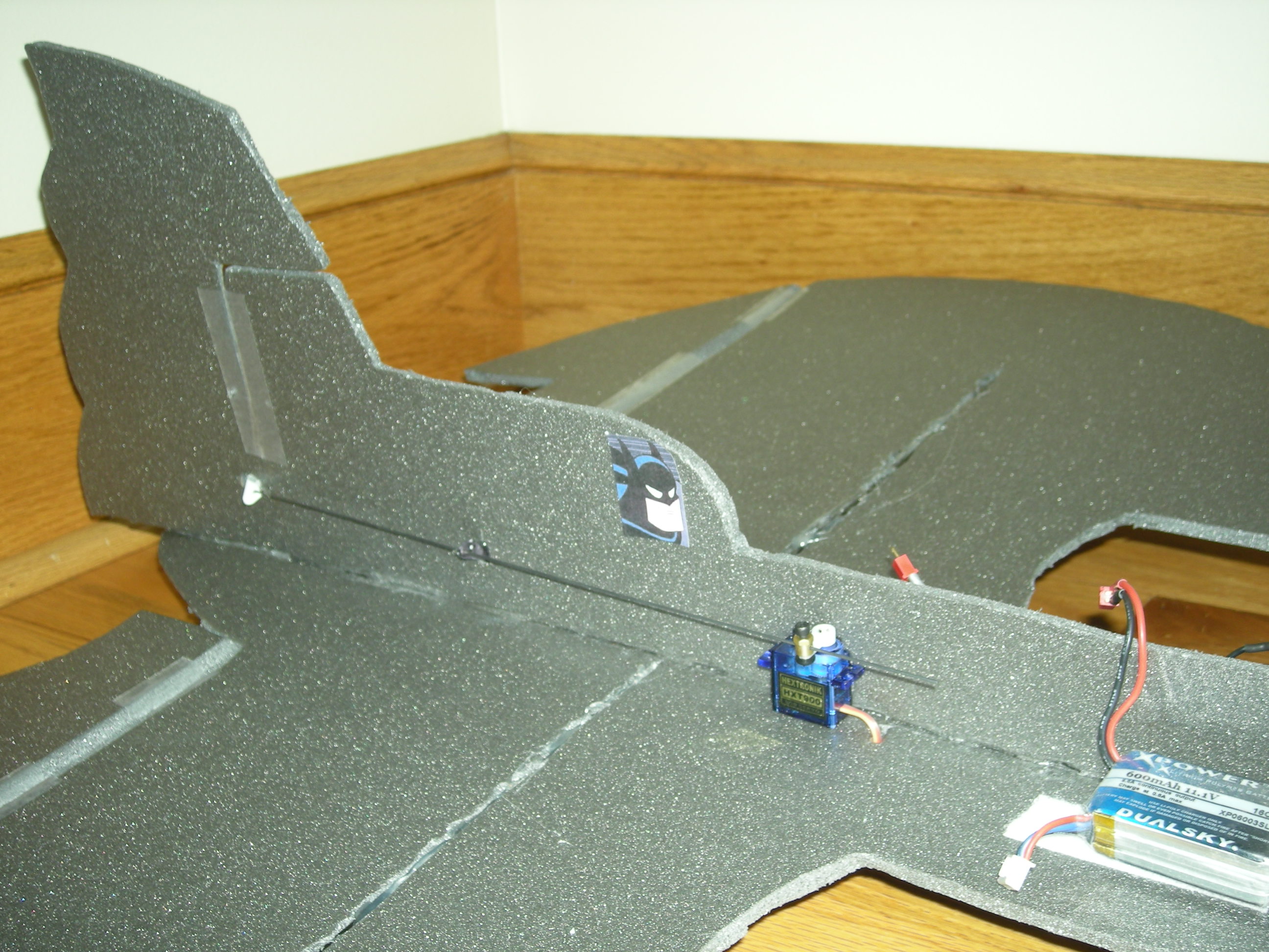

    Just finished up my latest build. Just could not figure out a good way to stiffen up that nose and finally just put a cf rod across the front to keep the flexing down. Need to make some minor changes and I'll put this up. 37" ws and it is very rigid now.
    [​IMG]
    [​IMG]
    oh man this thing flys great. No trimming at all right out of the hand. auw 27g. Could have gone with a rudder but elevon control was great. :)

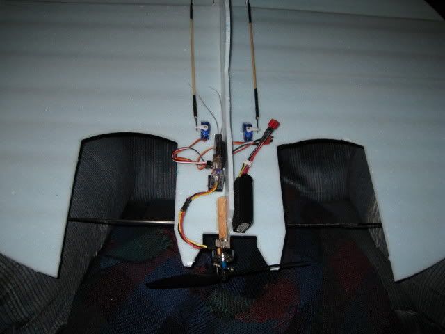

    I see your using a pushrod method I just figured out.
    I use to always do that but with carbon, then the other day I remembered I had some thinner than usual bamboo skewers and thought they should work just as well.
    I was surprised how great they do work, and they are lighter than the carbon I was using.
    No slop at all.

    Yeah. I got tired of using the metal control rod. Thought hey 1/8" dowel is strong enough. Just use my z bend pliers and some electrical tape and I'm good to go. Done quite a few so far and no slippage or failure. I use credit card strips for control horns. Just heat up the control rod and run it through for a no slop connection.

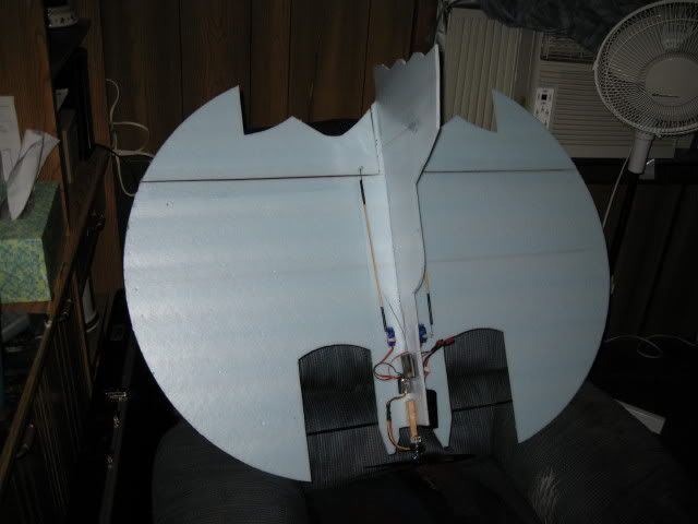

    Here's Mine!
    Video soon!
    Nate Attached files [​IMG] [​IMG]
  7. frankrcfc
    frankrcfc New Member
    381
    Battle Creek, Mi
    Sweet Nate! Glad you made that ;) . I have flown the heck out of mine. The neighborhood kids can't get enough of it. :p
