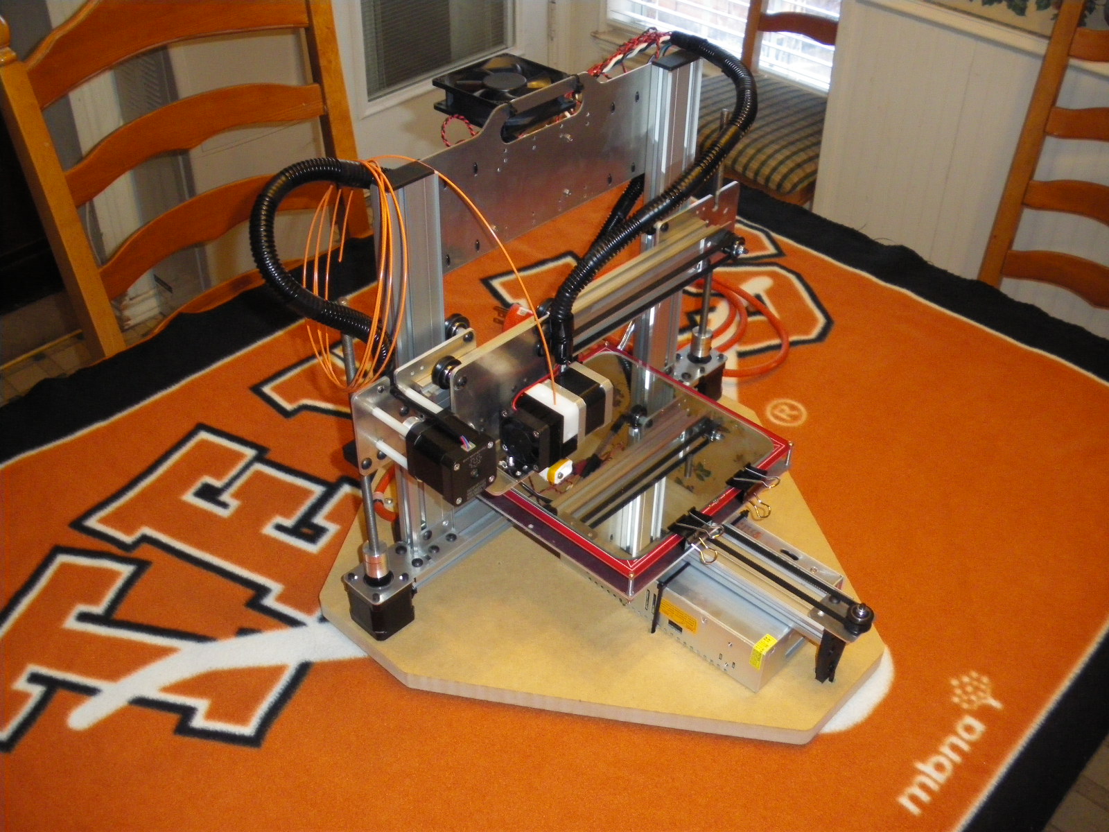

    Okay, this is NOT a build log, but I thought I might create a spot to show off MY PhlatBOT and share whatever I can that turns out to be cool, or maybe even a bit informative.
    Below are some pics of the machine.
    Please note that my machine will be mobile, in that I intend to take it with me to HAM club meetings, events (like SEFF), and maybe even next time I take one of those two week vacations in MI to see my family. Also, in the winter when it's a tad cold in the workshop, I'd like to more easily move this machine from the shop to the dining table so I can play with it and be in the same room as the family. :D

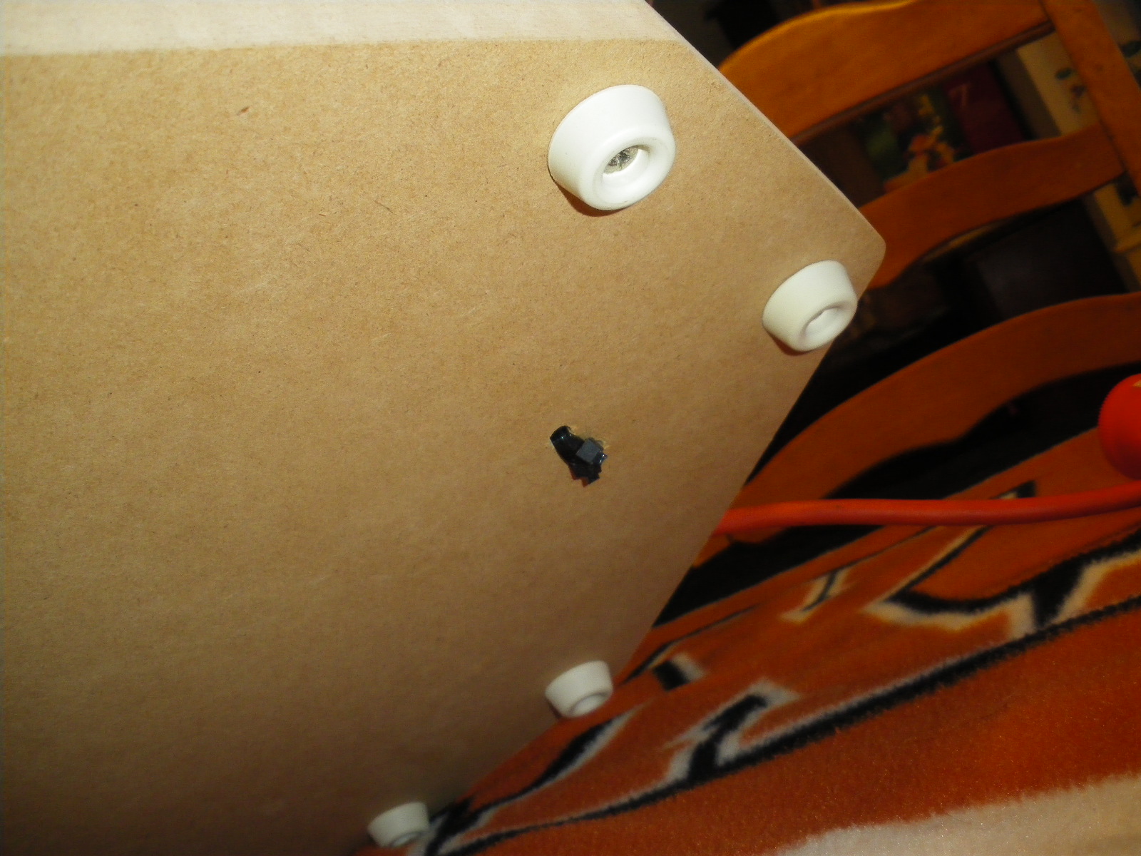

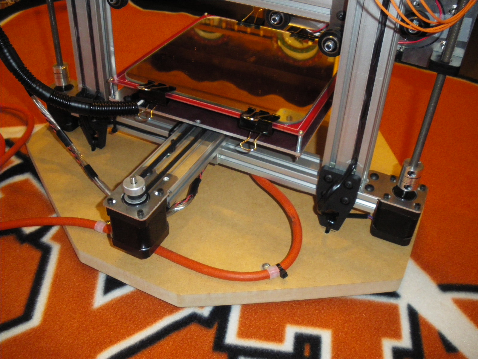

    That being the case, I wanted to be able to grab ONE thing in addition to the laptop. My solution was to cut out a plate of MDF and affix everything to that. I also needed to be certain that no scratches would become of the dining table, lest the little wife poison me or kill me in my sleep.
    The MDF is 3/4" thick and cut to a size just large enough to capture the footprint of the PhlatBOT. Currently I am using some heavy-duty zip ties to hold the machine in place on the board, but I will use some hardware I will obtain with the next trip to Lowes. On the BOTTOM of the board, I have some of those little rubber feet (I used 8 - two four-packs I got at Lowes for $1.95/pack) to keep the thing from scratching any surface I put it on. It also keeps the machine from sliding around and the ones I used are 7/8" tall, so the zip ties have enough clearance to keep from scratching everything.

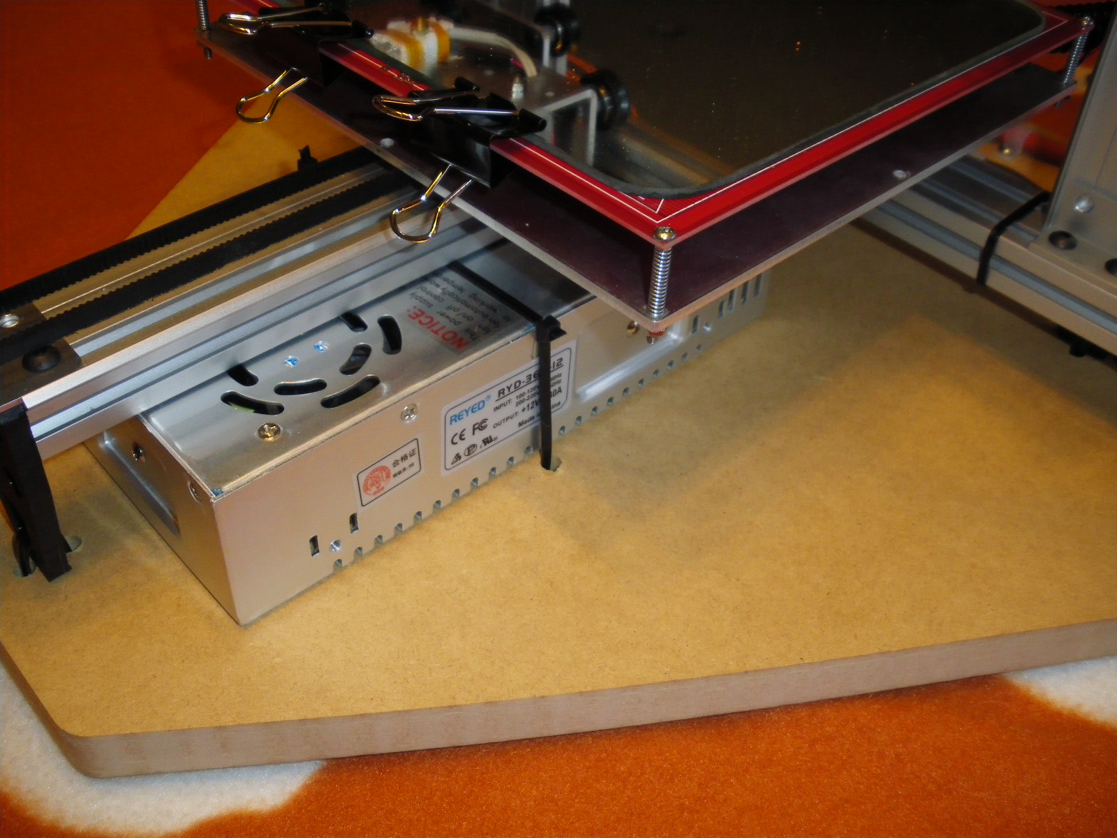

    The power supply is mounted in the preferred location, but is actually stuck down with two-sided adhesive tape (carpet tape that I use on my big CNC to help hold parts in place). I have zip ties on it, but it's more of a safety measure in case the tape comes loose.

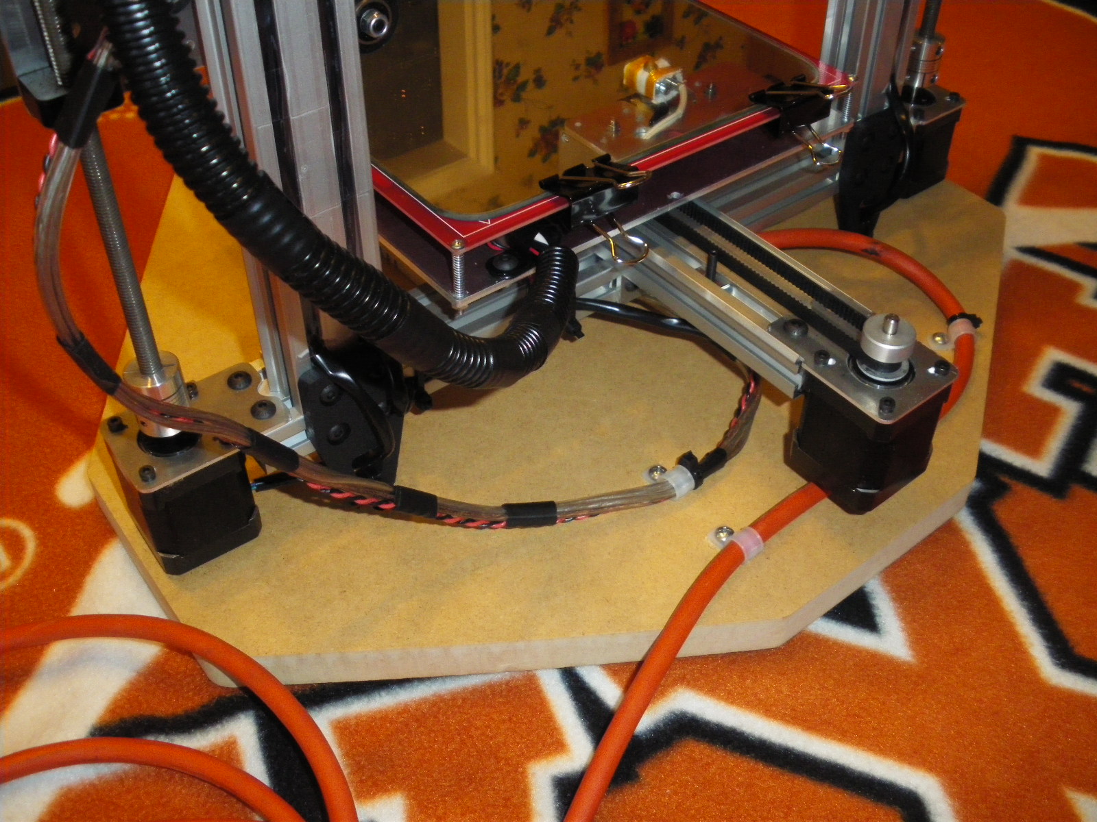

    If you look at the back of the machine, you will see that I have used some wire-keepers screwed down to the board to take any stresses away from the power cable's connection to the power supply.
