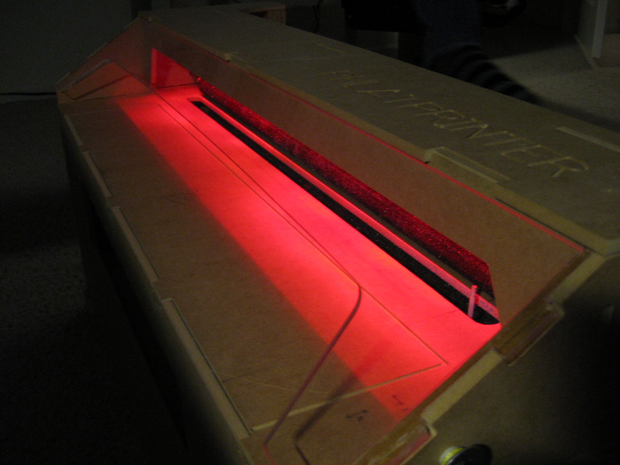

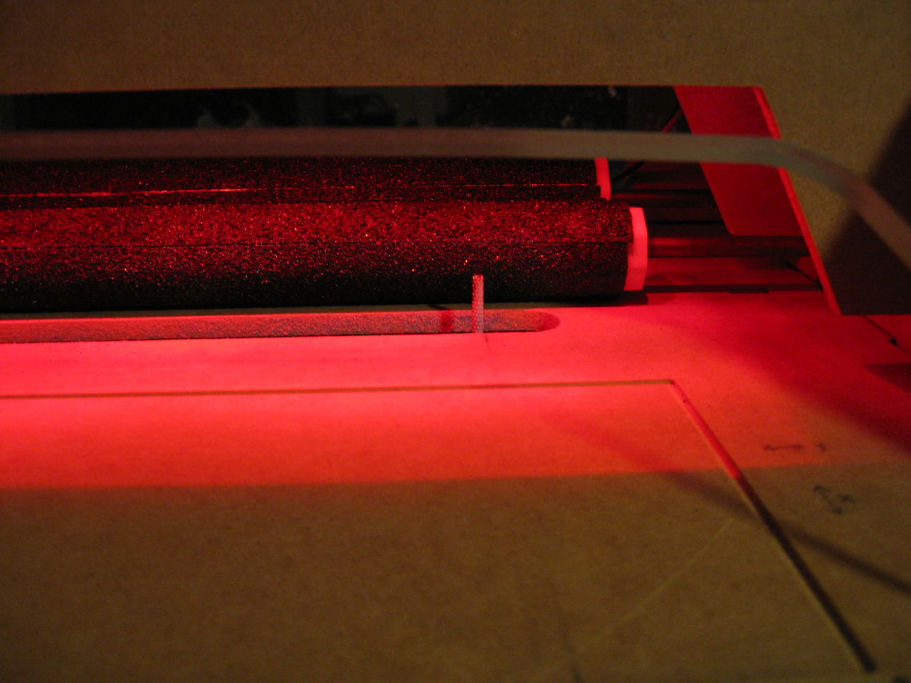

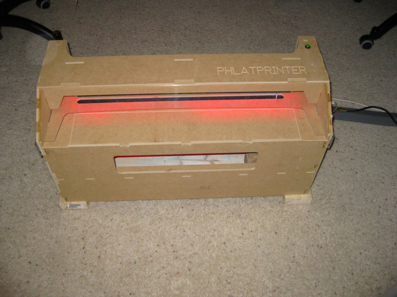

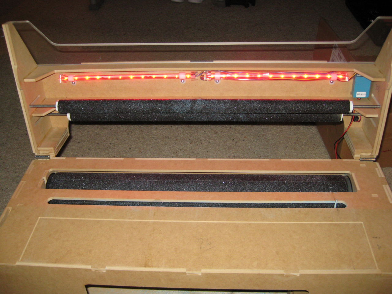

    I was inspired by some the lid light mods posted and got to thinking about some old LED light bars I had left over from a computer case mod after Rjarois mentioned pimping out our PhlatPrinters in another mod thread. The two LED light bars are from the Logisys Computer Meteor Light Kit: http://www.newegg.com/Product/Product.aspx?Item=N82E16800888052
    Attached files [​IMG] [​IMG] [​IMG] [​IMG] [​IMG] [​IMG]
    meistertek, Too much! that is tops. Great job
