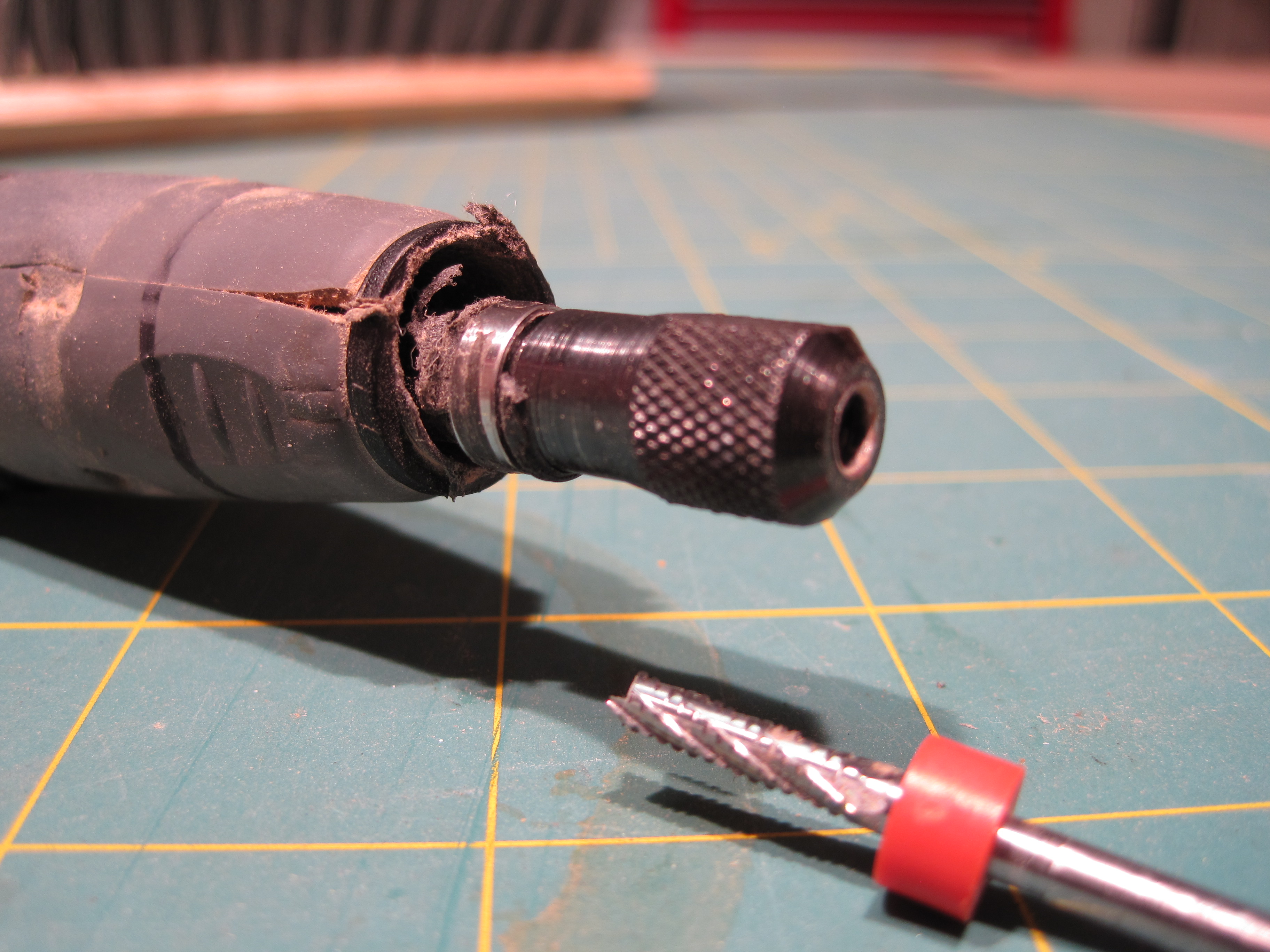

    Shredded my rotozip attachment tonight :oops:
    Was having a blast cutting MDF today with my new improved drive roller (thanks M&T!). Unfortunately, I got carried away and ran a job that took 2.5 hrs with lots of complex shaping and depth changes. Guess I was pushing it at 25ipm... Attached files [​IMG]

    I think what we are learning here is heat IS our enemy! Even if the spindle can be on all day with no problem, when we start cutting stuff, anything, the tool will get hot. this heat transfers to the shaft, then to the bearing, cooks the greese, heats the bearig more and the plastic melts. And flex shaft death occurs.
    Maybe its time for me to make the all metal spindle mod. :)

    Believe it or not! Multipass was on. It milled everything out perfectly, but the failure point was in the drill-plunges. I think the plunges went into the material too quickly, possibly the material was slipping so each successive depth plunge was hitting adjacent material?

    At my previous company we worked with Foredoms for grinding stainless steel. We used variable foot controls, but we would run these for long stretches (3 and 4 hours at a time). The amount of bend in the flex cable makes a difference. The less the better.
    But in this case it doesn't look like it was the cable that caused the failure more like too much side pressure. That bit looks dull but that could just be the picture.
    If your bit wasn't cutting up to snuff, then is it possible that it was pushing your material out of line, then you next cut would be even harder which would push the material out of alignment and the process would snowball. Of course this is just speculation on my part.
    Also is that the right cutting tool for MDF? I'd think a sabre bit would be better, but that is an inexperienced guess.
    On my CNC lathe I learned it is better to replace the tool even if it still has a little life than to run it till it fails.
  10. ToxicToast
    Hey Slick, you may be right in that it might've not been the right bit for the task. It was brand new when I started this, so I don't think dulling was the cause. It was probably overstressed. I had it set for multipass on this job, but subtle slippage in the position of the material meant that later passes were actually digging into more material and putting much more strain on it. I could hear it but since the MK2 cuts from the underside, I didn't want to risk aborting the run until it cut more. Then I heard the noise get much worse so I aborted it then. The slippage was noticeable and you could see where the later passes were starting to have to go through more material. So your theory is pretty much spot-on.
