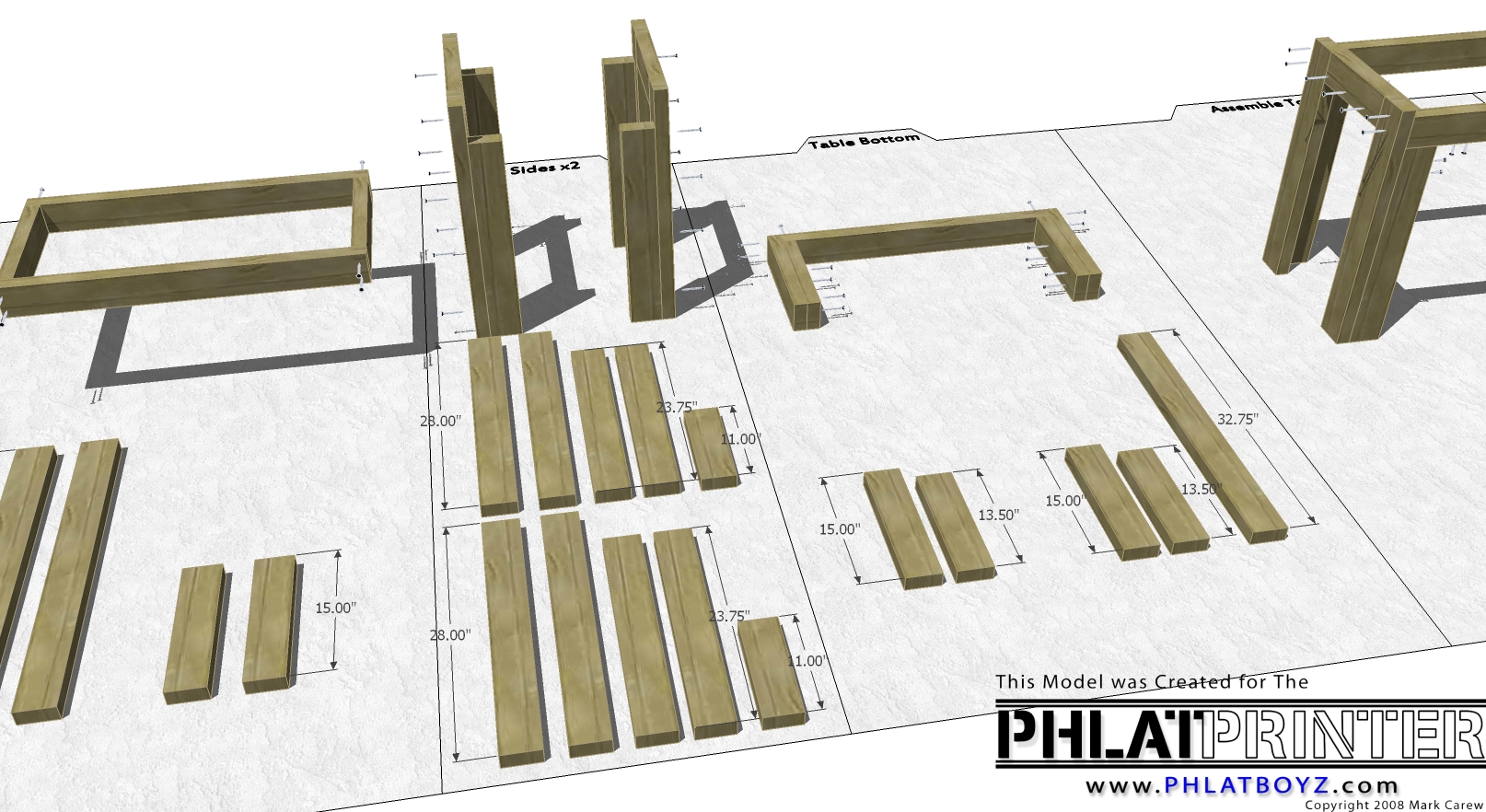

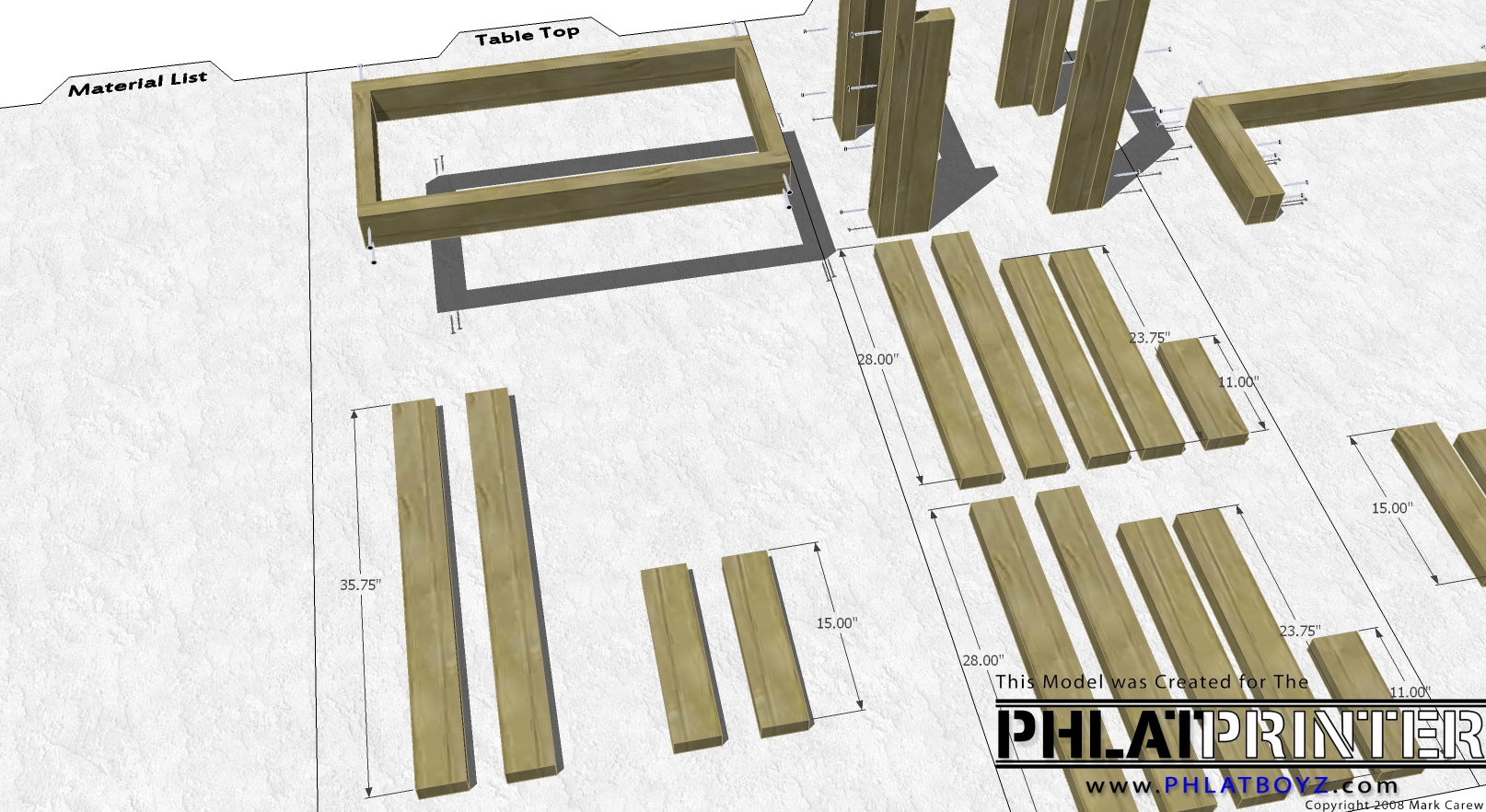

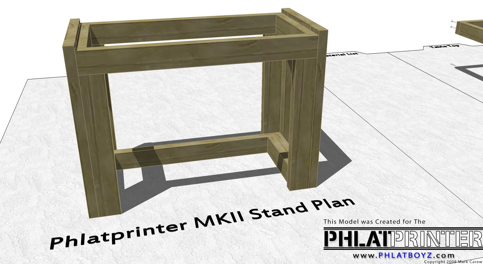

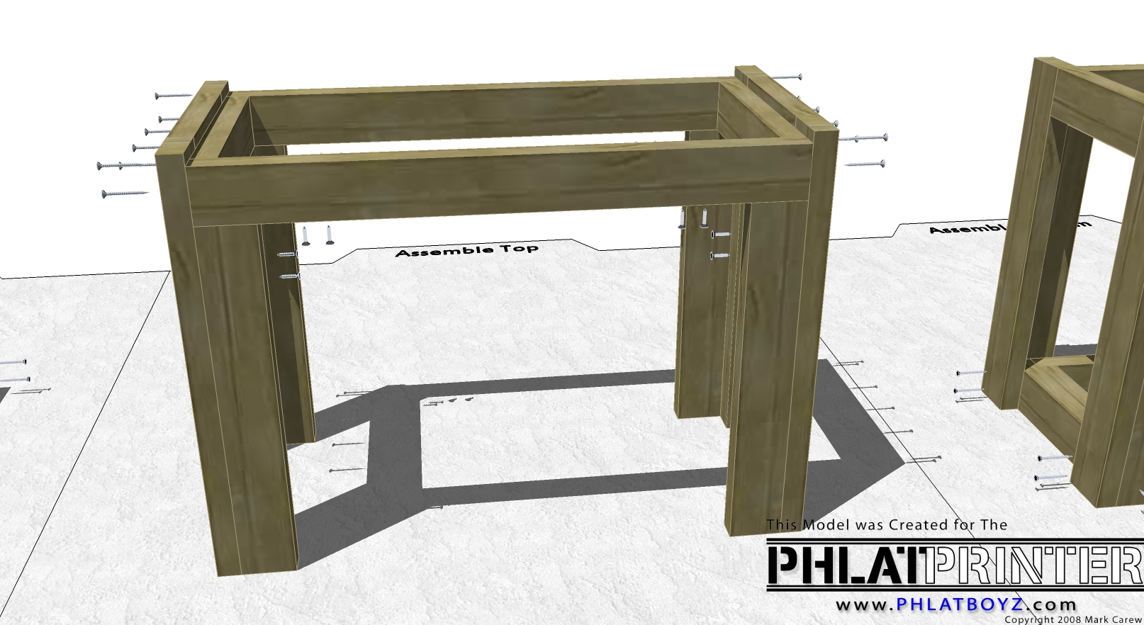

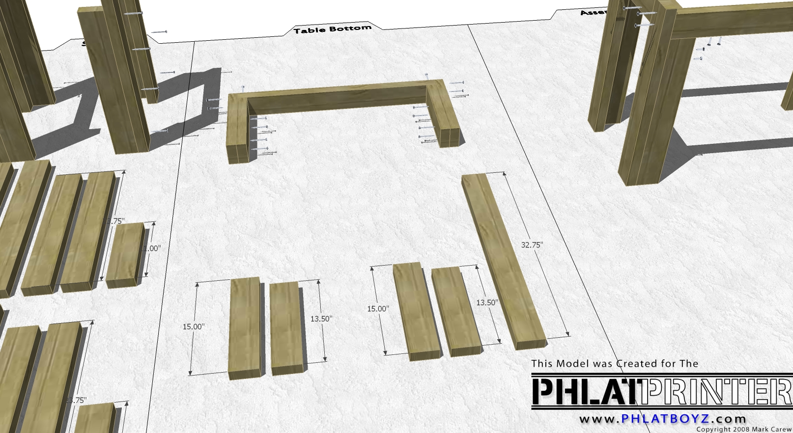

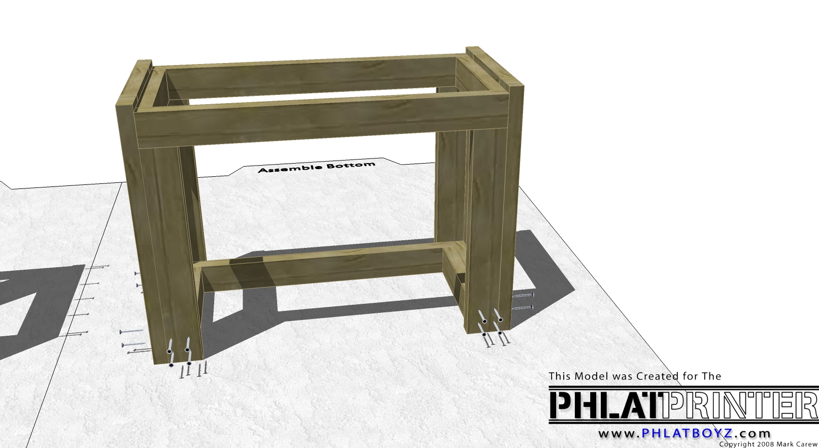

    Guys here is a simple quick and cheap stand that will work to hold your Phlatprinter MKII .
    This stand is the same size (height wise) as the official MKII stand, so you could add casters like the official stand to bring this stand to the proper height.
    We sell the casters at the Phlat-Store if you need to get them.
    http://www.phlatboyz.com/phlatstore/#ecwid:keywords=casters&mode=search&offset=0&sort=relevance
    The material list is located in the Sketchup file along with build instructions.
    In keeping it as simple as possible this stand is made from 5 - 8 foot 2x4's a few 'L' brackets and screws.
    Feel free to modify these plans and share your version with others here.
    This design is untested as of yet so the first person to build one please let us know how it works out.
    Hope this helps
    Thank You

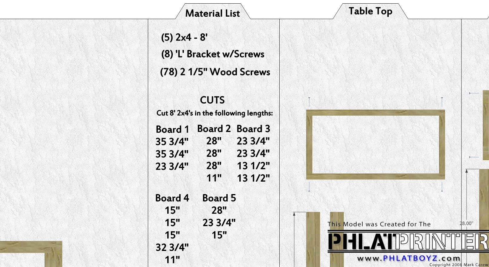

    Just ordered my MKII :D and will probably build this. Thanks for the easy design Mark. I was looking at the materials list in the pics above and was wondering where you get the 2 1/5" wood screws? ;)
    :lol: I am sorry about that good eye Tim LOL :)
    2-1/4"
    Thank you Tim

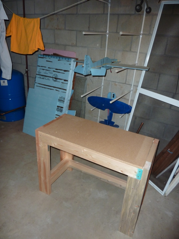

    Well, here it is. I built the MKII stand today. Spent about 2 hours building. It goes together pretty easy. One tip that I did was when cutting the parts, was to set a stop for each of the lengths so that they are all exactly the same. That made assembly really easy.
    I put a piece of MDF on the top for now. My MKI will reside on it until I get the MKII built. Just need to get some casters at the hardware store tomorrow before I put my Phlatty on it.
    Tim Attached files [​IMG]
  16. kram242
    SWEET! looks great Tim thank you for sharing this
