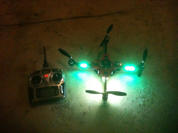

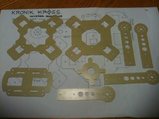

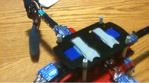

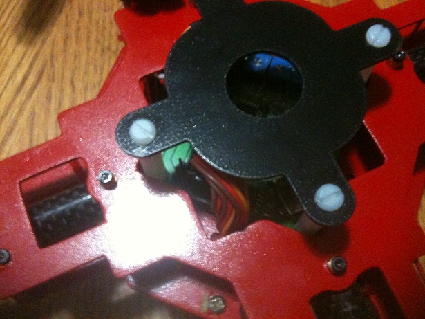

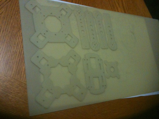

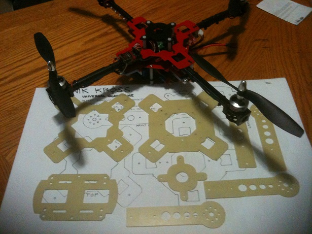

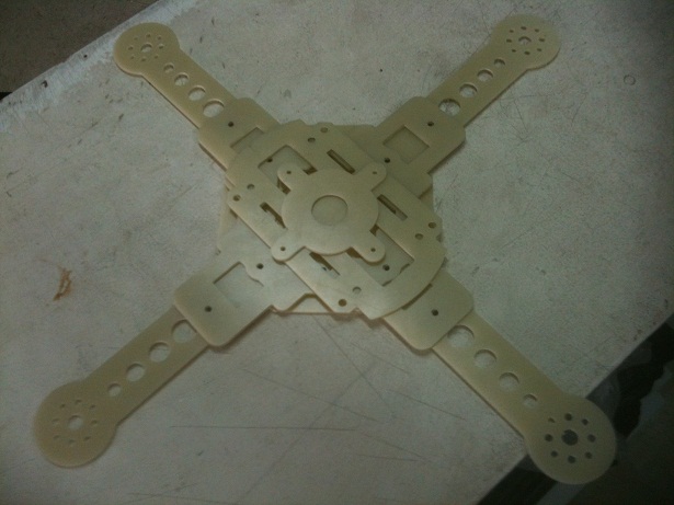

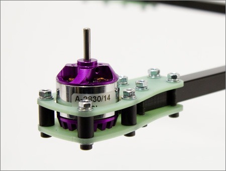

    HAPPY THANKSGIVING TO ALL! ....here's my gift to everyone. :D
    KRONIK KROSS...
    ENJOY!
    http://www.youtube.com/watch?v=sch2ncLan4o

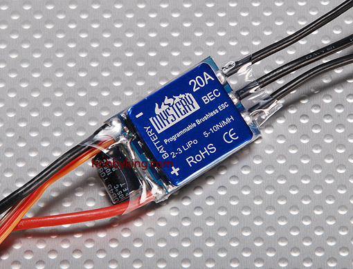

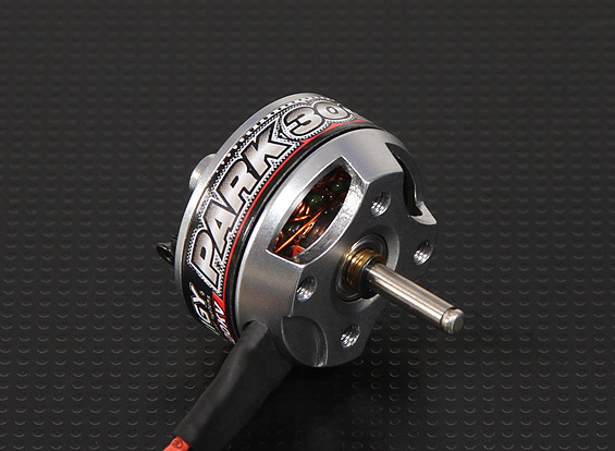

    HK QUADBOARD V2 with 4.7 firmware
    Turnigy Park300 1600kv Motors
    20 amp Mystery ESCs.
    8x4.3 props
    1800mah 3s 40c skylipo
    G10 1/16 fiberglass frame
    CF boom for arms.

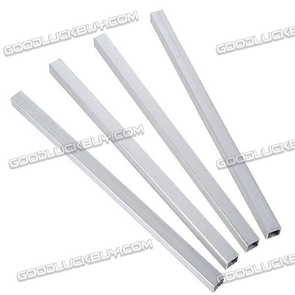

    ....You can use 10mm x 10mm aluminum arms or similar.
    ALB :D RT Attached files [​IMG] [​IMG] [​IMG] [​IMG] [​IMG] [​IMG] [​IMG] Kronik Kross.pdf (141.2 KB)Â KronikKross.zip (64.3 KB)Â

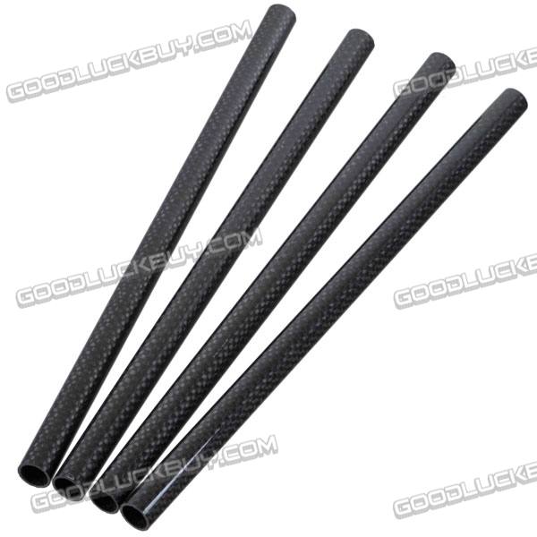

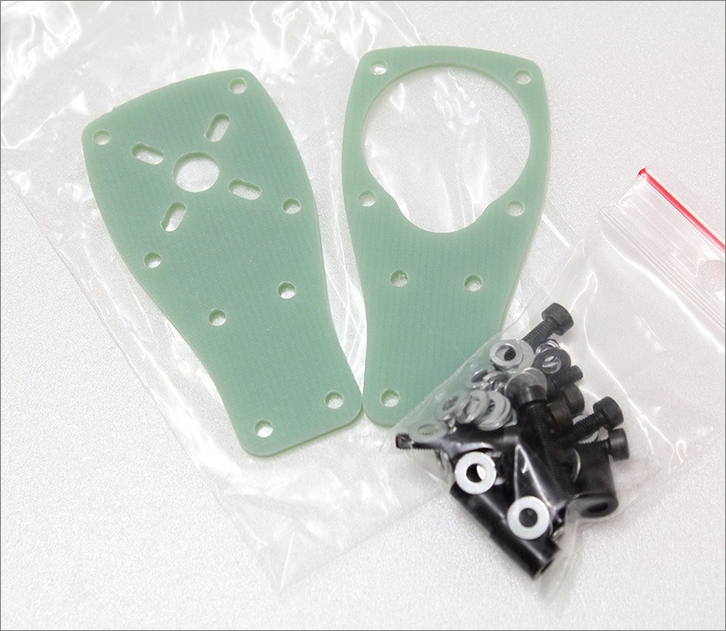

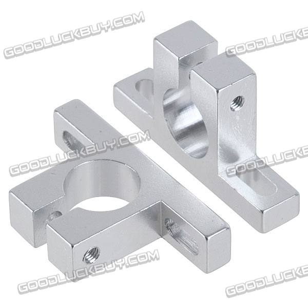

    HERE ARE THE OPTIONAL MATERIALS YOU CAN BUILD IT WITH! :banger: Attached files [​IMG] [​IMG] [​IMG] [​IMG] [​IMG] [​IMG] [​IMG] [​IMG] [​IMG]
