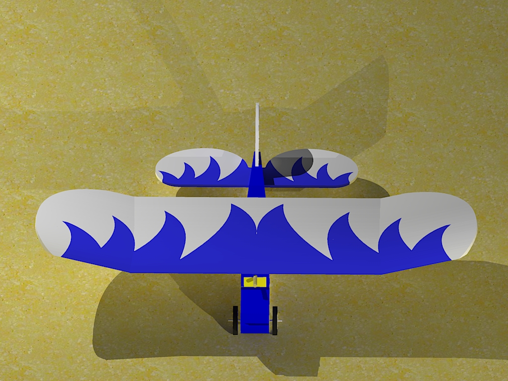

    I bought a bundle of the Green Guard FFF at Lowes and decided to try it out on a Lazy Bee that I've been working on in Sketchup.

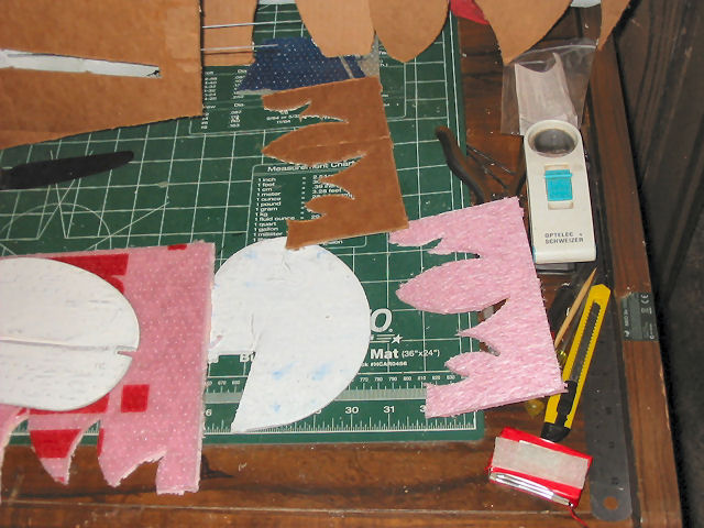

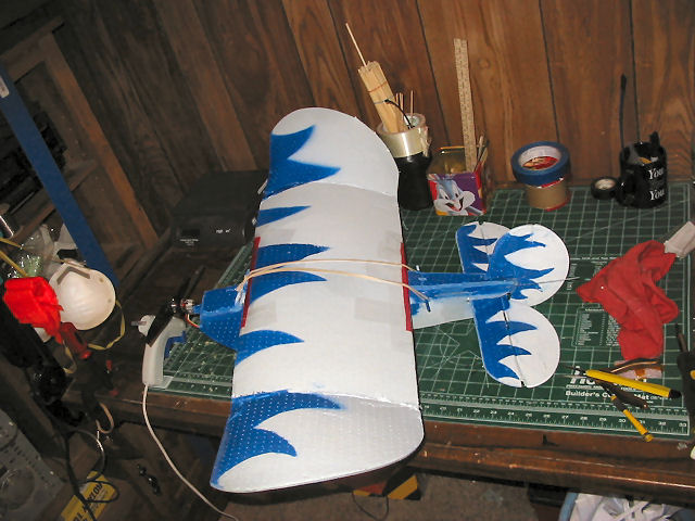

    This was designed in Sketchup along with the paint scheme I used and with the Phlatscript plug-in I output the designs to gcode which aloud me to cut all the parts out on my Phlatprinter.

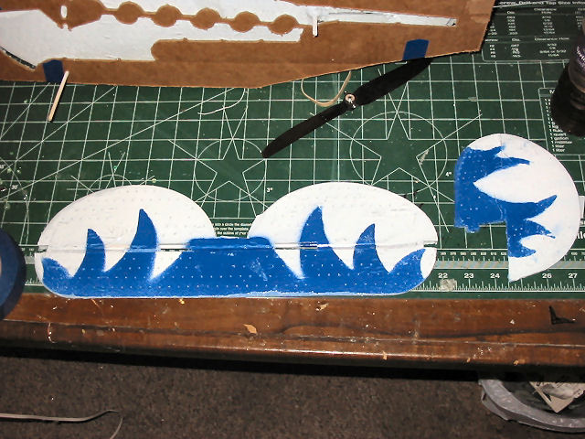

    The paint masks I used were also cut on my Phlatprinter. I cut them from an old cardboard box that I broke down until it was flat and some scrap pink foam I had lying around. Mind you, this was an experiment and learning experience for me. The masks came out great but my painting skills need some work. Next time I will secure the masks to the foam instead of just holding them up to the foam and spraying away. BTW, I uxod Krylon H20 spray can paints.

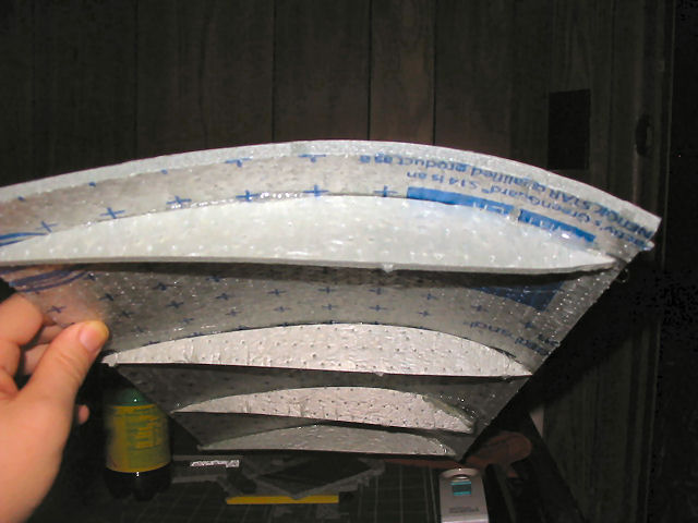

    The Foam
    It is comparable to the OC Pink but not as brittle. It is flatter than the Blue or the Pink. It cuts very well in my Phlatprinter and by hand. I doesn't take much heat so use a low temp glue gun or keep the tip of you gun from making contact with the foam. Hot glue bonds really well to it.
    It is fairly flexible but not as forgiving as the blue. It comes with one clear side (no printing) and on printed side. For my Phlatptinter I cut with the printed side down. I works for me. Dust from the cutter is not a problem

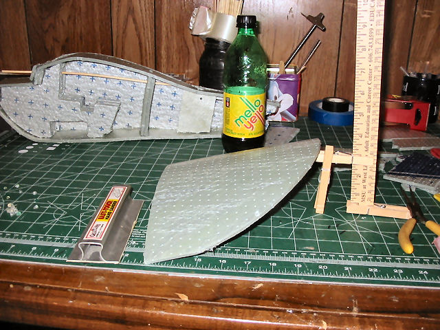

    If you need to make bends, the "counter top edge rub" works pretty good but if you are going for are tighter radius I suggest fold lines, also called score marks or bend lines. Either way put the printed side to the inside of the radius to keep the foam from snapping.
    One last thing I discovered about this foam, it sands easy but on the areas you sand and remove the skin (clear side), it will suck up paint like crazy causing discolorization between skinned areas and exposed areas. Maybe another shot of paint to the raw foam areas would remedy that but I haven't tried it.

    Wingspan is 36
    All the foam parts weighed in at 5.2 oz.
