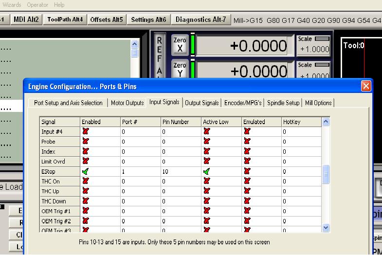

    I watched Mark's video from start to finish and have done everything. When i start Mach3 the reset button just flashes even after i click it and can never ref all home.
    Any ideas?
    My computer has like 4 different parallel port types i can run, i have it set to standard right now, running windows xp

    Oh, when i first start Mach3 it scrolls beside the status button " No Shuttle Detected of type selected"
  3. 3DMON
    Are you saying the reset button will not stop flashing even if you click on it?
    If so make sure your Estop is cofigured right. Attached files [​IMG]

    Dude!! you are Da man!!! Estop wasn't right. thanks so much
