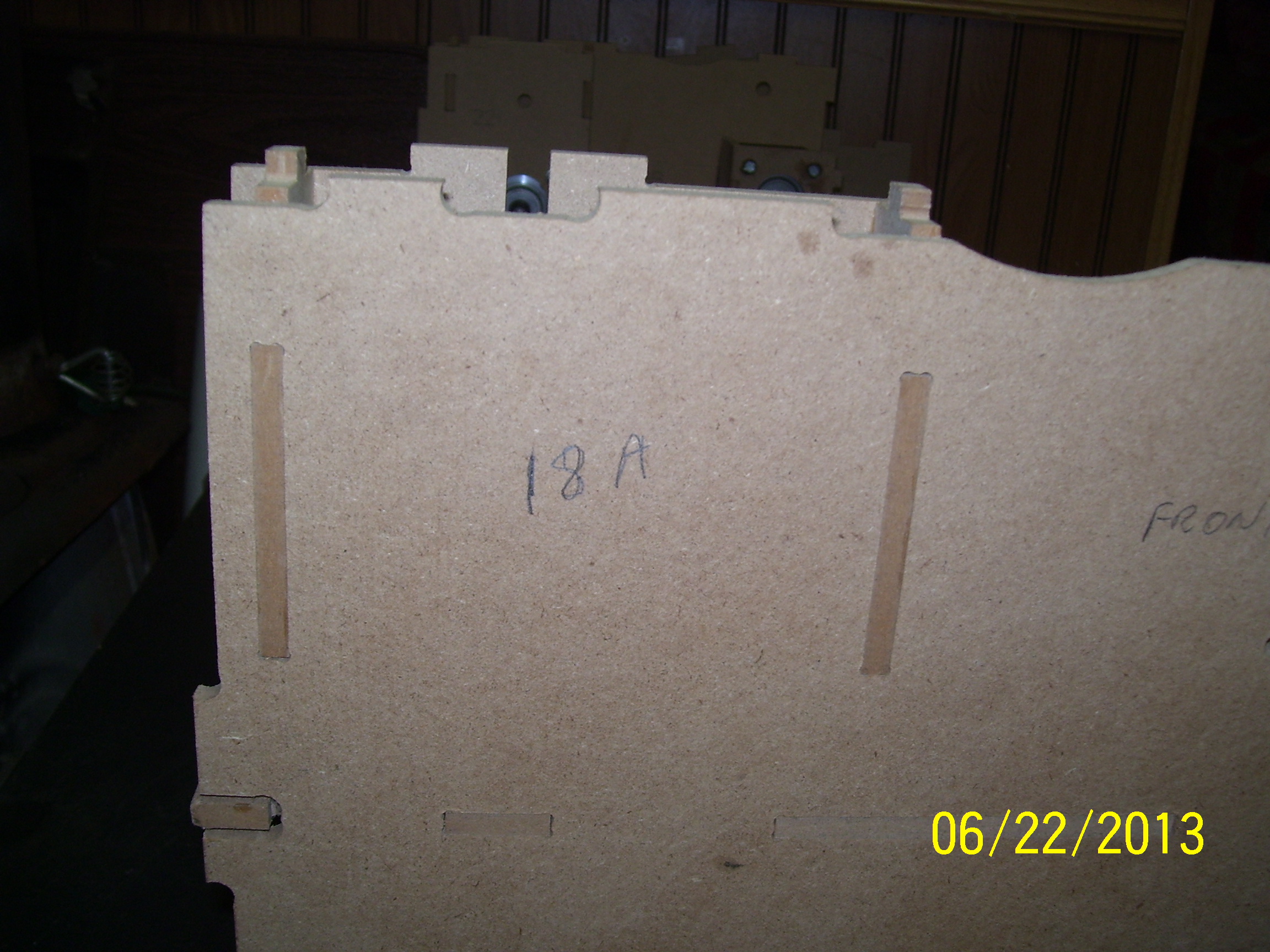

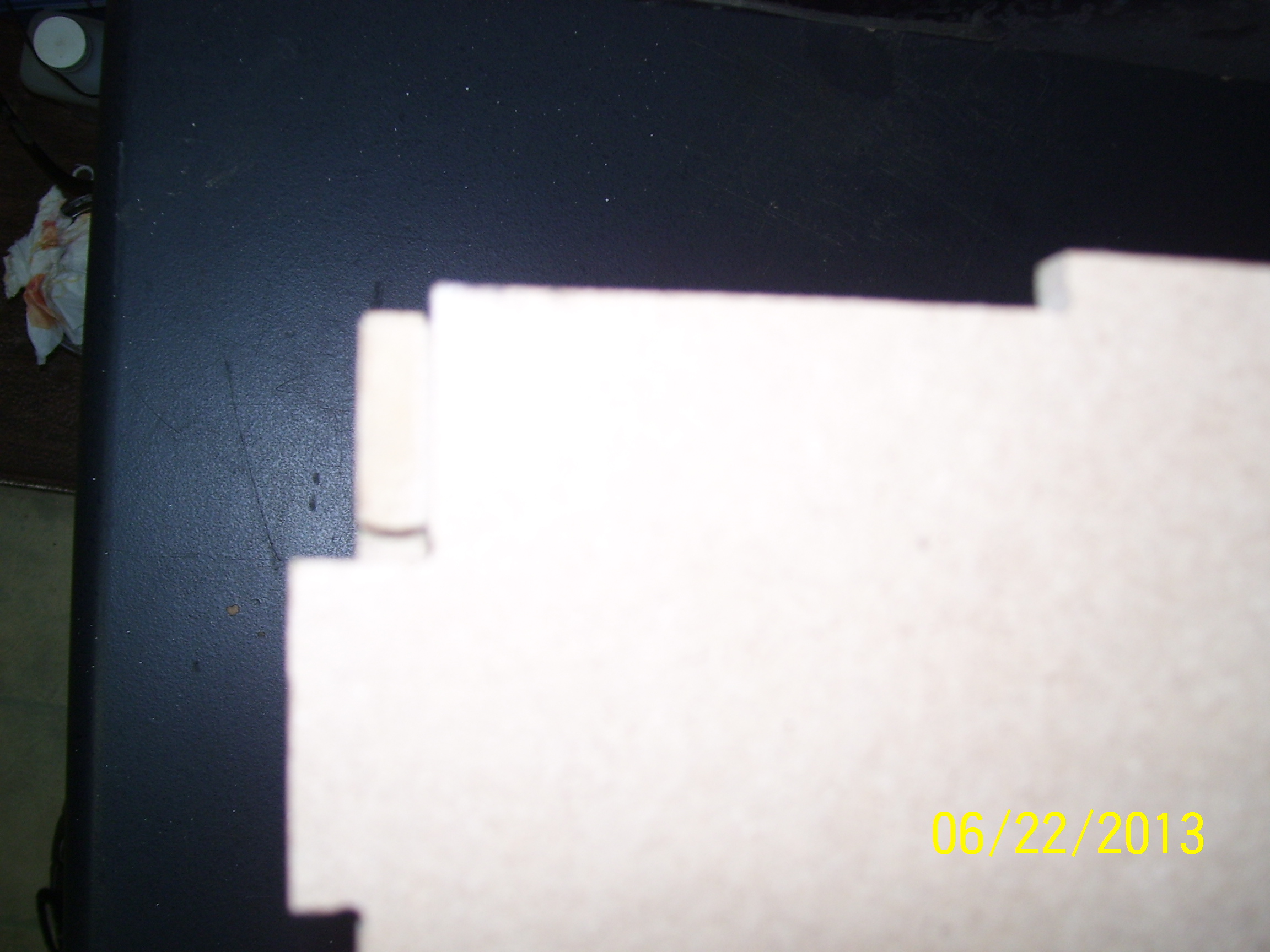

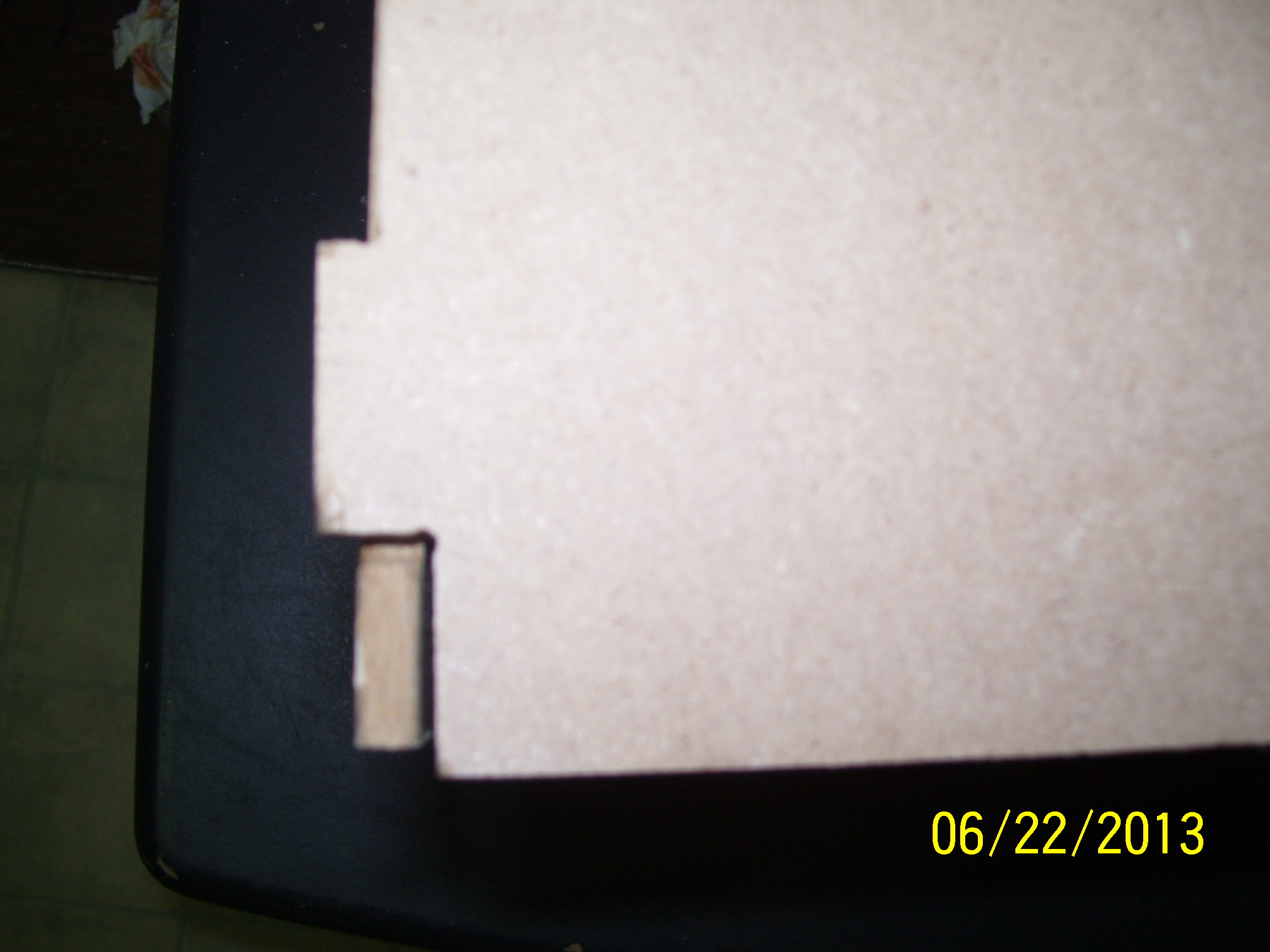

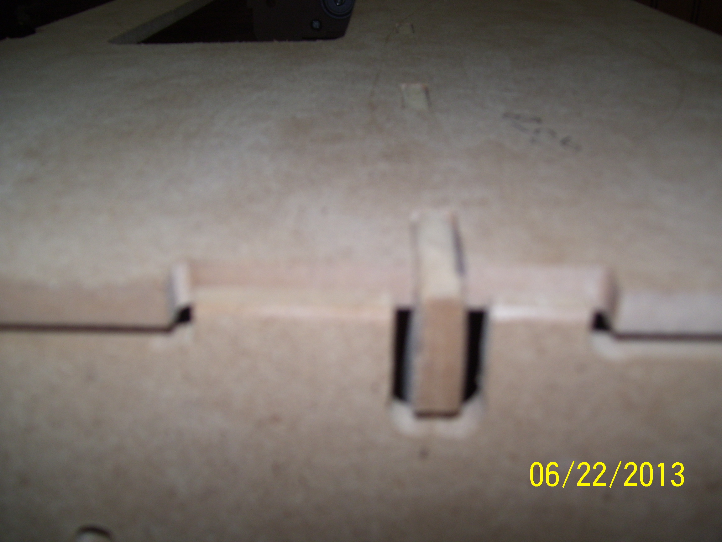

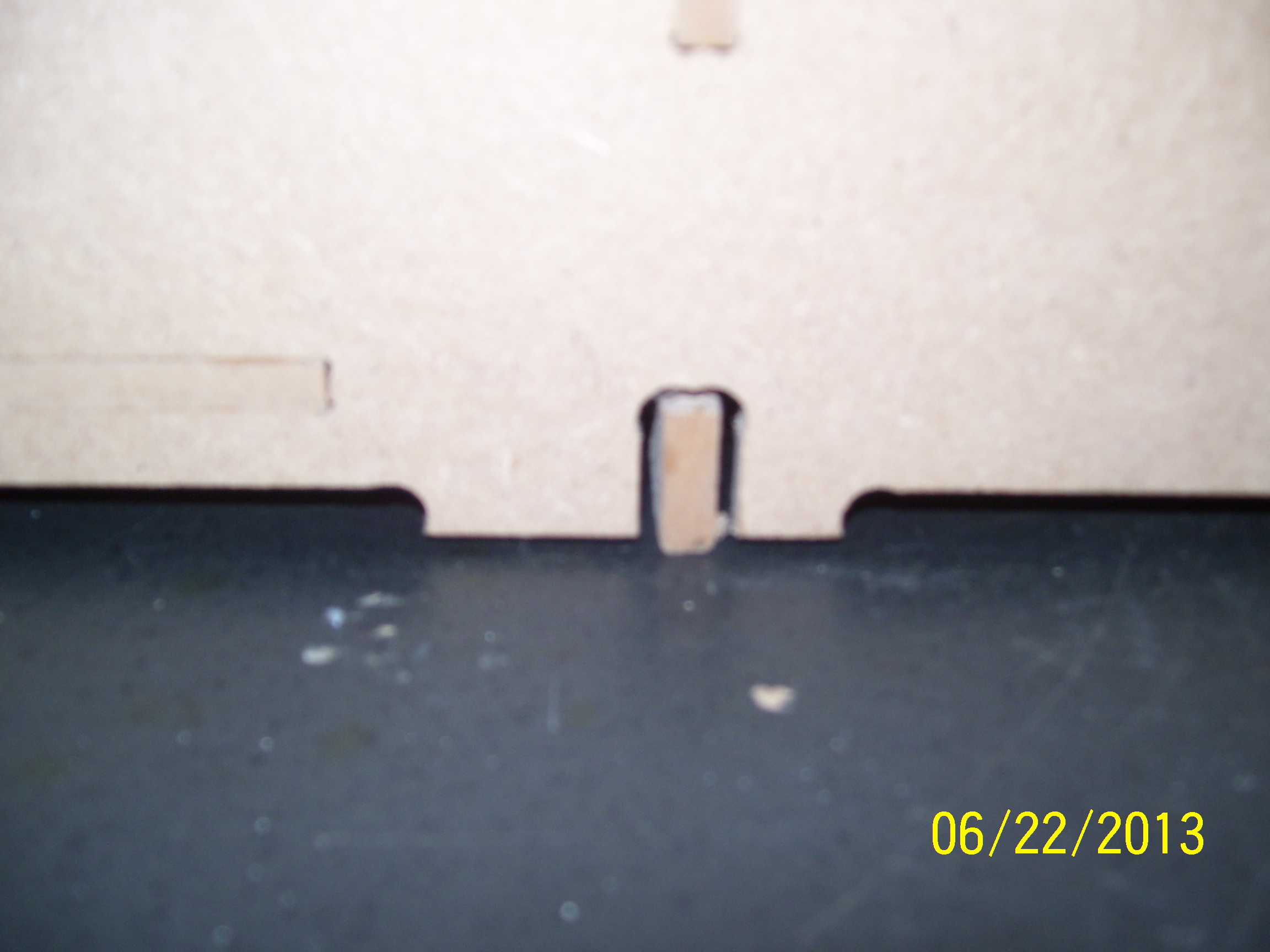

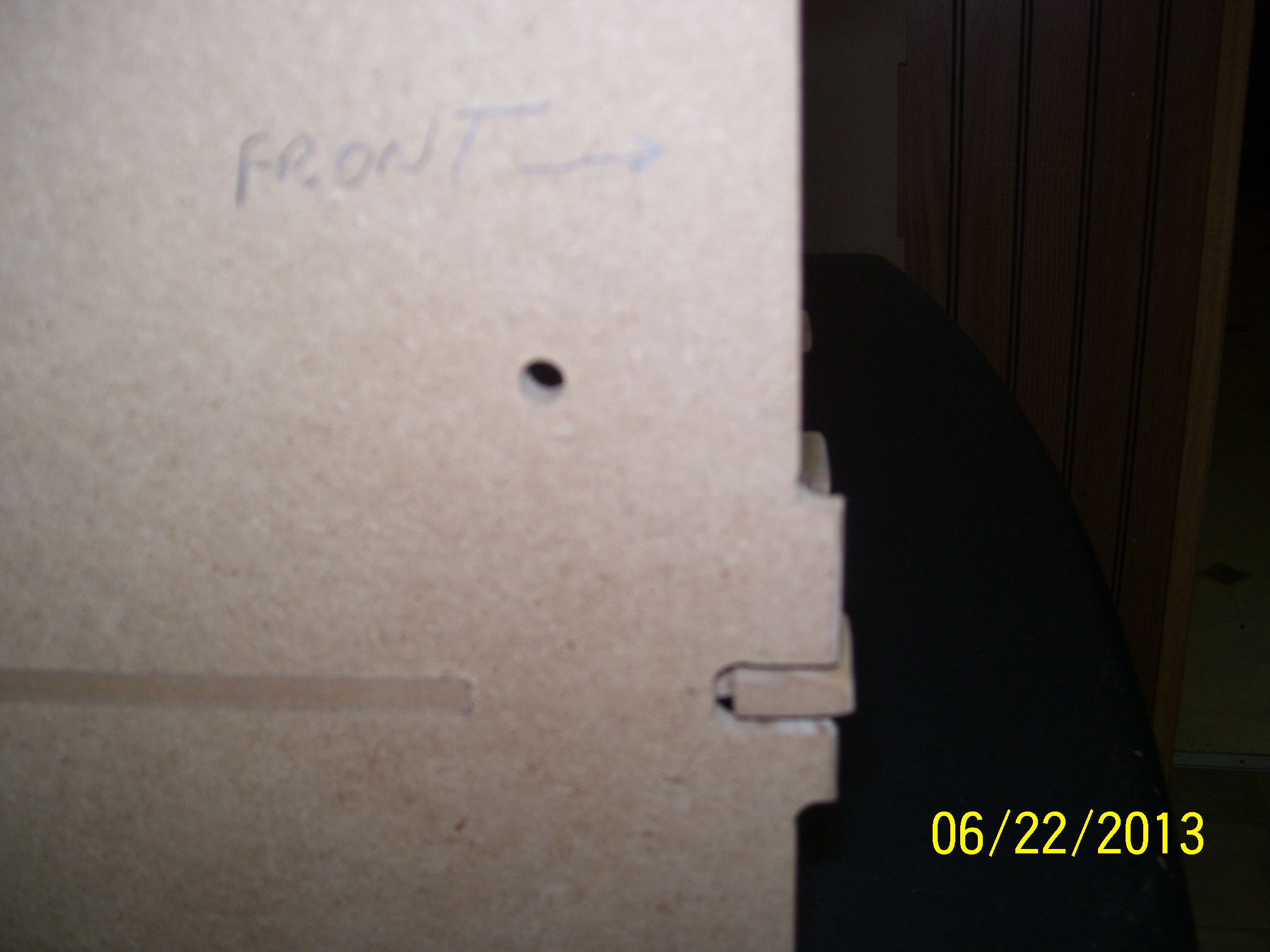

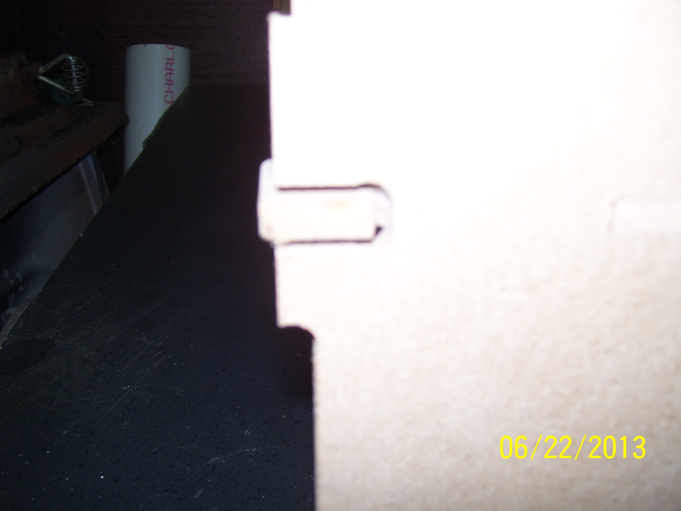

    Ihope this works.I have problems with the front part .It will not go into 18 A.(the left side).
    The right side (18 B ) fits good.I have no idea of why the front (25 B)will not match up.

  2. kram242
    I see the problem Gary.. Part 18A parameter was cut on the wrong side of the line (inside instead of outside)
    We will have to cut you a new one
  3. rescue911
    419
    Ok ,Thank you Mark.
    I have part 18A,Part 20,Part 20B,Part 21,glued to part 17.
    We will try to get those parts off so you do not have to recut everything
    on both sides.
  4. kram242
    NP Gary :)
    I just reworked the code for parts 18A,20,20B,21 so if you can get these part off of part 17 that would be best.
