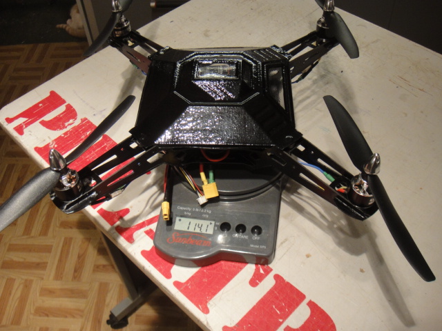

    I had a motor mount blow apart in mid air! So I went back to the drawing board and added arrow shafts from the local sports shop here. It should be said this was not my idea, I have seen it done and there is one that looks a lot like the one I am working on. They seem very strong and you can make the arm length any size you want. I can't wait to give it a try. Just looking for a strong basic platform for testing.
    Here is a quick picture of the latest version. When I get one that I think is worthy of sharing I will post the plans for it :doubleup:
