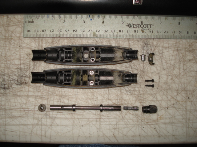

    Hey guys I had an old flex shaft laying around I used for measurements so I thought I would open it up so you could see whats inside :)
    Two screws and a retainer ring will get you inside.
    this is what you will see.
    Of course not a dirty as mine, I have been shooting WD-40 down the shaft of this one for a long time (not a good idea)
    Hope this helps someone

    I actually was trying to spray it to the bearings so I would spray it just to the side of the col let and down into the plastic housing. You are right about the WD-40 one of the worse outcomes is that once mixed with foam dust becomes a sticky paste that will gum up everything it touches. So I have stopped using it on anything to do with the Phlatprinter. I have switched to white lithium grease as well. I have not tried silicon yet but that sounds even better. I am thinking that the best would simply be the 3in1 oil you can find in the squeeze cans. I am trying to get away from anything that once combined with foam dust creates that paste.
