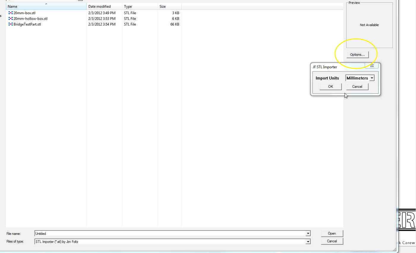

    Meshlab is very cool!Thanks for the tip. Im still having the same problem though.The object length in meshlab is 180mm which is correct after I import the .stl into sketchup its 5280mm. Any thooughts on what I may be doing wrong?
    I am able to import to scale with the Jim Foltz STL importer. Using the 20mm box as a quick test example.
    A couple things to check would be; beforeyou import check to make sure you are in mm in your Window>Model Info>Units menu
    Another is to check that the importer options are in mm as well. You can check this after you select import and then Jim Foltz STL importer from the File Type drop down list. Look to your right at this point for the Options button (easy to miss this) and make sure you have mm selected. Then do your import.
    The importer does not handle very complex items but maybe you could clean them up in MeshLAB and try to get a good clean import. I have not looked around latley but there maybe more updated importers out there for SketchUp that work better then this one.
    Hope this helps :)

    Thank you so much for your help. Jim folts stl importer was set to feet. Problem solved! Love this site :doubleup:
