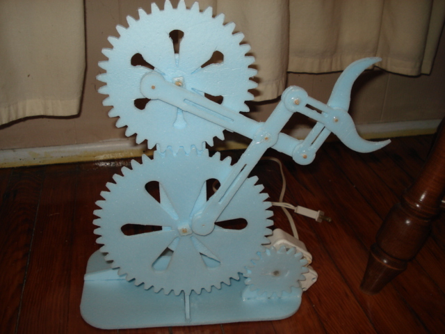

    This is a project I started when I saw a video with this machine in it.
    I thought hey I can make that. So I did and it works :D
    Right now I am using a motor from one of those Christmas deer that move their heads up and down, but I think it would be nice to have it move a little faster with a different motor, so that you can see the claw action better.
    I used hot-glue and bamboo for the axles just blobbed a little glue on the ends to keep the parts in place.

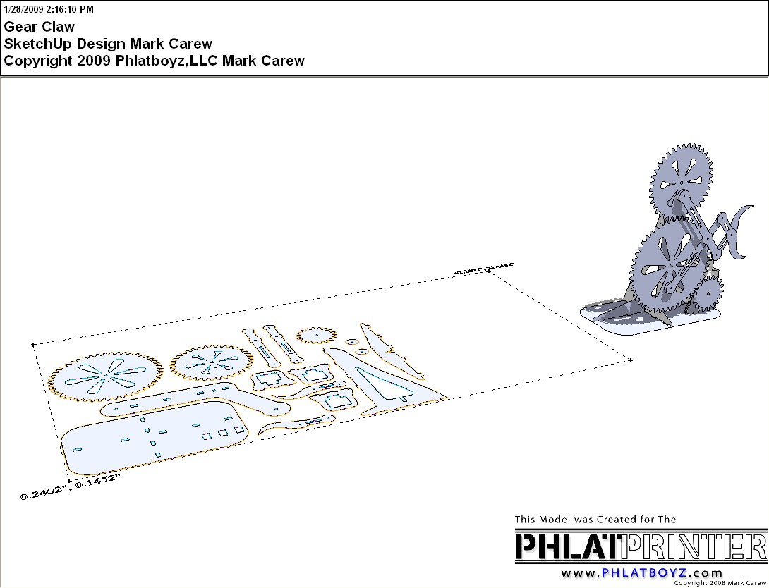

    I cut this out using a 1/16" end mill and that is what the code is setup of course you could scale it up and cut it with 1/8th bit as well.
    Here is the file
    Enjoy
    EDIT Here is the SketchUp plugin I used to make the gears Attached files [​IMG] GearClaw.wmv (2.9 MB)Â GearClaw.zip (528.8 KB)Â [​IMG] gear3.rb (7.7 KB)Â
