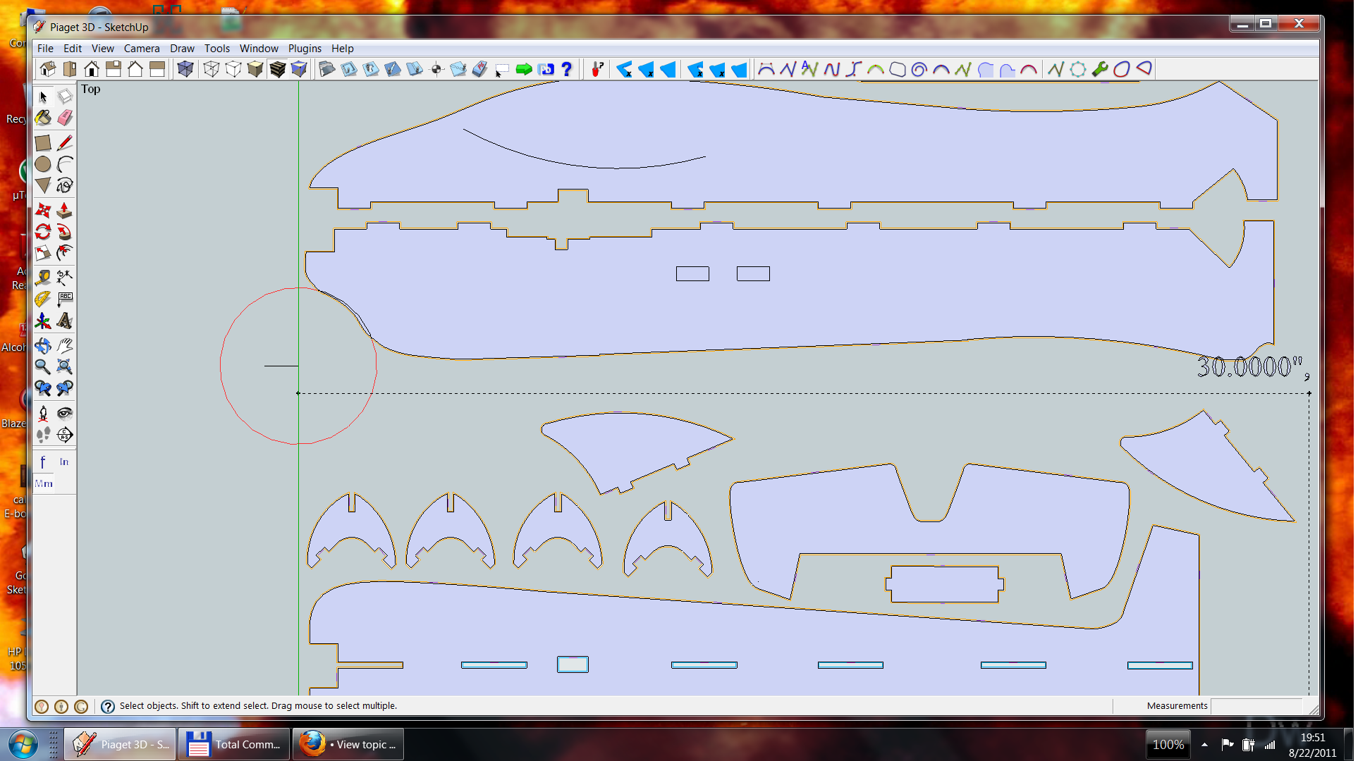

  11. TigerPilot
    1,576
    You must be joking, John!!! Man, I never did anything but move the safe cutting around. What I do is once I have the initial safe cutting area set I put a small line above it, like you see in the red circle. Now when I want to set the safe area I have a point where I can snap to. I than set my things to be cut as I want them and as close to the safe edge as I want them and every time I set the safe area it will be exactly the same. You don't have to do it above only, you can do it on the left or the right too. Attached files [​IMG]
  12. ToxicToast
    483
    Roseville, CA
    Yoram, I do the same thing, except I use a locked small square to snap the origin to.
    John, don't feel bad! I've had moments exactly like that before. I can think of a few times I was doing the same thing for years when it could been easier another way. DOH!

    You guys are awesome!! I will start doing this from now on, I will set my pieces per sheet and make a mark in the corner for alignment, how easy is that when you need to re generate the code DUH LOL :D Thanks Chris and Yoram!
    John
  14. xtremeRCpilot
    xtremeRCpilot Member
    736
    Cleveland, Ohio
    I guess I thought that the xyz axis was set to a specific point in SKP and it couldnt be moved !
    Wow after all this time :p
