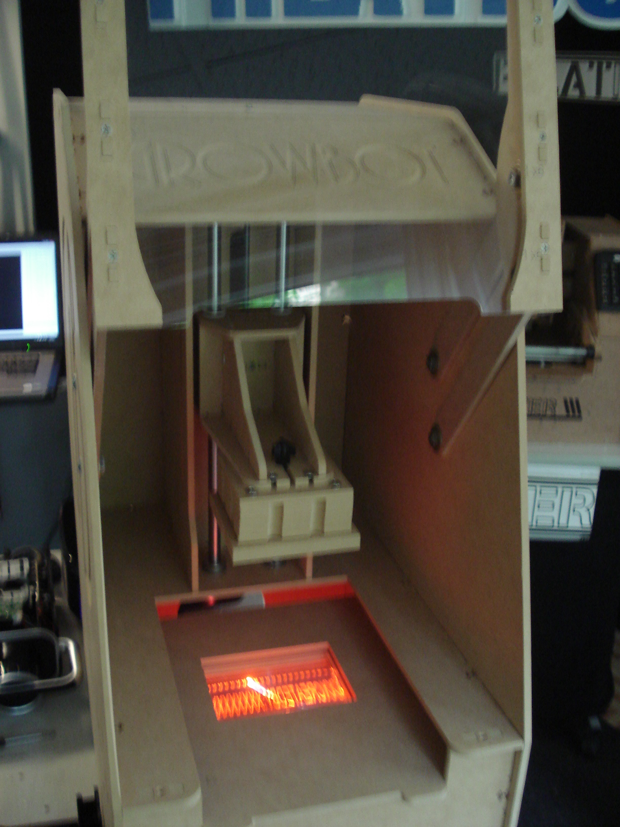

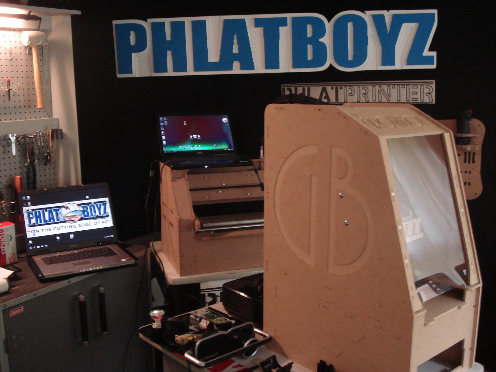

    We introduce the 3DGrowBot which is going to be the newest machine in the Phlat Family. We are bringing manufacturing back to America one affordable machine at a time! We go through the history of 3D printing and share some of the research we have been doing. You can watch our progress every Wednesday night at 8:00 pm EST right here in the Phlatlab. www.phlatforum.com Thanks for hanging out! Mark and Trish Carew

    I watched the show, Mark, but didn't get how it works. I understand you have a LCD projector that project what? What your monitor is showing? If so, how does that gets translated into the laser or uv beam (that is what is being used to harden the resin, right?)?

    Yoram, imagine a bowling pin in SU and SU would slice that bowling pin from bottom to top in very thin slices. Each one of those slices woud get projected, one at a time, into the resin, one slice on top of the previous slice, allowing enough time between projections for the previous slice to harden. This would continue until the top slice is reached and your model is complete.
