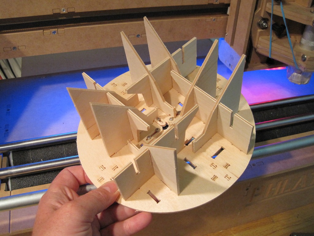

    I'm building the IBCrazy antennas now in the 5.8G flavor. I don't recall the exact name but they need a jig of 120° and 90° so I cranked one out. It's crude but scalable and should save a bunch of time.
    Edit: I added the inner supports but didn't change the posted pic. If you can't figure it out your not trying :think: . I only glued the four sides together and I just slip in the inner, top and bottom so everything comes apart easy.
    Bit is 1/16' and material is 1/4' I used Depron and it works well. I should make more small stuff will it Attached files [​IMG] [​IMG] antennaJig.cnc (14.1 KB)Â antennaJig.skp (922 KB)Â

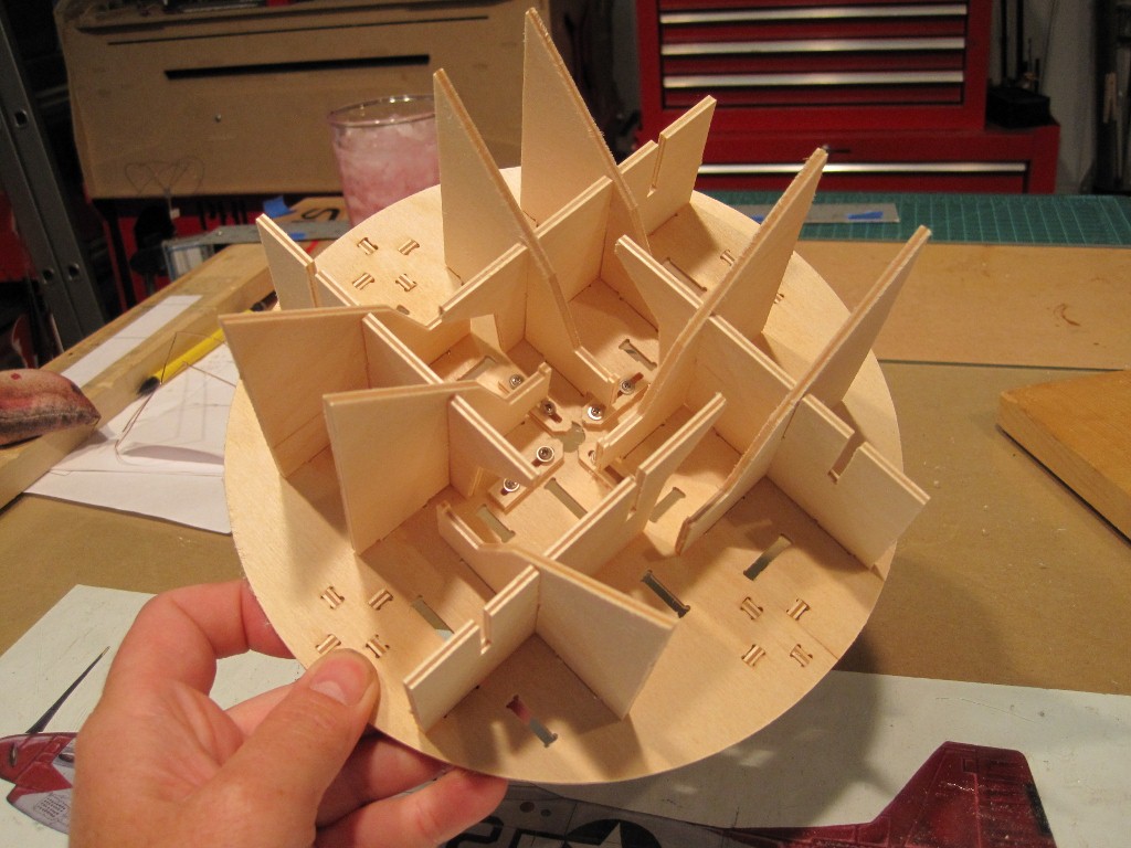

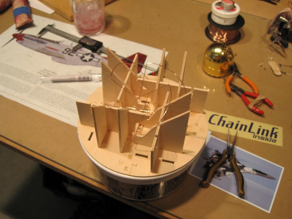

    Hey guys, just wanted to say thanks to Shaun for the opportunity to build his Skew-Planar antenna jig. I hand made a very nice RHCP SPW antenna before and it was all blood sweat and tears trying to get it to solder together. Using his jig, it became took just a half hour to assemble a new one (1280mhz). My initial tests are showing an excellent quality video signal with this antenna (and a RHCP clover). Love these antennas but they are a huge pain to make unless you are an 6 armed alien who runs the diner on Coruscant. The jig took away a lot of the pain.
    Great work on this design, 3dMon! Love the mechanism to hold the wire in place. One question - are the sliders meant to be mounted bottom-up? I ended up modifying 4 of the supports so the sliders can be used from the top-down. It didn't occur to me at the time that it was meant to be bottom-up! Doh!
    Thanks again!
    Nice work! Yeah I did mine from the bottom up lol.
