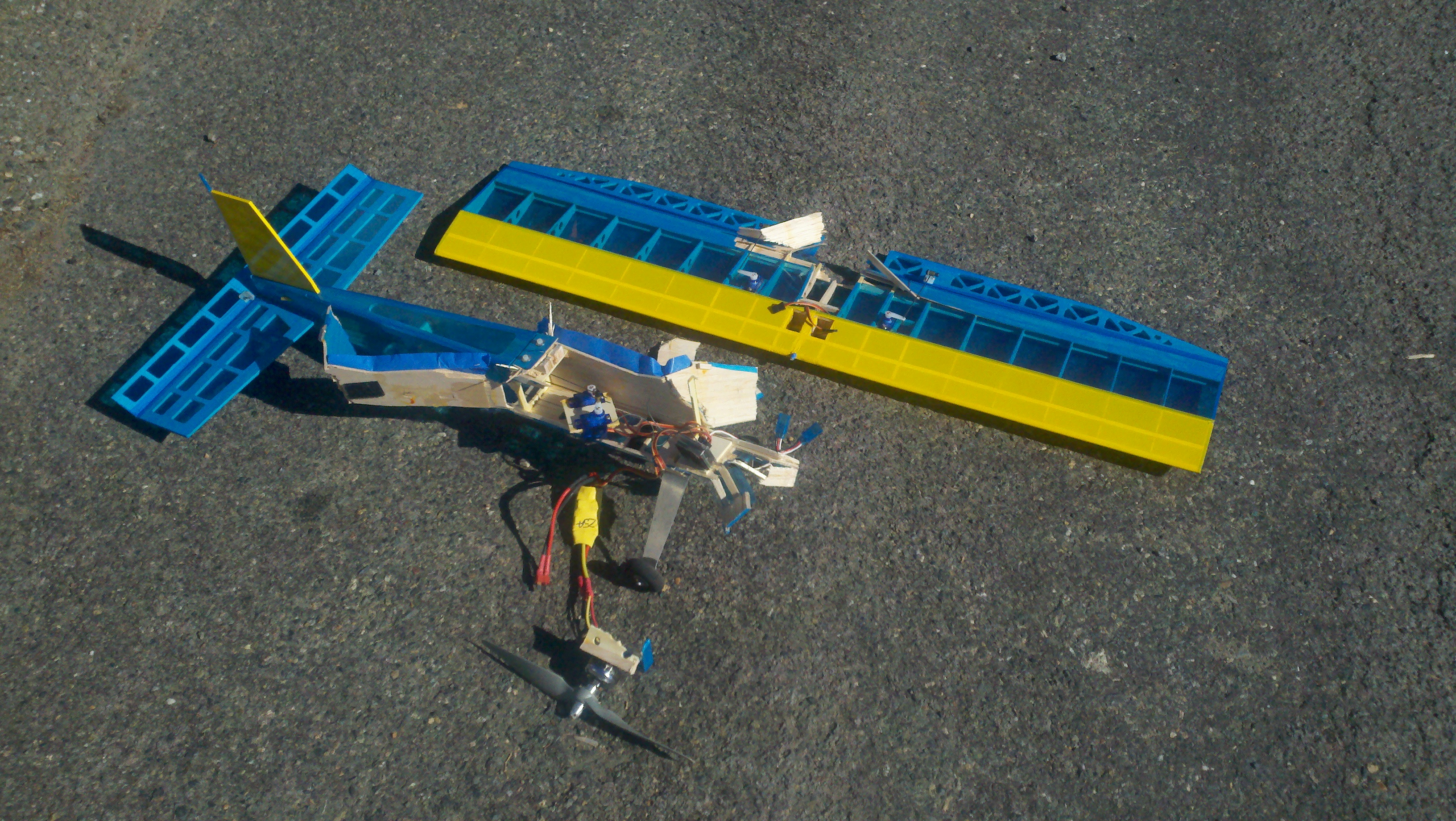

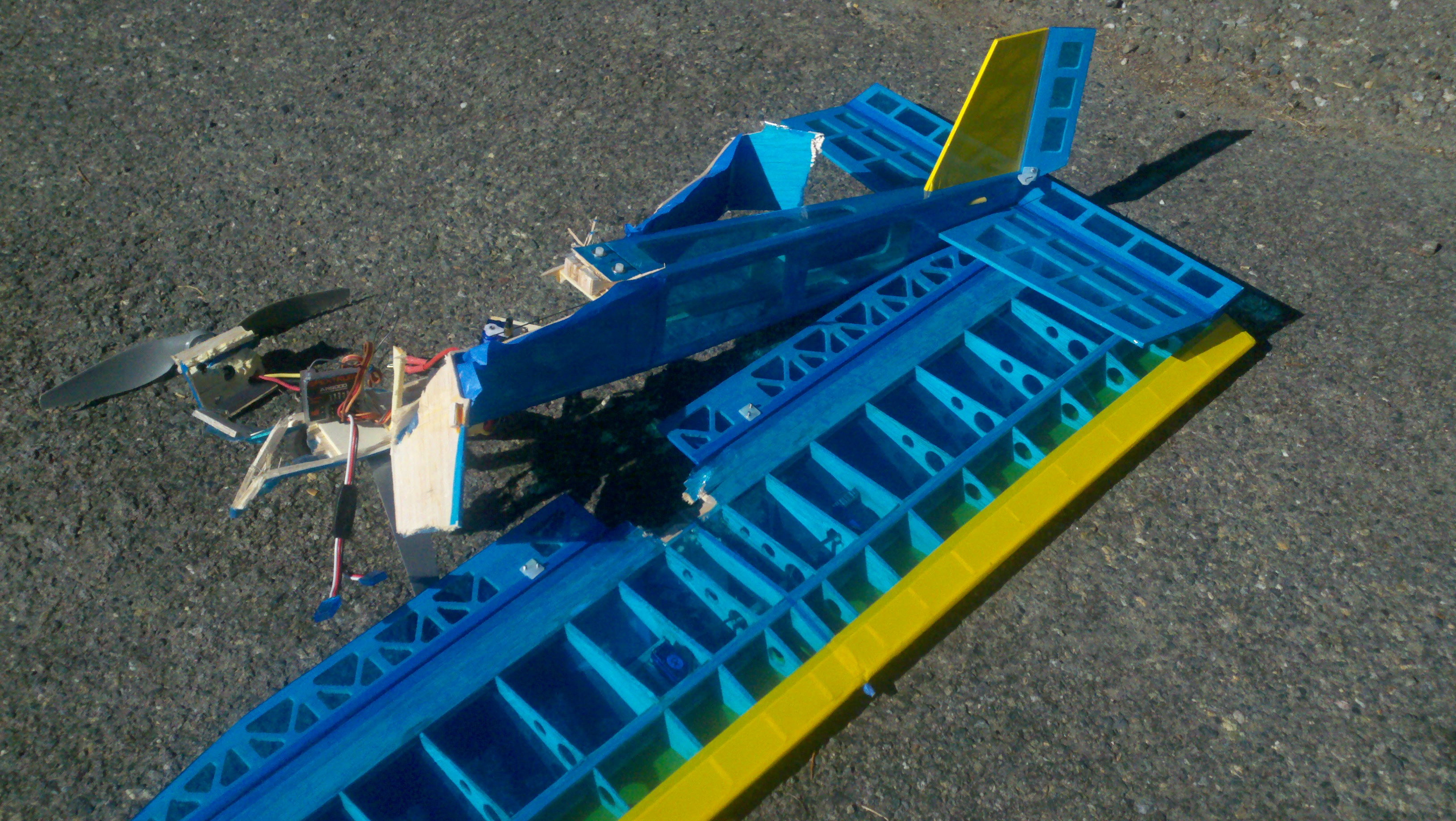

    15 flights on my eQSC and it has been a joy. Now, its only carnage!
    Wing departure on the upline of a loop at 3/4 throttle, turning the fuse and tail into a ballistic projectile. Wing ripped out of the forward retaining pin former. I can see in hindsight that probably 2 pieces of 1/4" triangle stock would have probably retained the upper piece of balsa and keep it from ripping off the fuse.
    Surprisingly, all electronics including the battery seemed to be very much intact!
    THIS is why we love hobby level CNC!
