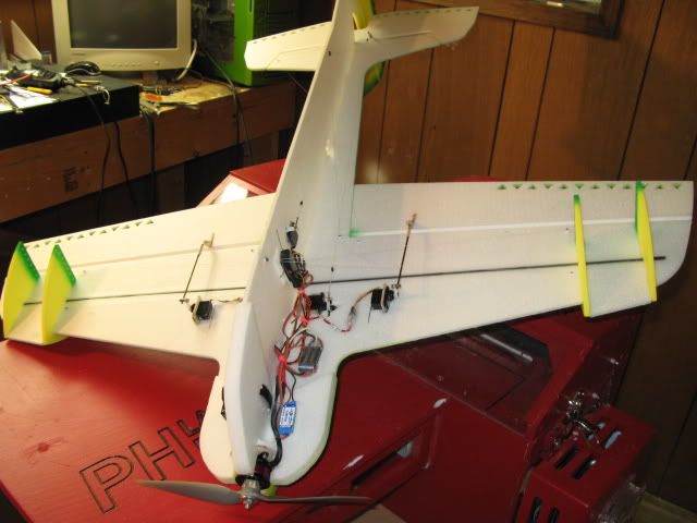

    thanks eric....ok the thunderstorms are not going to stop today...i wanted to get outdoor photos, but oh well.. when i weighed before i didnt have all the velcro mount tape on, a lil glue here and ther....the final weight is @220z. on the mark...i will get video of the maiden, the plane should be a ball. randy.

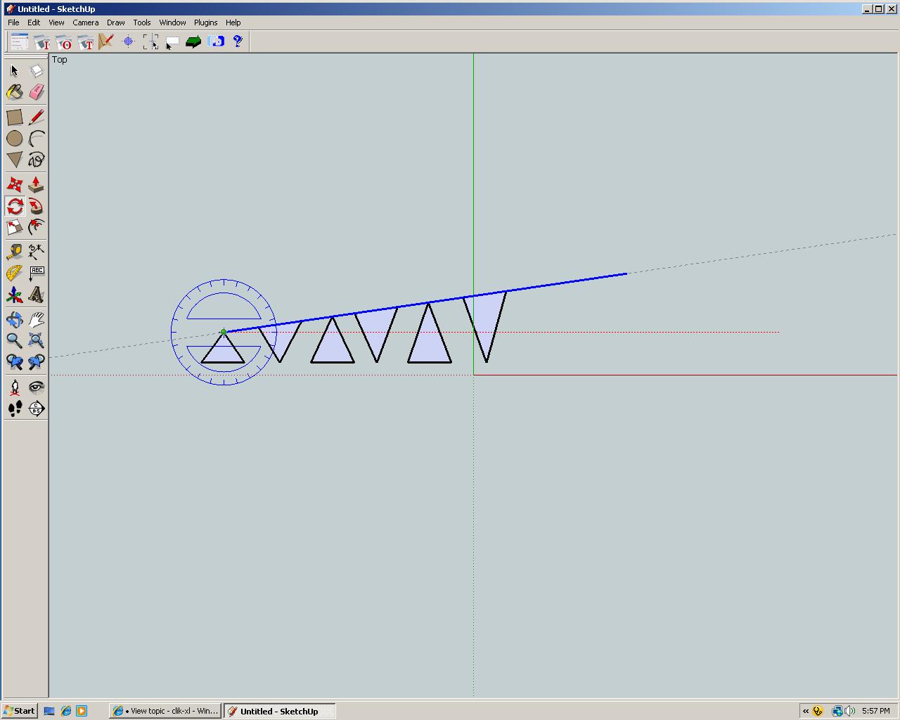

    Randy, how did you do the little triangle thing. I tried and couldn't find a way to do it except doing it one by one. I though there might be a way to multiply it between two constrained lines but I didn't find the way, if there is one.
    P.S. I'm talking about the two support strips.

    TigerPilot, i drew a series of triangles the length i wanted.... i drew like 3 of em then copy and paste a few times. then i drew a line along top of them. after that i selected that top line only, and did a rotate move from one end, that's what distorted the patters, and got the taper i wanted. then go in between the triangles and erase. hope this makes sense to you. randy.

    Flashsolutions, I knew that one. What I want to know is how do you make it if the two lines are no parallel. It will have to grow or shrink as you copy it. Look at the side strip in the photo on the first page.
    BTW, you don't necessarily have to group them in order to multiply them. As long as they are selected together they will move or copy together.

  8. TigerPilot
    1,578
    Randy, nice trick. It worked for me too. Good one.
