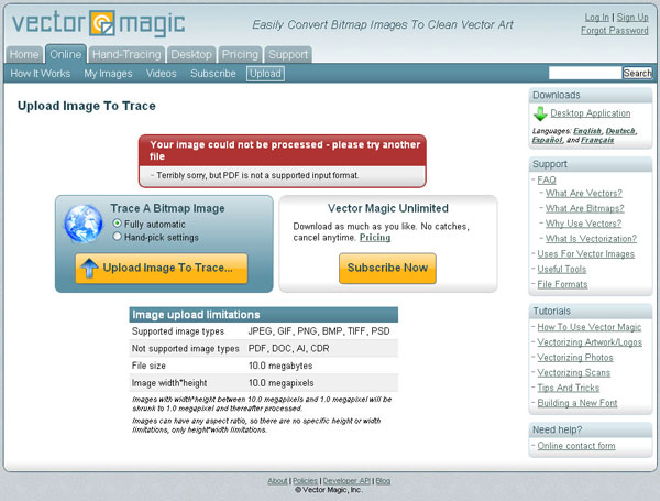

    Probably needs a little more investigation on my part but I don't think .pdf files can be imported into Vector Magic. The online trial failed when I tried to upload a .pdf even though the site says .pdf is supported - strange.
    But for what it does do, Vector Magic is excellent.
