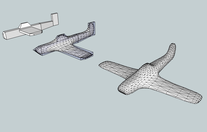

    I'm not very good with it, but the Subdivide and Smooth plugin is pretty good at making organic shapes. I created the simple model on the left, and SDS plugin did the rest.
    Attached files [​IMG] fuse.skp (168.9 KB)Â

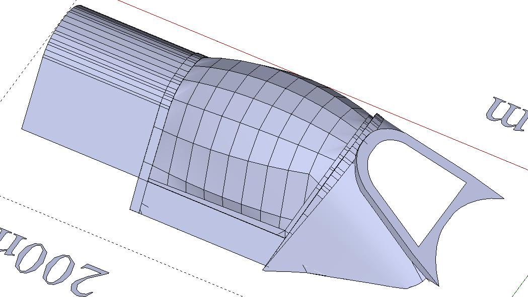

    Well after a couple of days work and I finally have a finished product... I intend to use this on a 1.2 meter wingspan Spitfire. I’m going to make a plug from the MK when I get it then make the canopy in the Phlatformer I just finished..
    Thanks again Mark for the help,
    I’m posting the SU8 file and my CNC file if anyone wanted to have a go at cutting it out or making the CNC file a bit better...
    Matt
    Attached files Final Canopy.cnc (330 KB)Â Final Canopy.skp (476.6 KB)Â [​IMG]
