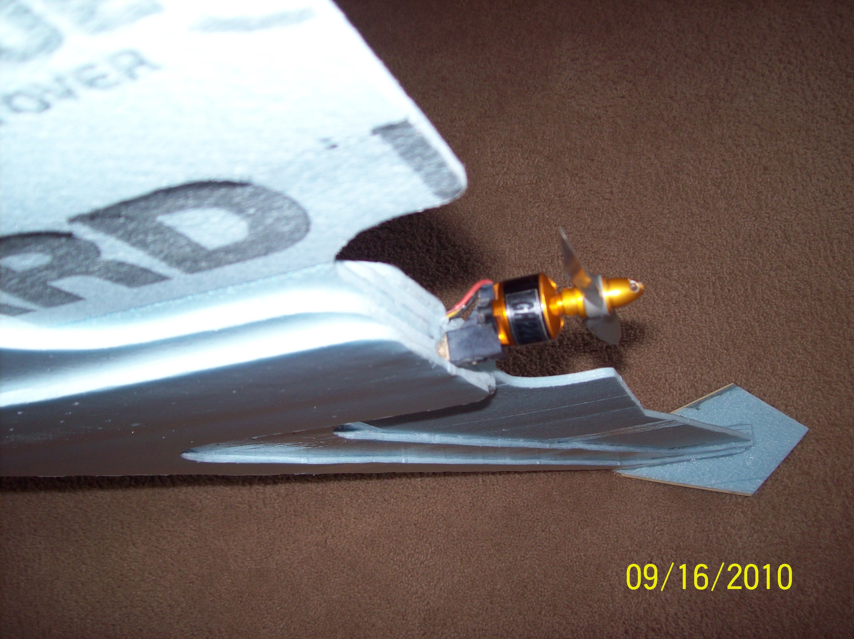

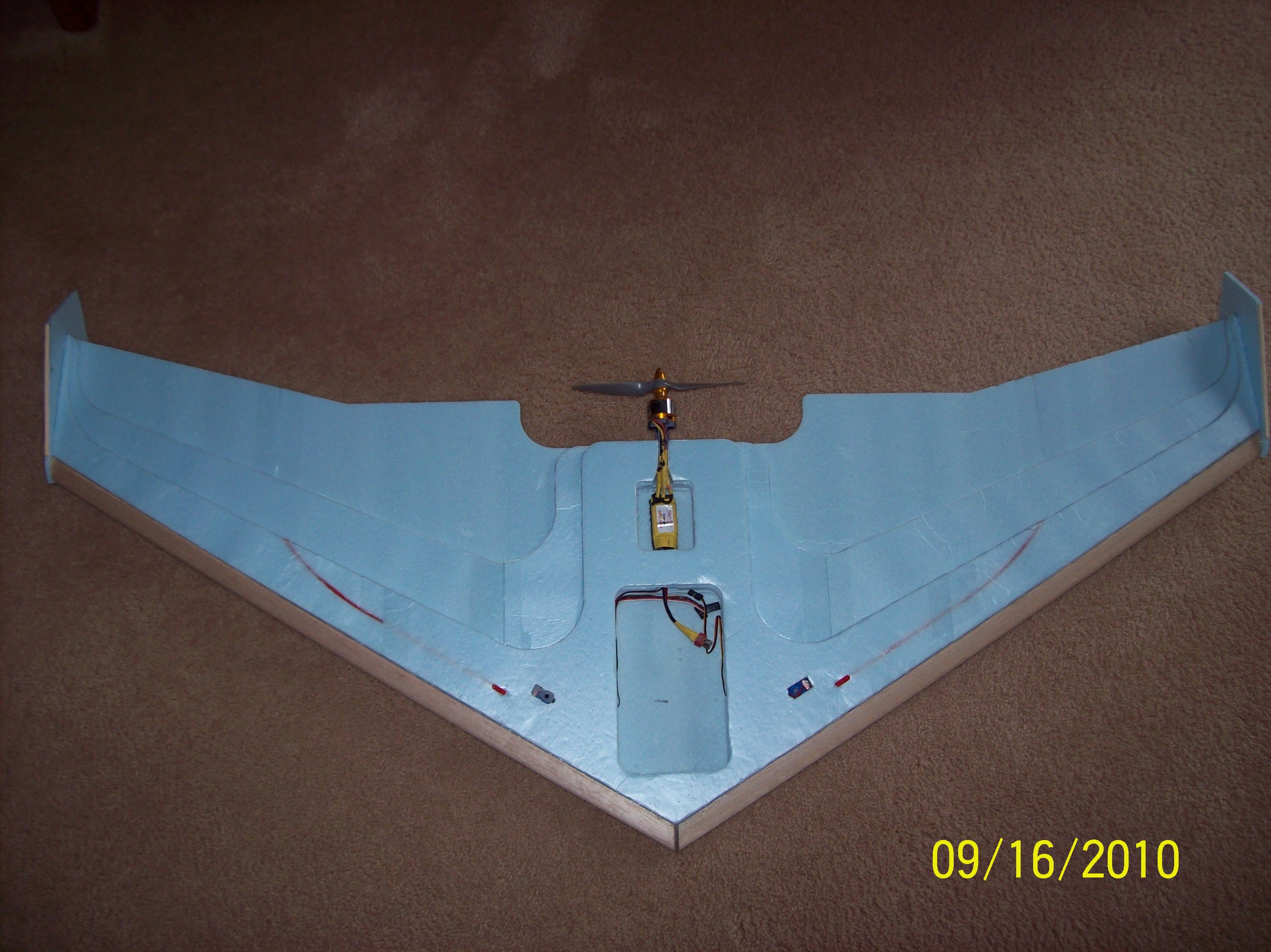

    The Divinity II is progressing well... Got the leading edges fit and glued on. The build plan did not call for them but I thought they would add more strength to the wing and keep the flutter down. The motor is mounted and the wiring is run for the ESC and the servos. Wing tips are on, I recessed some bamboo skewers into the edges of them for strength. Next will be the elevons and rigging them... Mudman1959 Attached files [​IMG] [​IMG] [​IMG]

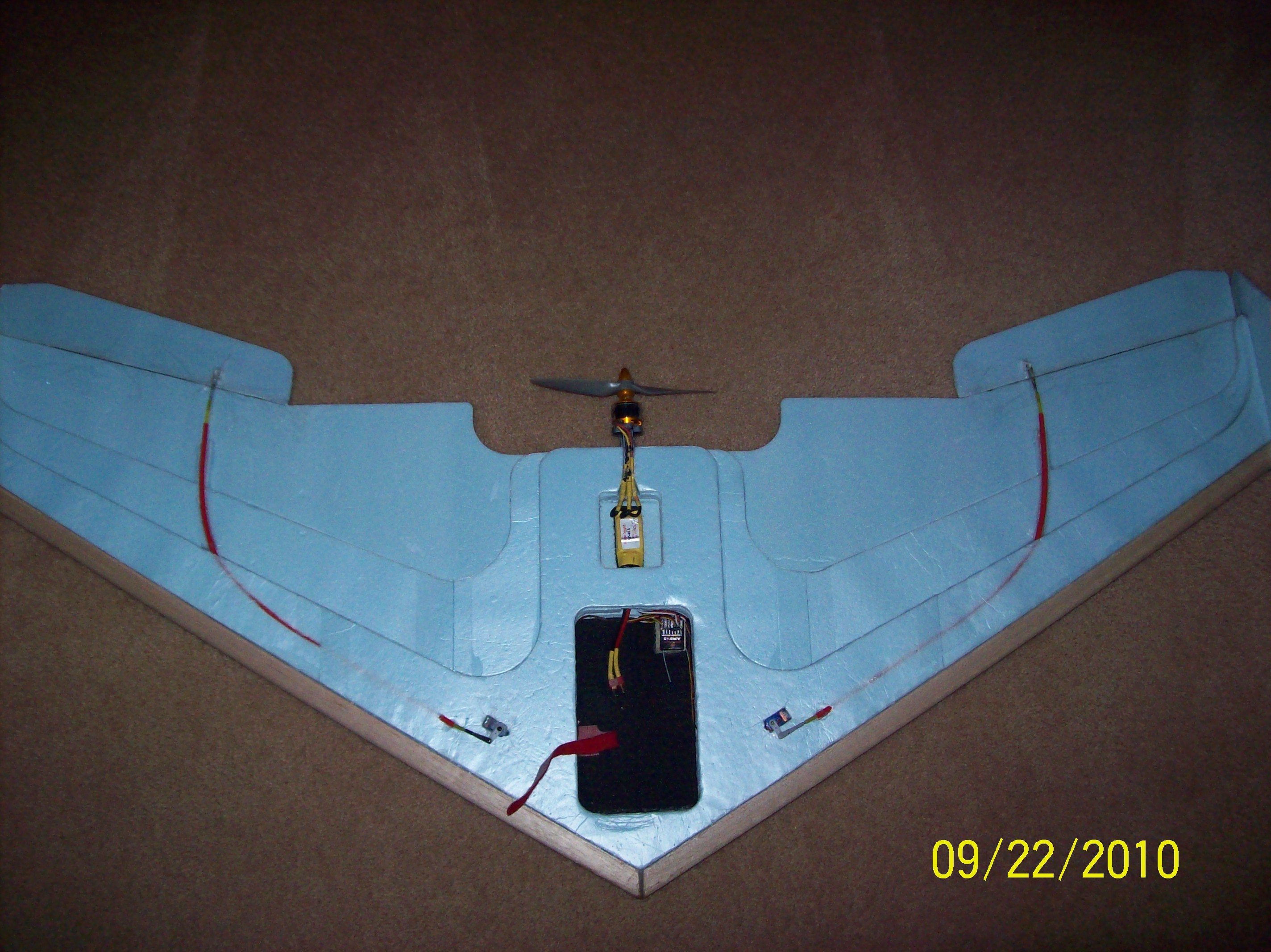

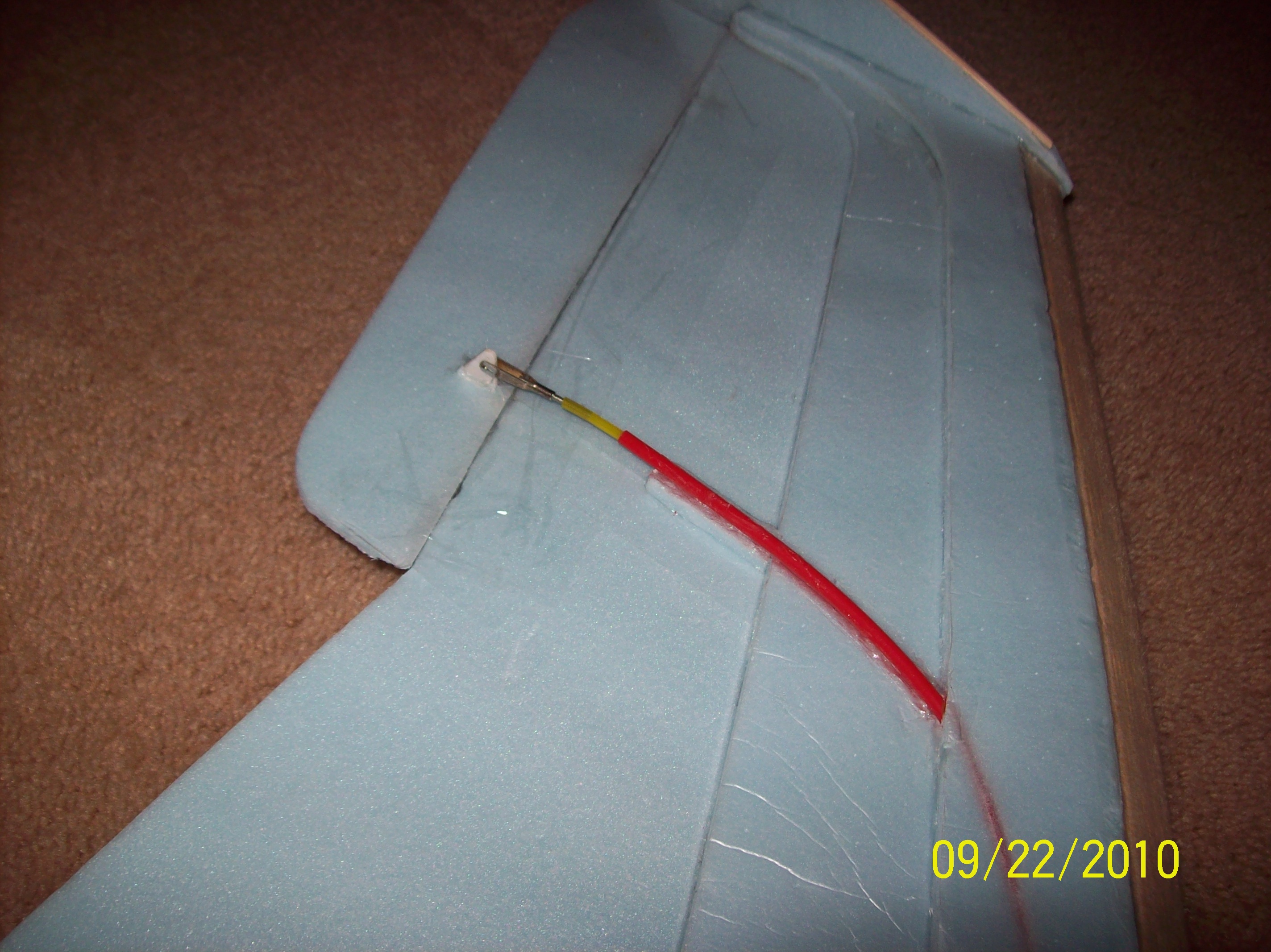

    It Flies! Got the Elevons done today and did a few glide tests and it looked real good. First flight was a short one as the CG was to far aft and all it wanted to do was climb. Readjusted the battery further forward and decided that it was going up... and so it did. I now have four flights on it and I am pleased with the results so far. I am going to add a little ballast to the nose and fly it again to see if it helps the handling a bit. It wants to pitch up a bit under power and it is very pitch sensitive. I am also going to change the servos to bigger ones than the HS-55 I have in it now. I will post some videos of it on here soon when I can get my Gum Stick DVR charged up. I will also post more pics of the Elevons... Mudman1959 :D Attached files [​IMG] [​IMG] [​IMG] [​IMG]

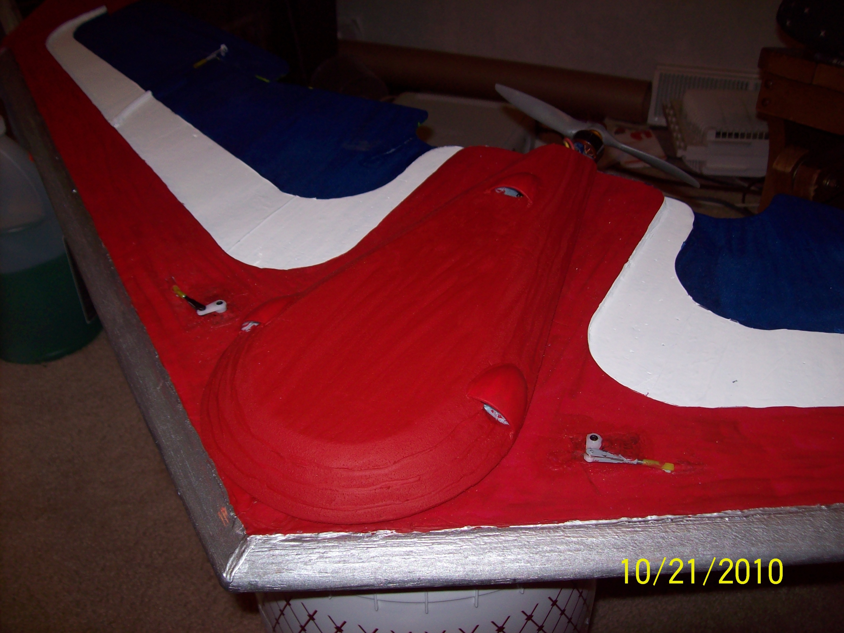

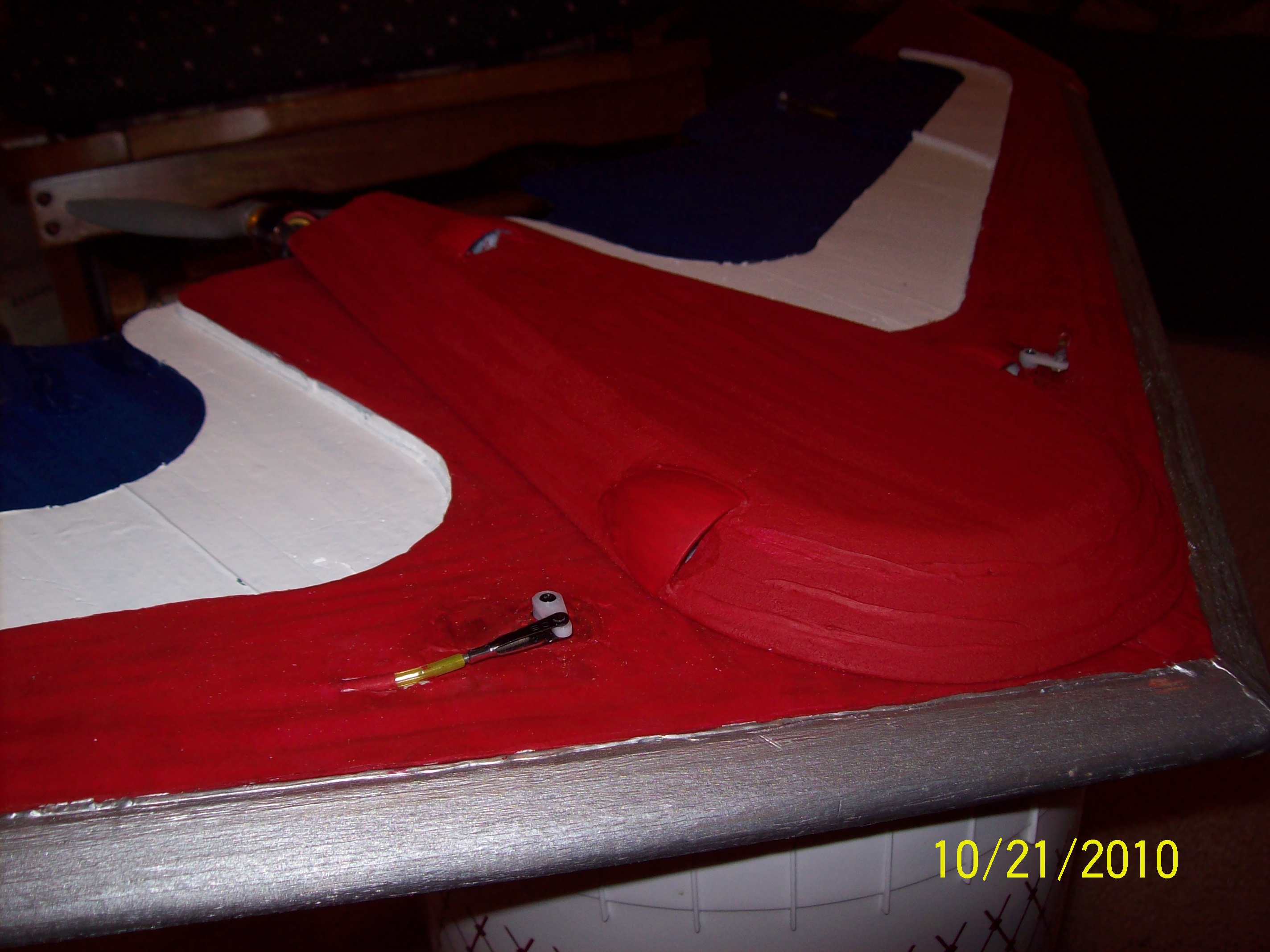

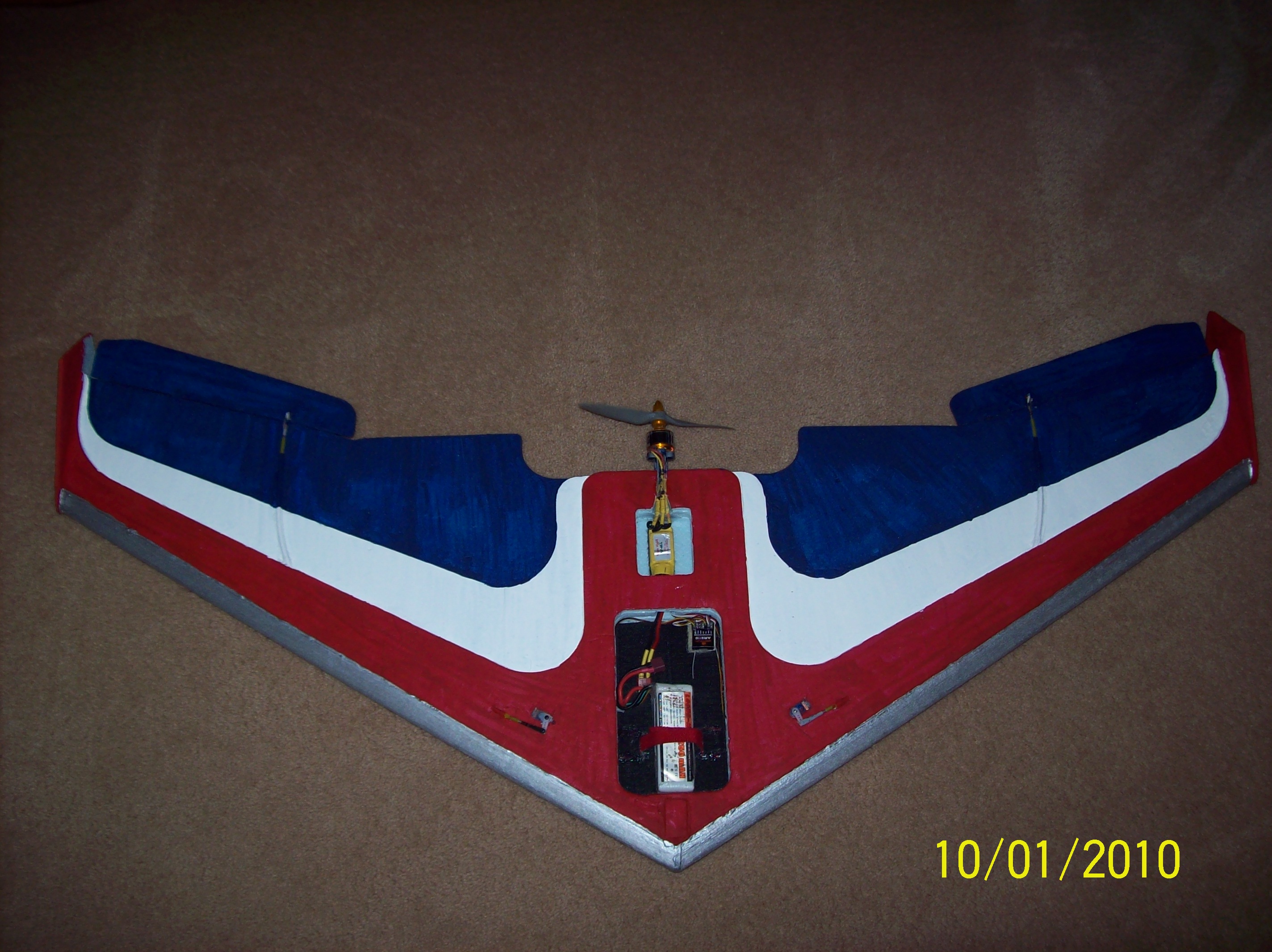

    Well it is finally starting to look better... The Divinity is now taking on a Patriotic look. I will be putting a cockpit/cover on it here shortly and it will be red with white stars down the top. Should look like a B2 wing when I get it done... sort of. Looking for some latex blaze orange paint for the bottom for better high altitude visibility. Mudman1959

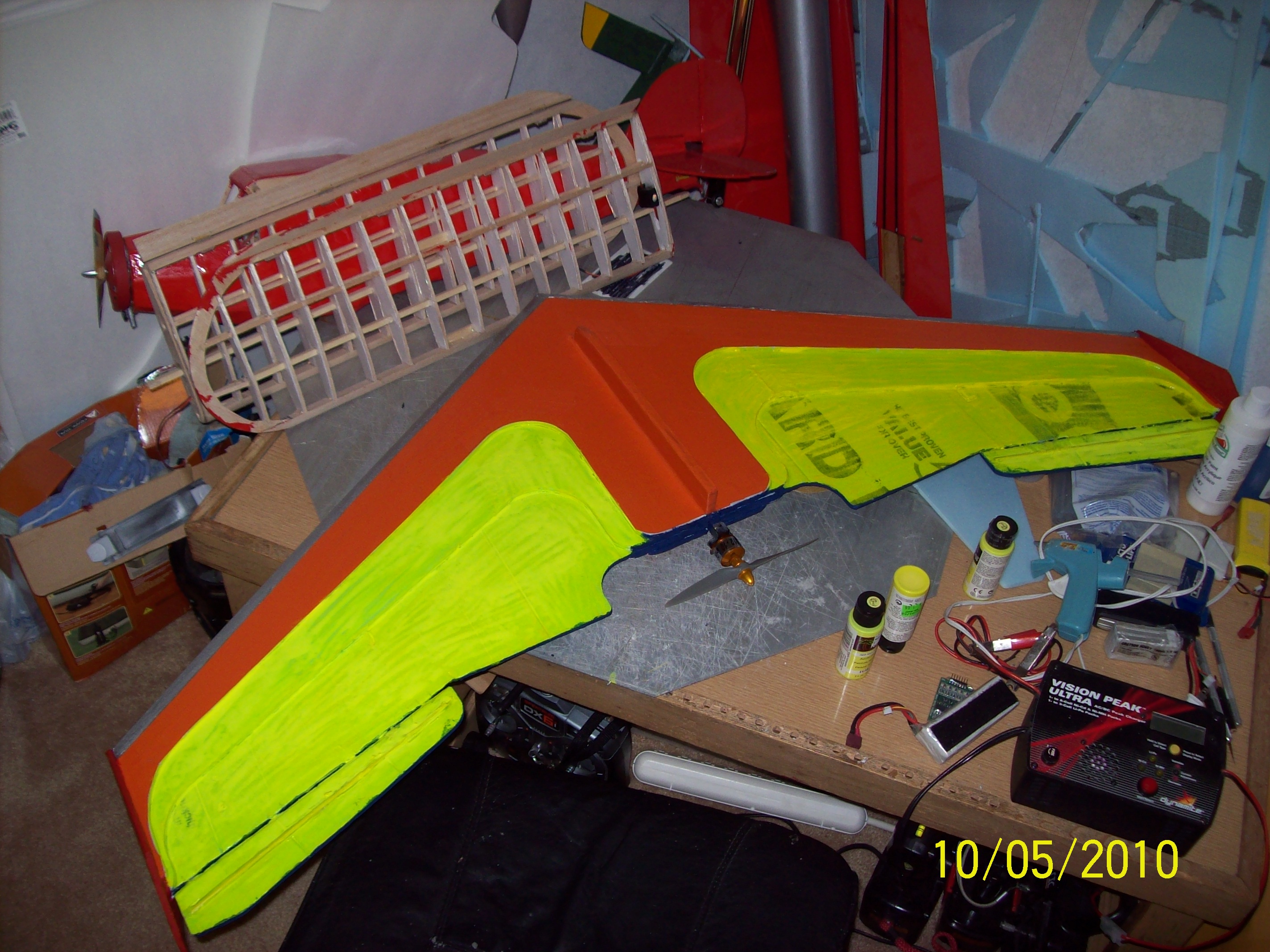

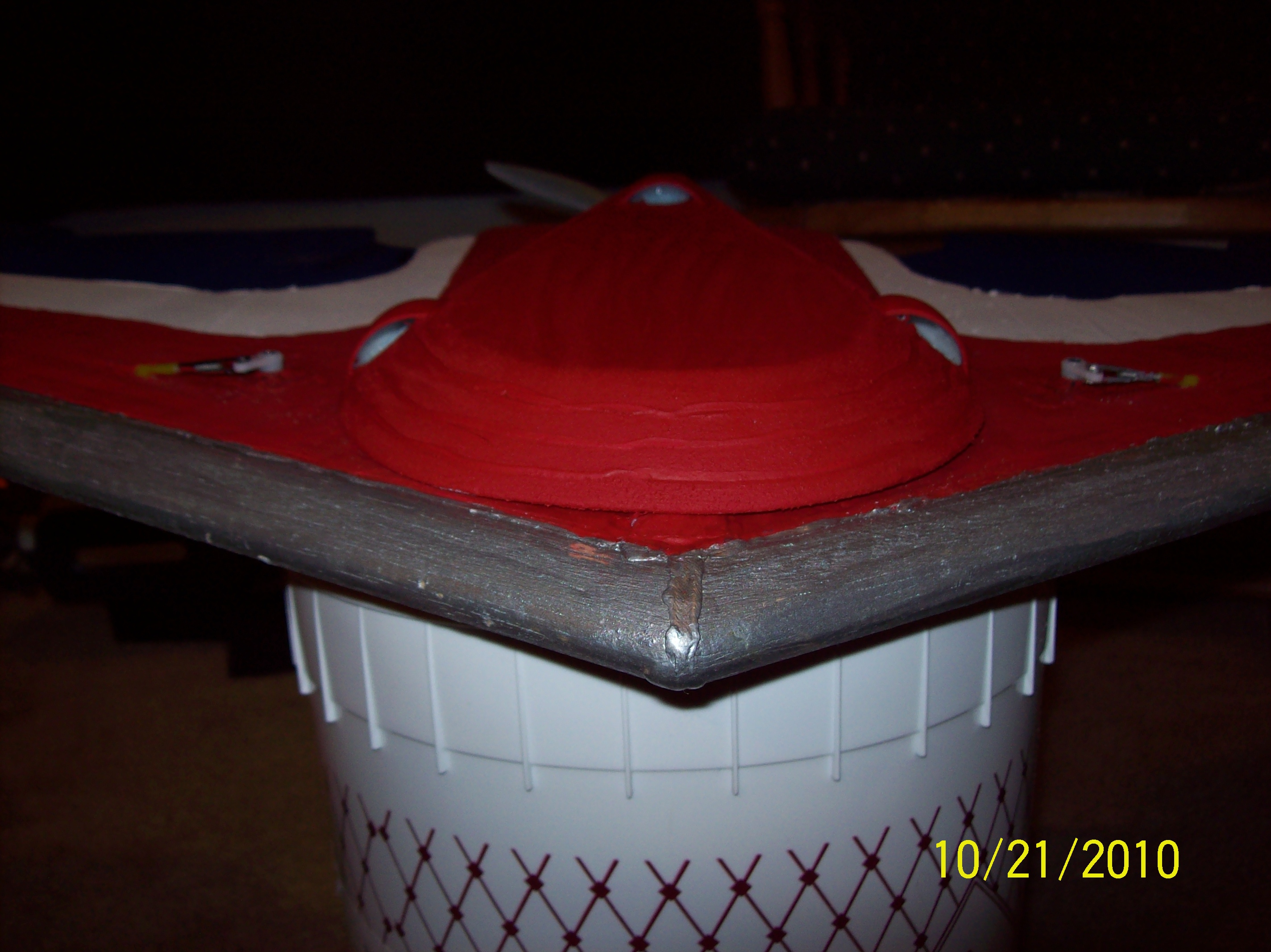

    Working on the bottom of the Divinity making it more visible in flight... The orange is tape since I could not find any Blaze orange paint that did not have Acetone in it. The yellow is Acrylic Neon Yellow paint. This should be a lot easier to see than the light blue foam against a blue sky... Mudman1959

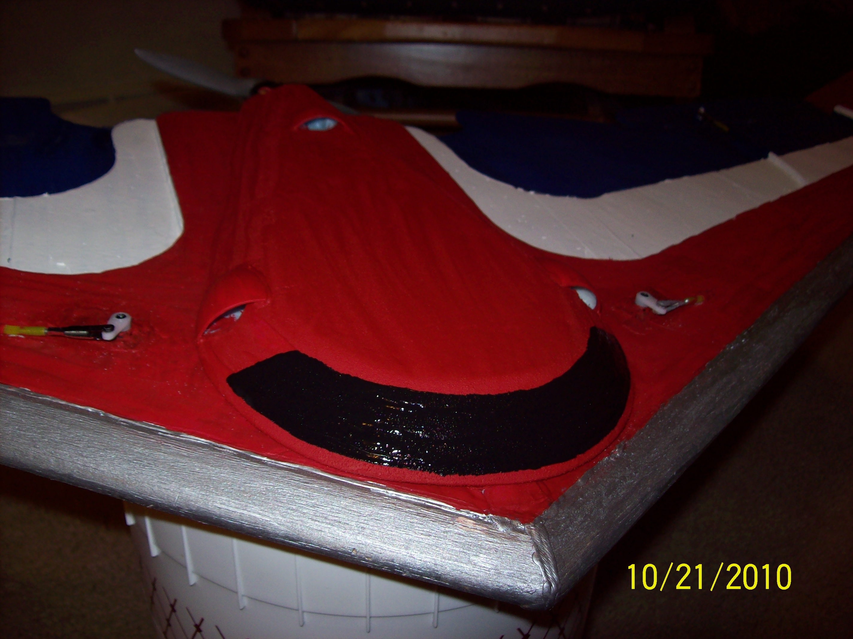

    Cut out the battery cover and got it all glued together. Added "Spoon" cooling ducts for positive airflow across the battery and ESC. Next is to hinge the cover and use magnets to hold the other side down. The cover will open from the side. Sort of looks like a B2 Flying Wing...
