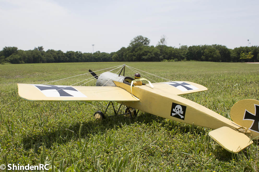

    Hello everybody, it is a very long time since I posted here, and actually I did any construction. Before I share with you my old construction, I have to confess, I did not build any aircraft for years now, but now I am ready to get back in the "game".
    So, I got all the tools from here, PhlatPrinter3 and Phlatformer, so I could build my conceptions... The Fokker EIII is fascinating for me, because was a monoplane in a biplane world and most of all, it has no ailerons. The entire wing is warping, and change the geometry in order to roll. So, that was a project for me...
    I manage to build a small airplane, using just the Phlatprinter, and most important, to replicate the wing warping.
    It had 3 servos and flew like a champ. This was 5 years ago, and since then, I like to believe, my skills have improved and my next builds will show it... Anyway, all what I'll be using is PhlatPrinter 3 and a hot wire CNC. Also, the Phlatformer.
    I will make available for the forum members the G-Code for this airplane as soon as I can... Now, I am in California, and I have no luck finding FanFoldFoam, so I will approach different foam building techniques using the PhlatPtinter.
    This being said, enjoy.
