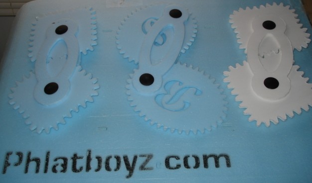

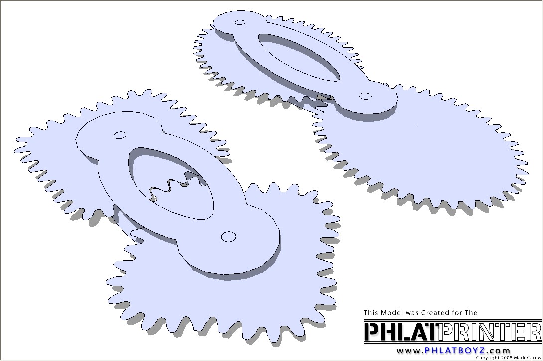

    A cool little experiment in gearing
    I saw a show where a guy was riding a bike with square wheels on a wavy runway and he was rolling along nice and smooth. That's when I started to get into non-circular gears like you see here. They just amaze me :D
    I later found a dxf of these gears and went to town in SketchUp.
    Pretty cool conversation piece.
    Have fun
    Note *Because the teeth are small I use a 1/16" bit for this cutout.
    Attached files [​IMG] Non_Circular Gears.dxf (464.8 KB)Â Non_Circular Gears.zip (378.7 KB)Â [​IMG]

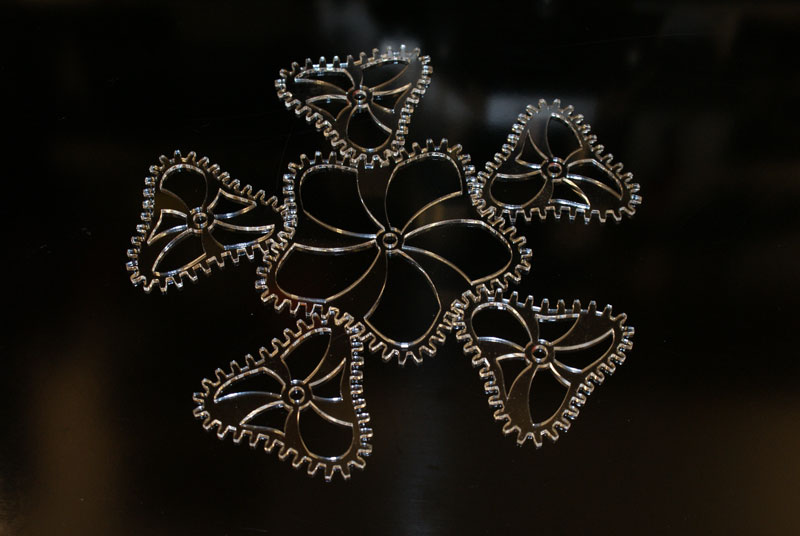

    Hi All,
    I have just received my license for the Gearotic Motion software which, if you are into gears, is just a brilliant piece of kit.
    Thought you may be interested in seeing some cut in acrylic.
    Tweakie Attached files [​IMG]
    That is truly a work of art! (to me) :D
    Thanks for sharing this Tweakie.
    I have had very little time to play with this one like I would like to but as things settle here I plan on getting into it straight away, it does some really amazing things.
    Here are some examples of somethings I would like to make :)
    Thanks again

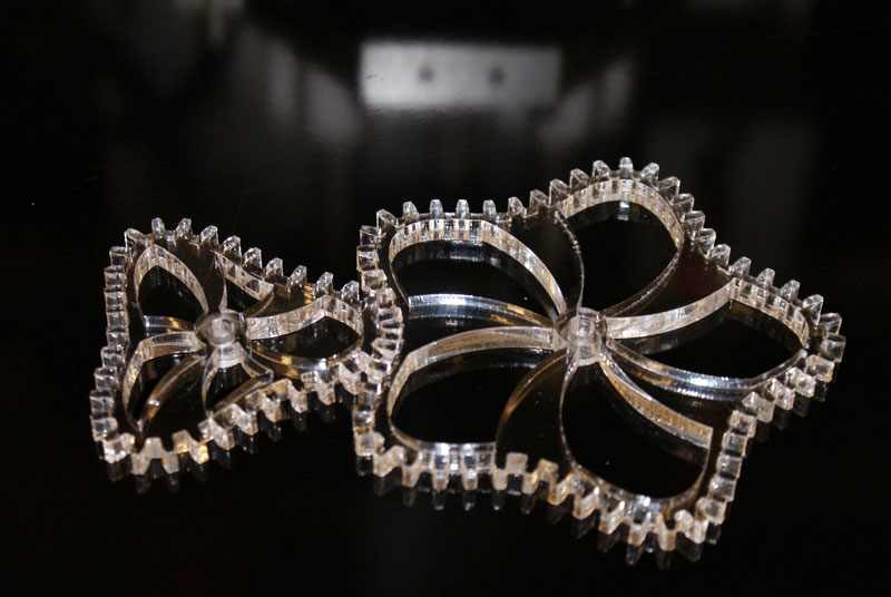

    Unfortunately the current version of Gearotic does not support non circular ring gears but who knows this feature may become available in the future.
    Of course Gearotic Motion has a much more serious side – making the GCode for spur gears / helical gears which can be conventionally cut on a rotary axis but using a parallel end mill. This arrangement circumvents the patent which was taken out a couple of years ago for this method but using an involute ground endmill. Some of the examples of gears shown on the forum are just awesome and it is well worth the visit.
    Tweakie. Attached files [​IMG]
    Those came out fantastic! Do you have any idea about how long it took to cave these out? and is that 1/8 or 1/4 thick?
    Thanks Tweakie
  11. Tweakie
    Tweakie Member
    233
    They are 6mm acrylic and were laser cut taking about 15 minutes for the pair, the largest is about 100mm across. (Those in the first picture were 3mm).
    Tweakie.
    Thanks Tweakie! They are truly awesome. I am guessing you are planing to mount them and try them out? :)

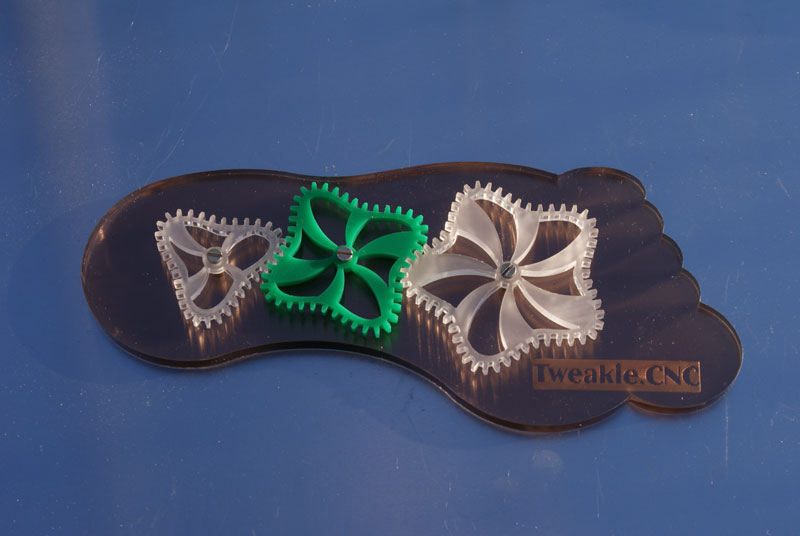

    A few more cut from acrylic and mounted.
    Nice! Is the rotation nice and smooth?
    I bet they are cool to see in action
    Thanks for posting
  15. Tweakie
    Tweakie Member
    233
    They do run nicely but the motion is not linear as can be seen in this simulation http://www.youtube.com/watch?v=_I_sMO_cTrc
    They are strange but fascinating to watch and I am sure that these gears have an application for self build wall clocks which could have stunning visuals such as the kinetic sculpture in another thread.
    Tweakie.
