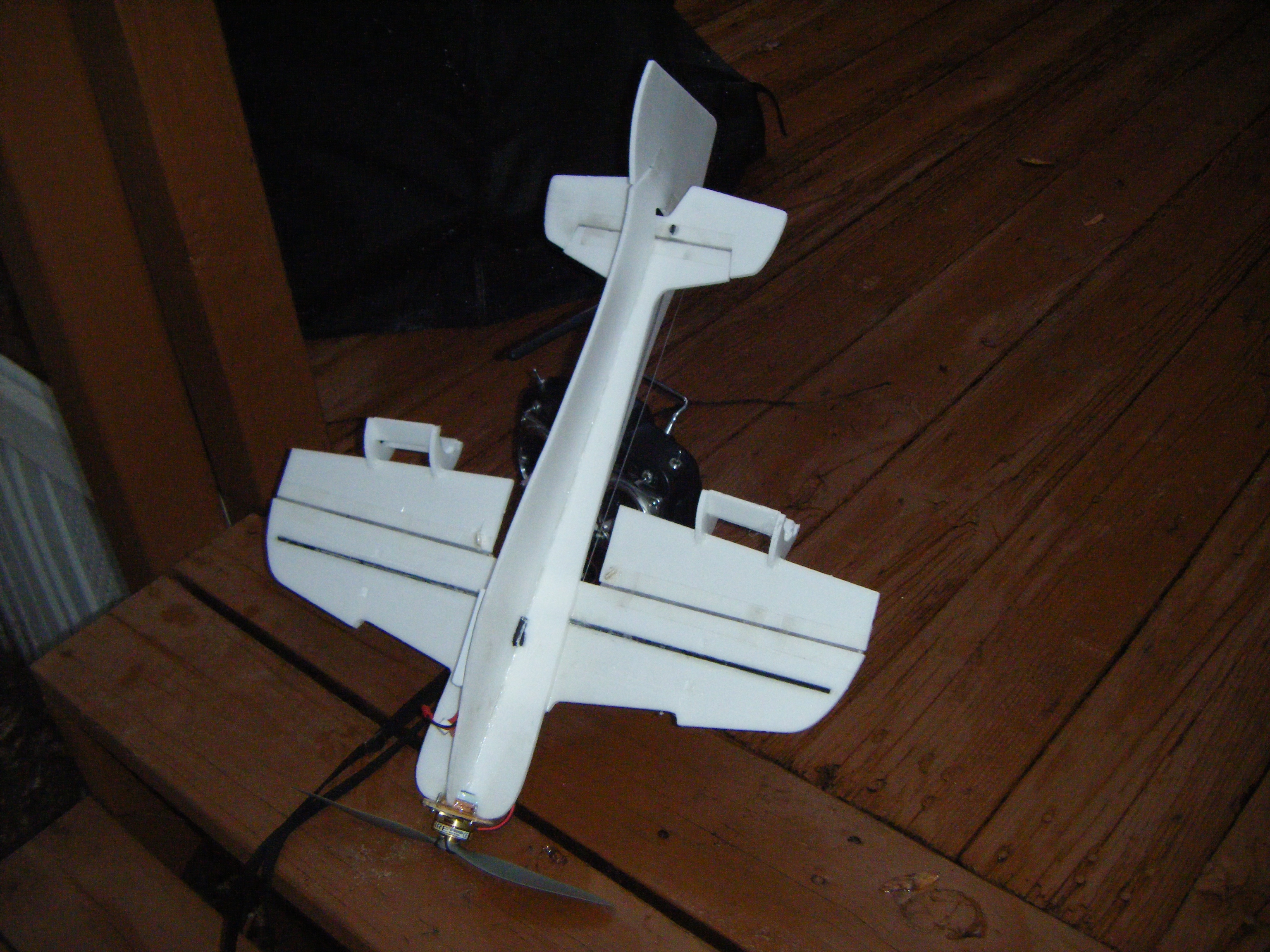

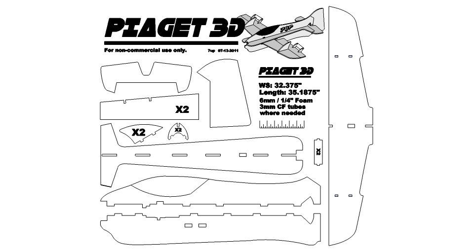

    Yes, I know, another profile 3D plane . I worked this plan up for a guy who wanted some CNC cut, but due to some health issues I haven't been able to cut them, but the plans are done and no need for them to go to waste. Maybe someone can use them.
    Your choice of 1/4" / 6mm foam, tab and slot construction, carbon fiber where needed, you know the routine.
    Oh yea, the air-brakes are optional. If not desired, don't cut out the two slots on the trailing edge of the ailerons.
    Now, back to my airboat.
    Attached files [​IMG] [​IMG][​IMG][​IMG][​IMG]

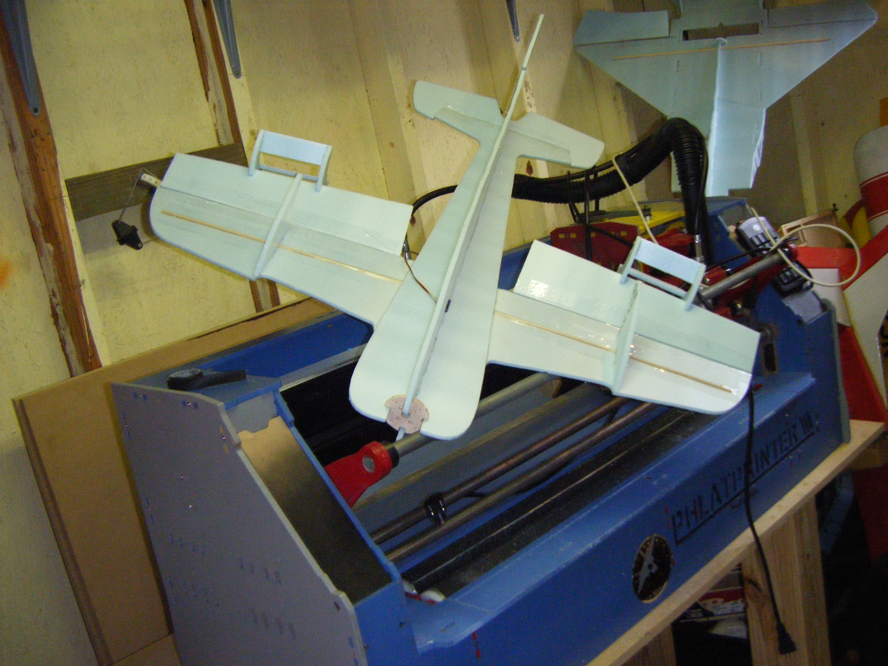

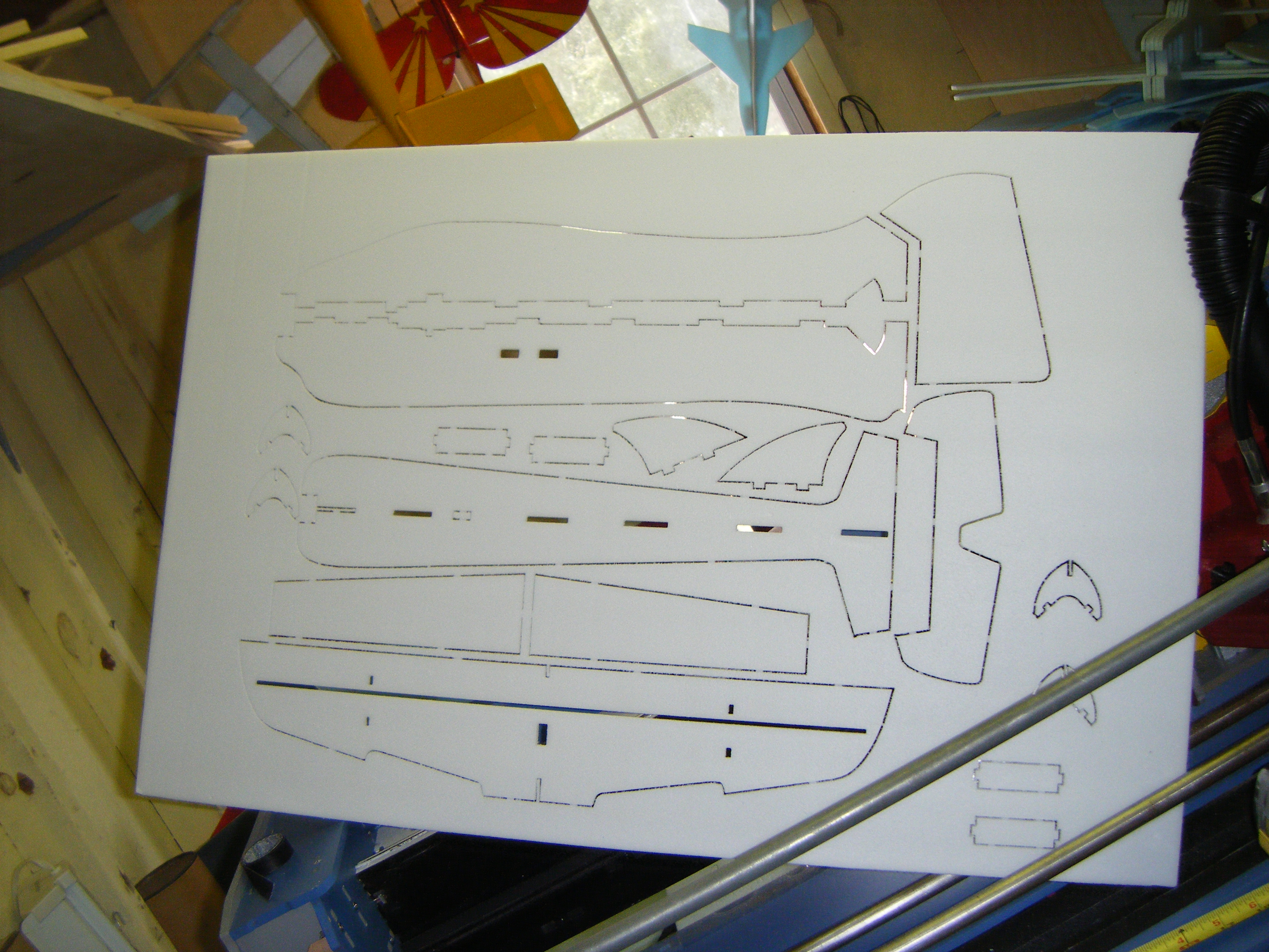

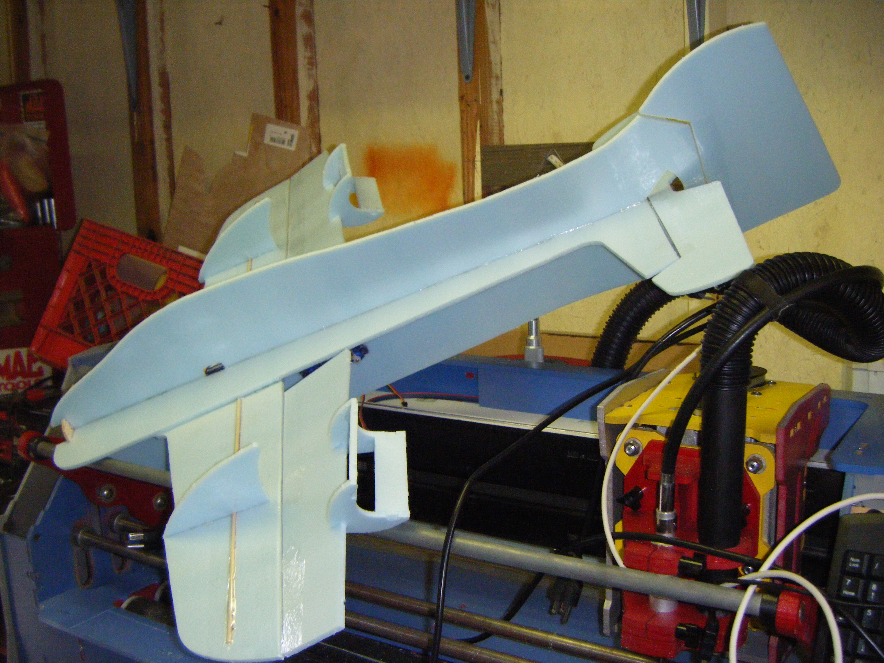

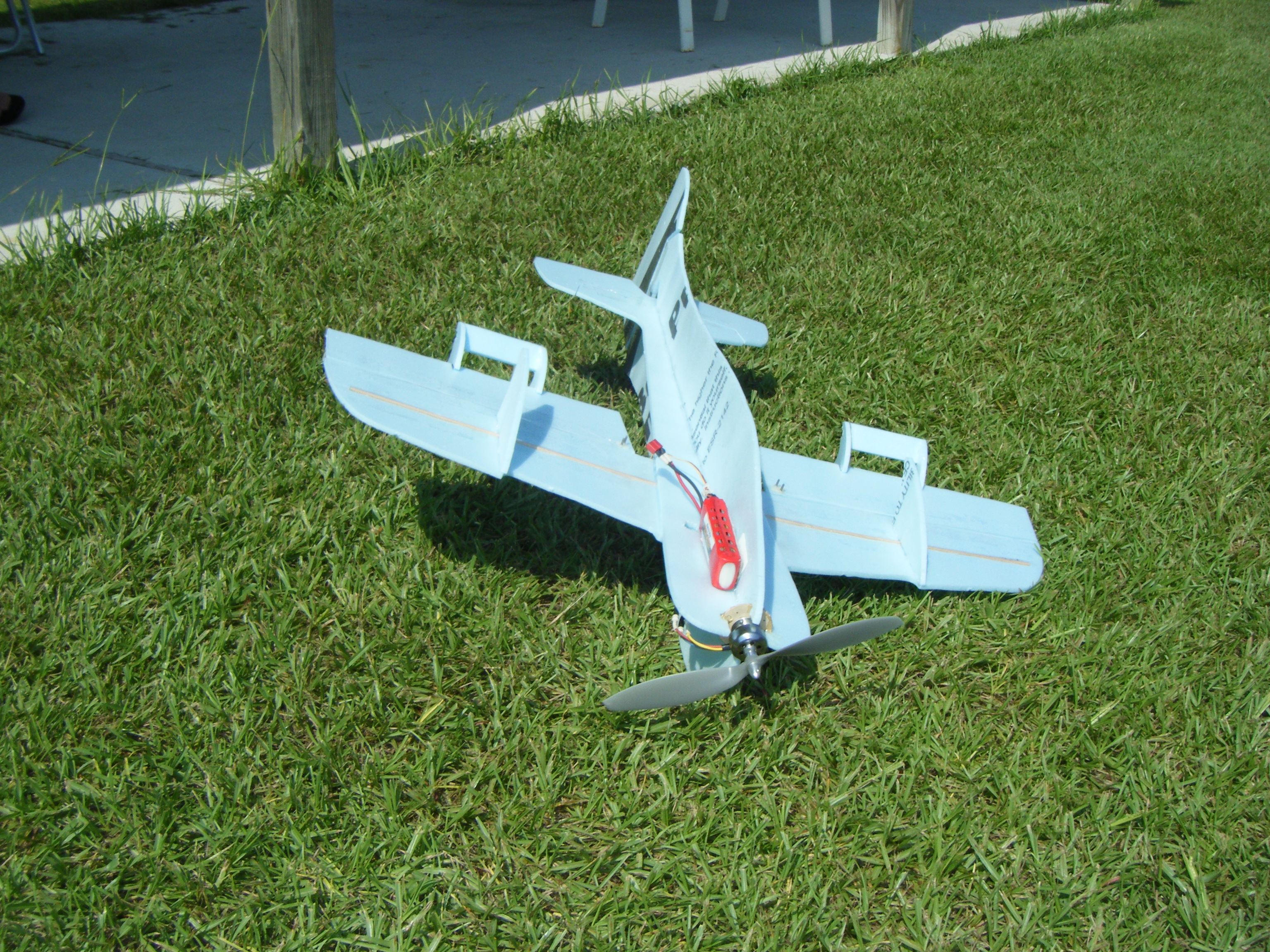

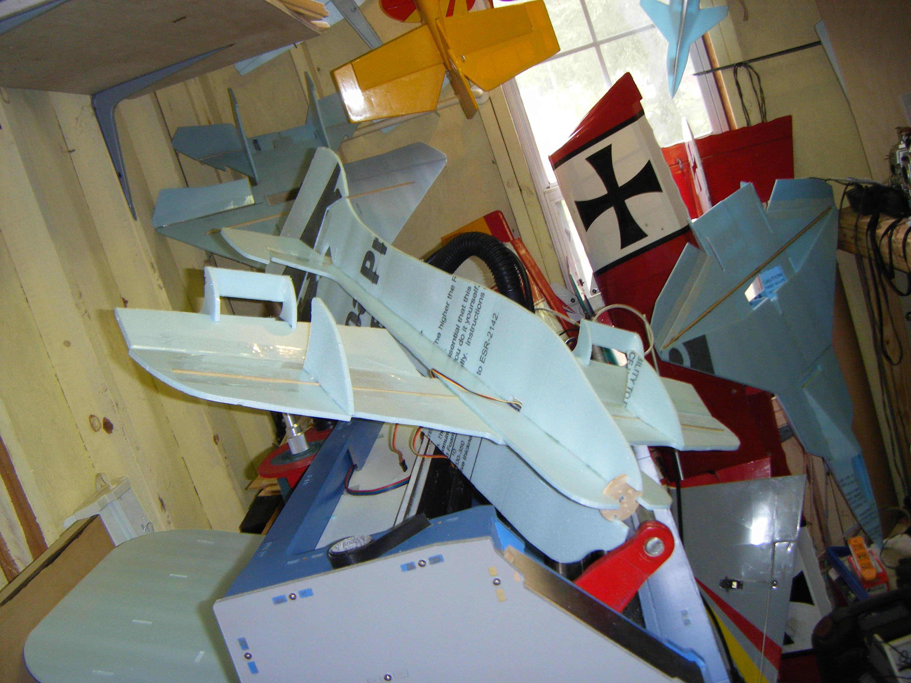

    hey 7up nice plane.just cut out this moring.hope to get done this afternoon want too see how it flys.
    dan :good: Attached files [​IMG] [​IMG] [​IMG] [​IMG]
  8. 7up
    Very cool! Looks like you are the test pilot. Let us know how the maiden goes.
    Please leave me any feedback on how the parts fit and wfere I need to make adjustments as I have not had a chance to build one myself.
    I know I need to add the fold line for the spar to the wing. I forgot it when I posted the SU file.
    Great build job! :doubleup:

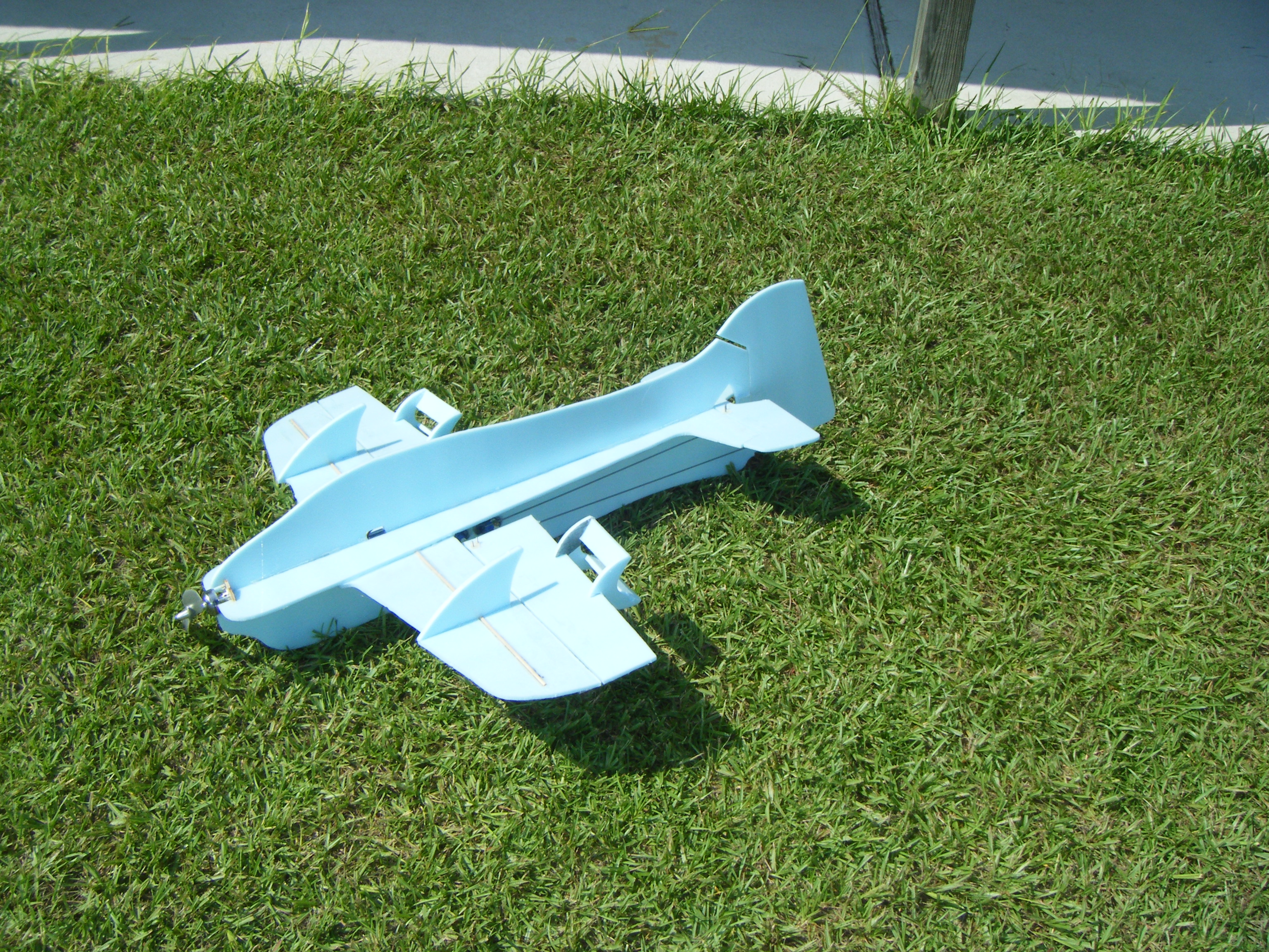

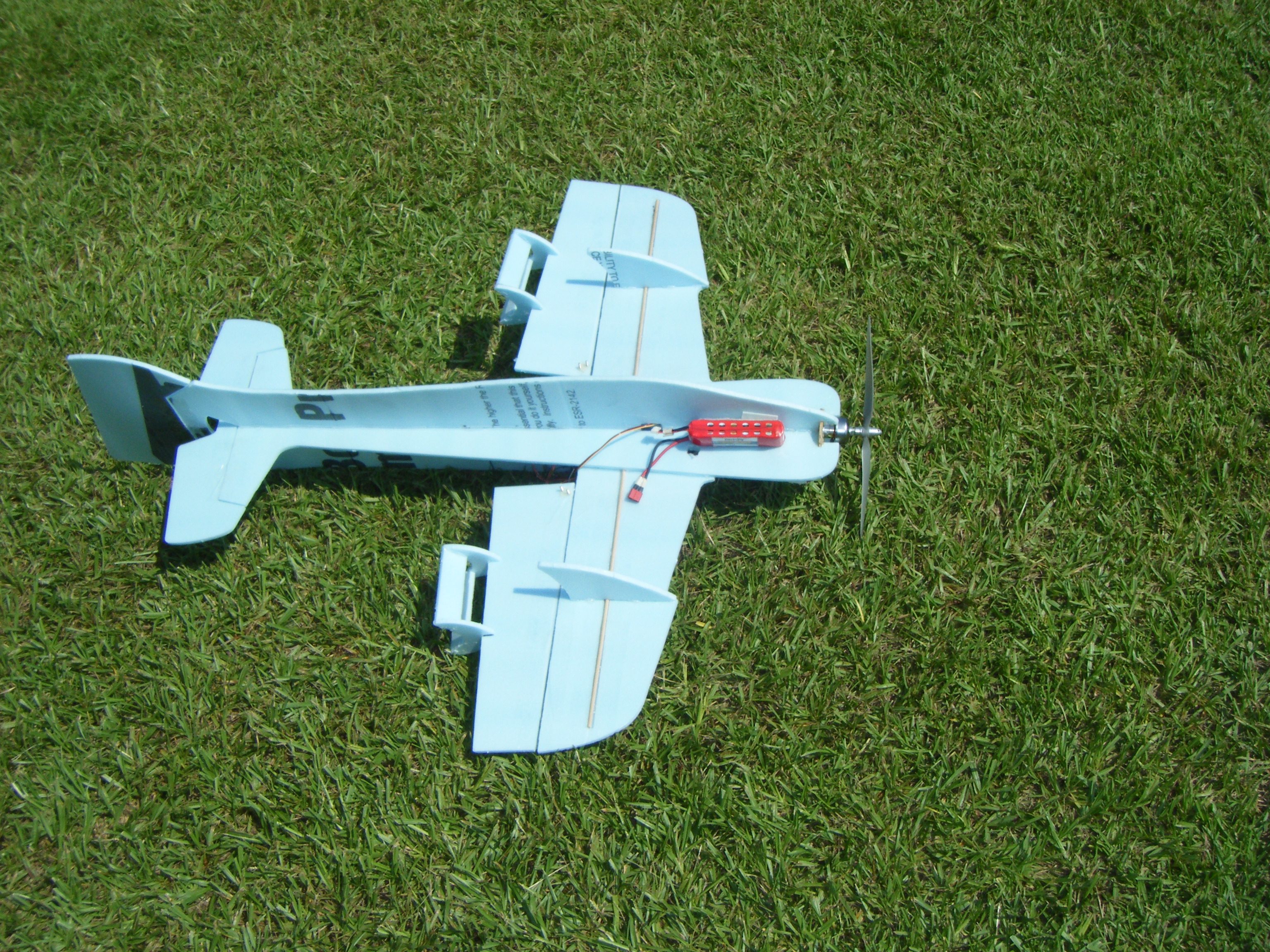

    hey 7-up got too fly the plane today all i can say its awsome.flys great on low rates and high rates.not only will it do 3d but will make a good patteren plan with out the air brakes on the wing.got two videos first one is just a short flight the 2nd got some fotage my son film more sky then plane.http://www.youtube.com/watch?v=Epgh-ra7 ... rofilepage. http://www.youtube.com/watch?v=_qZdE1qo ... rofilepage. 7-up thanks fore a great plane. one thing had wing flex my fault .i used a 1/8" wood dowl.going too cut new one out and use carbon this time. :doubleup:
    set i used was a tp 2409-18 apc 10*3*8 prop 3 cell 1050mah batt. Attached files [​IMG] [​IMG] [​IMG]
  10. 7up
    Great job Dan! Glad to kmow it flies. :dance3:
    Thanks for your build, pics, videos and all your input, it helps alot.

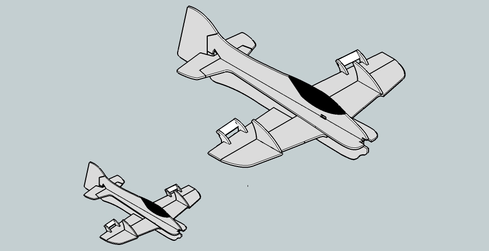

    I think Mark was going to scale it down for micro gear but he stays pretty busy. If you have an idea of what size you'd like to try, I can scale it down and set it up for 3mm foam. Indoor season is coming fast, but I have no indoor facility so I've never really got into the micros but the scaling part I can do.
    -Buk
  13. nstaller
    nstaller Member
    52
    I looked and the micro version has a 16.5" wingspan , I am currently building a second one for night flying should hopefully be done in a day or so.
  14. 7up
    I added the 16.5" WS version to post #1. I left the servo cut-outs out of this one because I am not familiar with the micro gear.

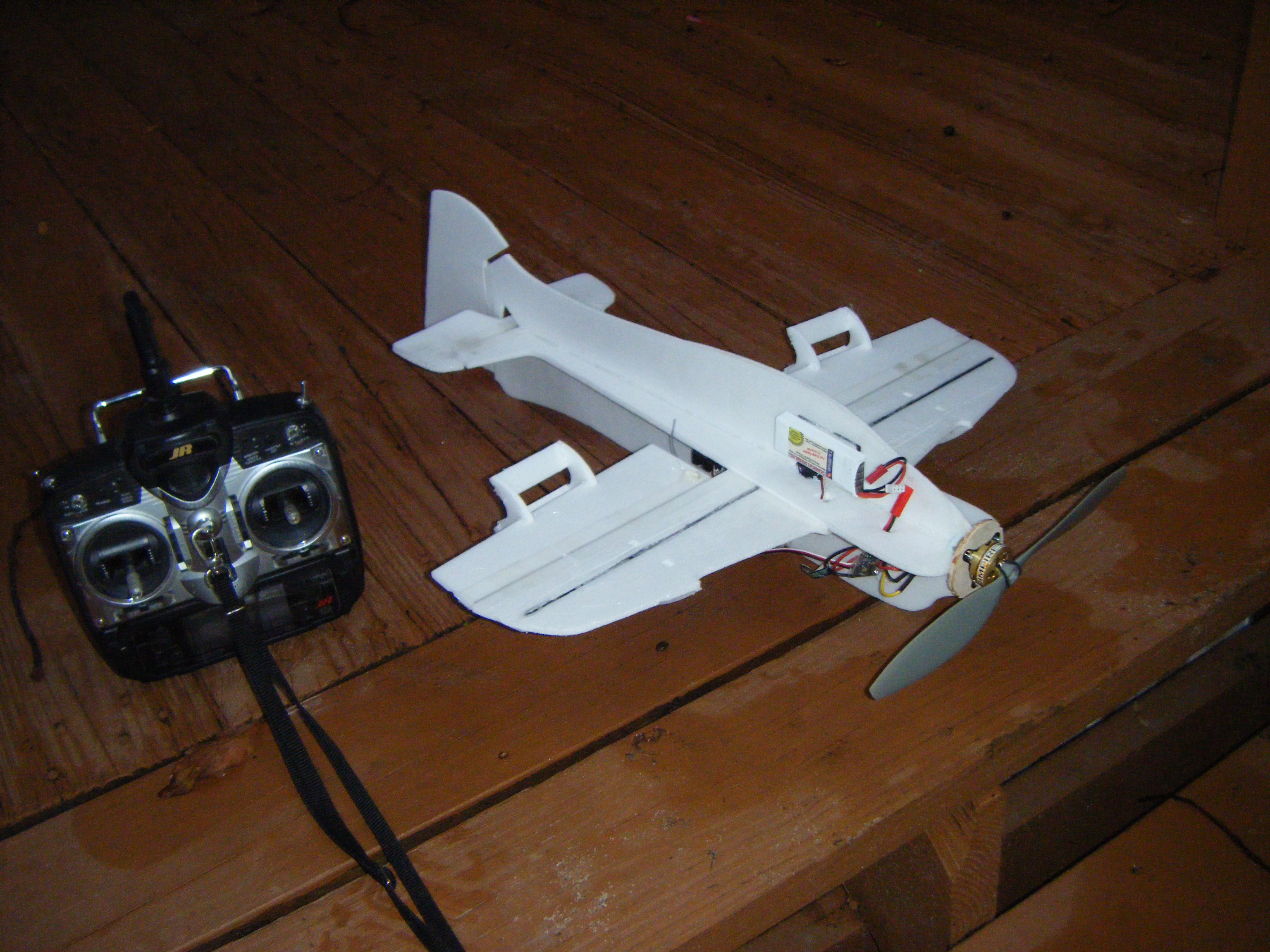

    hey 7-up just cutout a scaled version this moring out off dollar tree board.going too give it a try.
  17. nstaller
    nstaller Member
    52
    looks good, I cut a micro one out today, need to put it together.
  18. popedan41
    popedan41 Member
    39
    panama city fl
    nstaller got it all together and ran up the motor.hope i can maiden tomm after work. :D

  23. ewo
    Thank you Buk ! :D

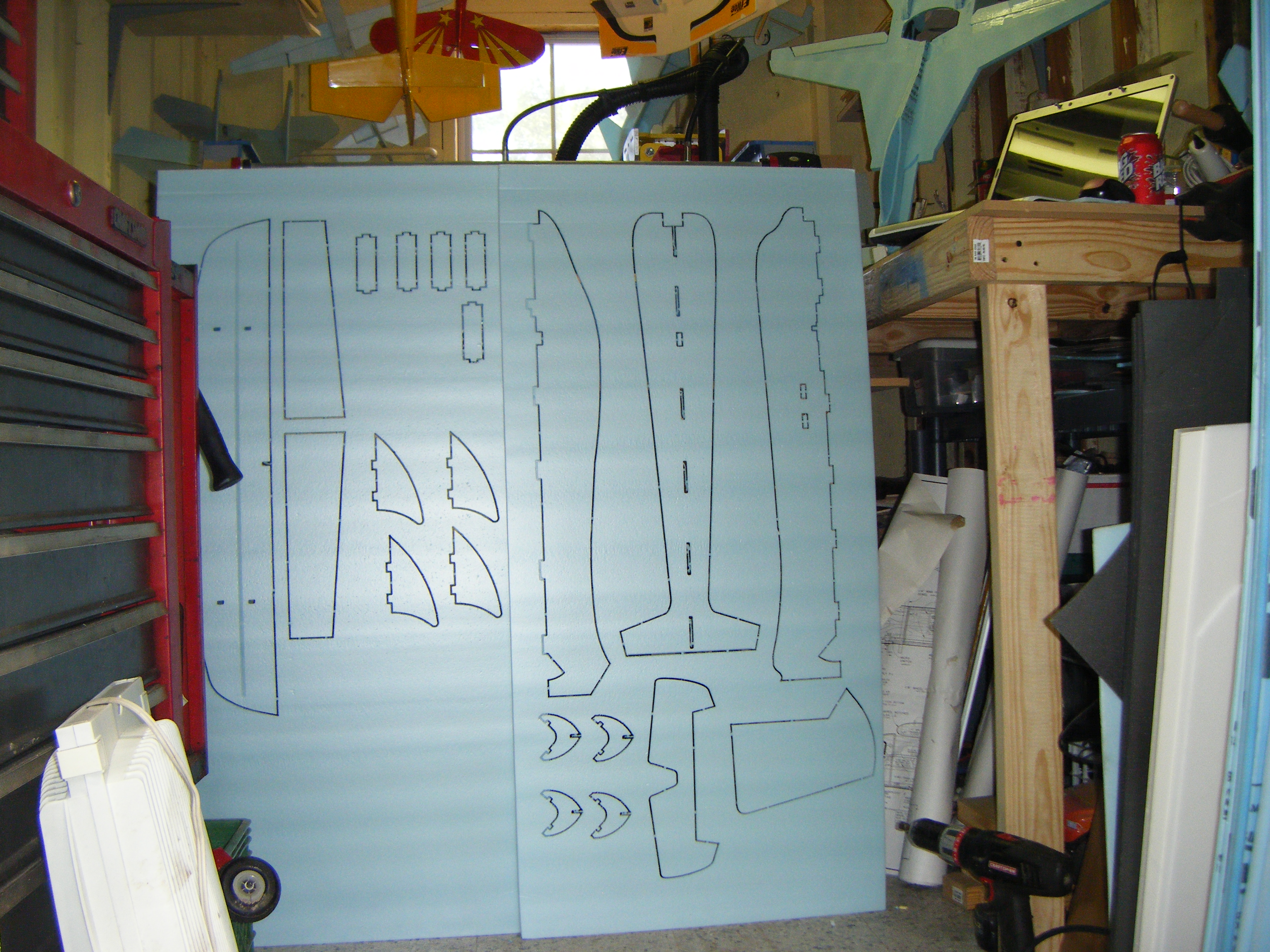

    Here is where im at right now. Still have to add the tabbing and do a couple other little things
    But i should be able to cut tomorrow.
    EDIT: Cut today :lol: [​IMG]

    Very nice job Bruce! I like the parts modifications very much. :doubleup:

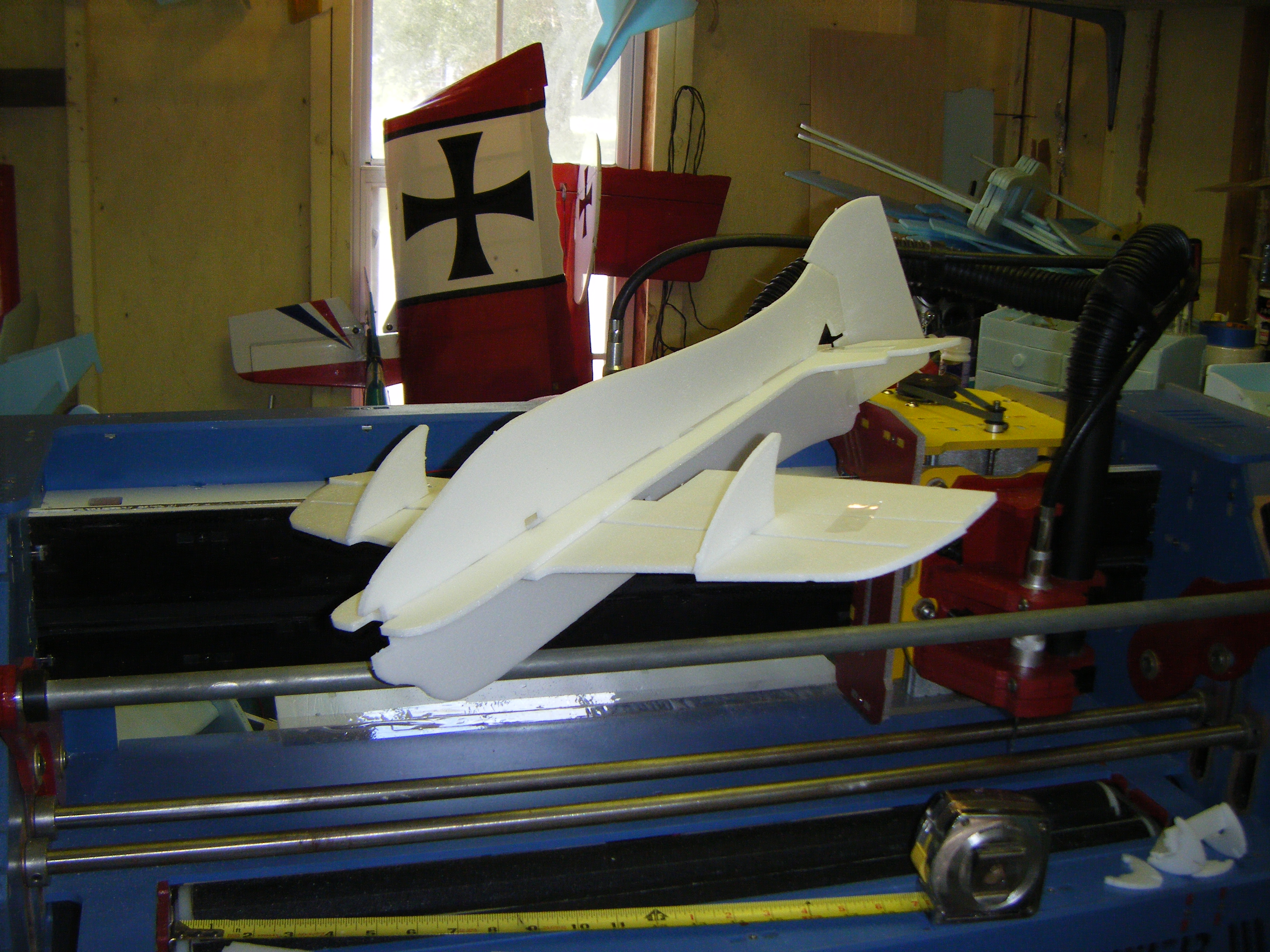

    I cut this out this morning and found a couple little problems . :shock:
    The problems have been fixed and im about to cut another. :p
    I will put up the SKP and cnc files after i make shure the parts fit
