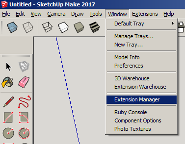

    • open Sketchup Make 2017
      • click Window
      • click Extension Manager [​IMG]
      • click Install Extension
      • navigate to the downloaded file
      • click Open
      • click Yes at the security warning

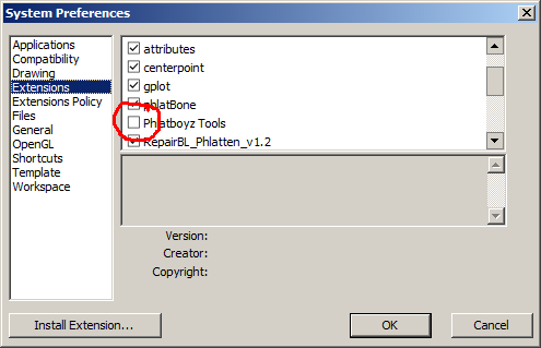

    • Make sure 'Phlatboyz Tools' is ticked in the list of extensions. This applies especially to Sketchup Make 2016, make sure you tick the box next to the plugin name as indicated in the image below. installandtick.png

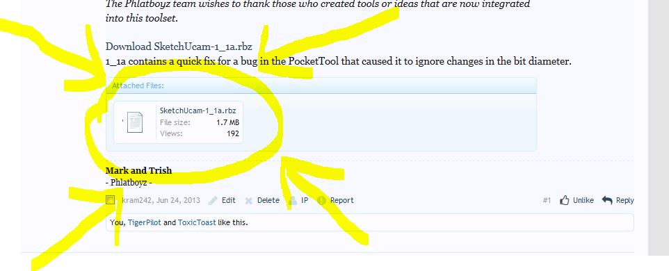

    DOWNLOAD FROM THE LINK JUST BELOW THIS
    1_1a contains
    • a quick fix for a bug in the PocketTool that caused it to ignore changes in the bit diameter.

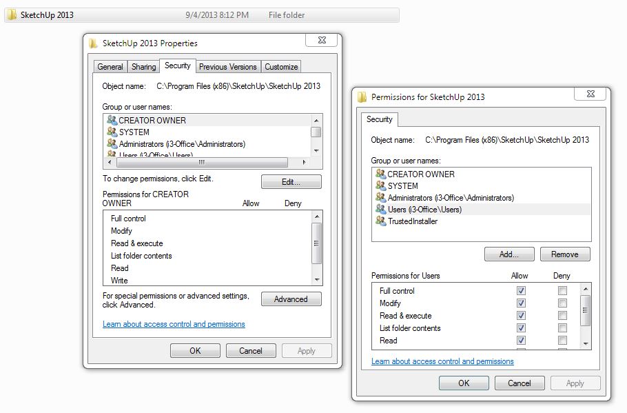

    If you are not an Administrator level user on your Windows 7 computer you will need to set 'Modify' permissions on the Sketchup folder.
    For Sketchup Make
    c:\Programs Files\Sketchup​
    For Sketchup 7 or 8
    c:\program files\Google\Google Sketchup [7|8]​
    HOWTO (for Sketchup Make, change paths as above for V7 or V8)
    1. Close Sketchup
    2. Open the 'Programs files' folder
    3. Right click 'Sketchup' (or 'Google Sketchup 7|8' if you have that)
    4. Select 'Properties'
    5. Select 'Security'
    6. Click 'Edit'
    7. Select 'Users'
    8. Put a check next to 'Modify'
    9. Click 'Apply'
    10. Click 'Ok' and repeat till all the dialogs are done
    11. Now install SketchUcam
    Reason for this: Sketchup Make claims to honor language resources in the plugins local folder, but in testing it did not. Sketchup 8 makes no such claim and the resources file HAS to be in the Resources folder.
    The solution is to put the language file into Sketchup/Resources, but to do this the script needs Modify permissions. Phlatbones saves your diameter setting and will read it next time it starts, so it needs to write a little file for that, and again need Modify permission to do it.
    marcomartim likes this.

    I must be doing something wrong. I installed Sketchup 2013, then the extension, but only phlatbone shows up in the toolbar selections. Nothing for the second toolbar, Sketchucam tools. I installed 2013 because I did not want to make any changes to Sketchup 7 which is working fine. I am running Windows 7. When it did not show up, I tried uninstalling, deleting all traces of files left over in the plugins folder and got same results.
  5. swarfer
    swarfer Moderator Staff Member
    808
    Grahamstown, South Africa
    2 ideas...
    1 - after the install, you see the Phlatbones toolbar but not SketchUcam, so you need to enable it in the Toolbar menu.
    Click View | Toolbars and then look down the bottom for 'Phlatboyz' which needs to be ticked. Though I have tried to make it visible automatically it doesn't always obey.
    2 - MyConstants.rb - did you create one? if you did , and it has any syntax errors, the toolbar will not load. You will need to fix MyConstants.rb first. You can get help on this via the SketchUcam help which you can find on the Tools menu
    = Tools|Phlatboyz|Help (with SketchUcam intalled of course).
    Note that you don't have to have a MyConstants.rb. If it doesn't exist that is ok. If it does exist, it will be loaded.

    I'm having the exact same issue. I installed Make 2013 and then installed SketchUcam as per instructions above. The only thing I see under the Toolbars menu is for Phlatbone. Phalatboyz is not even there for me to click.
  7. Flashsolutions
    Flashsolutions Active Member
    1,123
    Leesburg, Florida
    1. It does not appear in the Toolbar... that is the problem in of itself.
    This is a new install of Sketchup, so MyConstants.rb does not exist.
    When I reopened Sketchup, I get all these errors...
    Error Loading File gplot.rb
    Permission denied - C:/Program Files (x86)/SketchUp/SketchUp 2013/Resources/en-US/PhlatBoyz.strings
    Error Loading File phlatBone.rb
    Permission denied - C:/Program Files (x86)/SketchUp/SketchUp 2013/Plugins/phlatBone/phlatBone_prefs
    Error Loading File phlatboyztools.rb
  8. rayclark
    rayclark Member
    134
    Center of Michigan
    Ditto...exactly the same errors I am seeing
  9. swarfer
    808
    aha! you need to have write permissions in those folders, obviously. I've never seen this problem because I am *always * 'administrator' equivalent and I always turn off the stupid 'user account control' in Win7 which also does weird things to your permissions. I don't have a machine here to test this on so you'll have to wait 10 hours or so or just Google for a howto on getting permission on folders in Win7. I only use Win7 at work, Linux here at home, so I'll need to get there to do a full howto on fixing this.
    EDIT: see post #3 for details on setting permissions. I had some screen dumps to visualize it, but got a file upload error.
  10. 3DMON
    2,378
    Yep I had to change my permissions to get the toolbar to show up.
    Right click on the Sketchup 2013 folder and change the permissions there by clicking on the edit button. Skechucam permissions.JPG
    ToxicToast likes this.
  11. rayclark
    rayclark Member
    134
    Center of Michigan
    Changing the permissions worked. Thank you
    swarfer likes this.
  12. Flashsolutions
    1,123
    Leesburg, Florida
    Ahh yes, works here too... Thanks for investigating.

  14. 3DMON
    2,378
    Scroll down to the bottom of the first post. It is the .rbz file.

  16. JFrey
    JFrey New Member
    1
    1
    hello Can't find a valid link for downloading sketchupcam !
    Someone help please ?
    Regards
    JFrey
  17. 3DMON
    2,378
