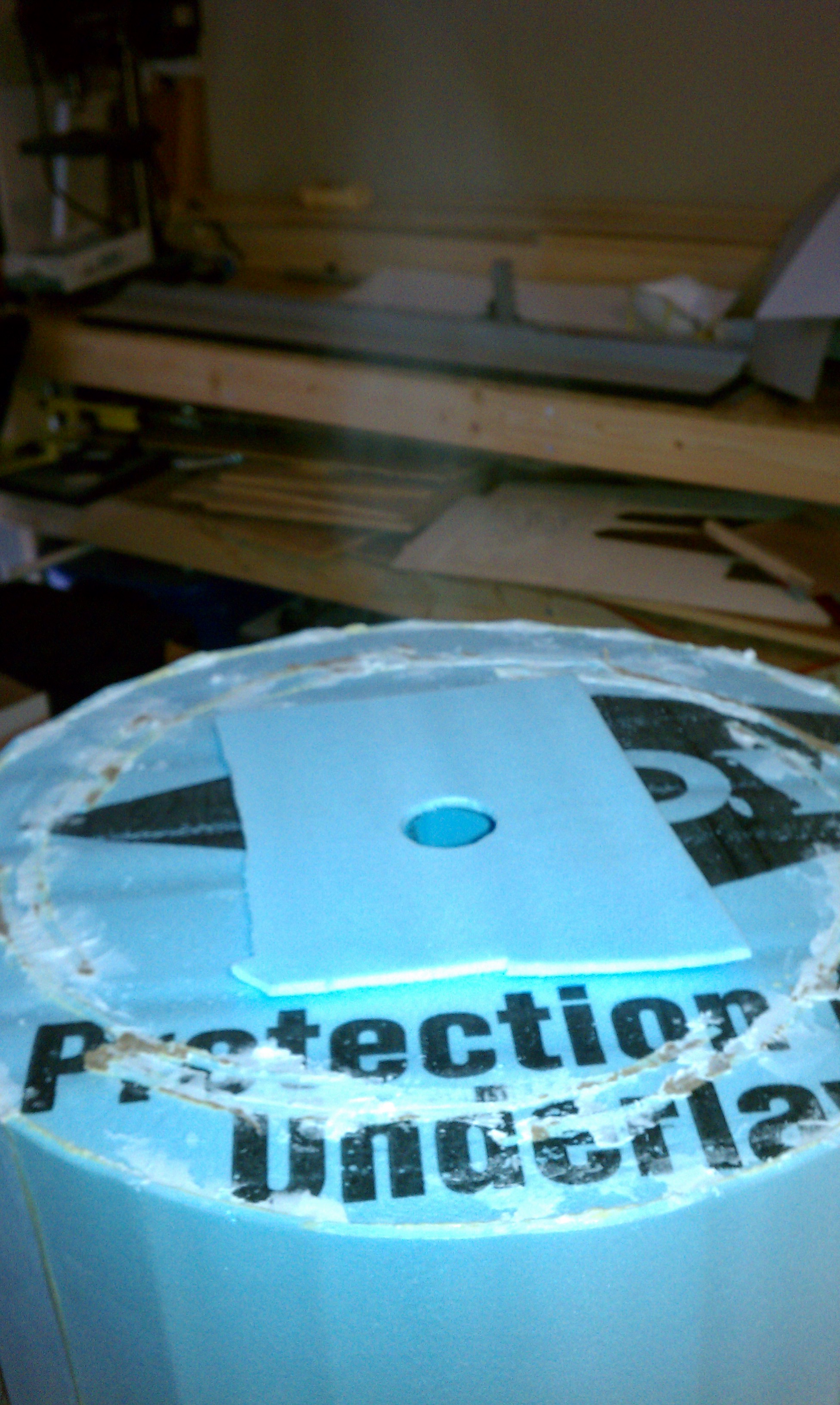

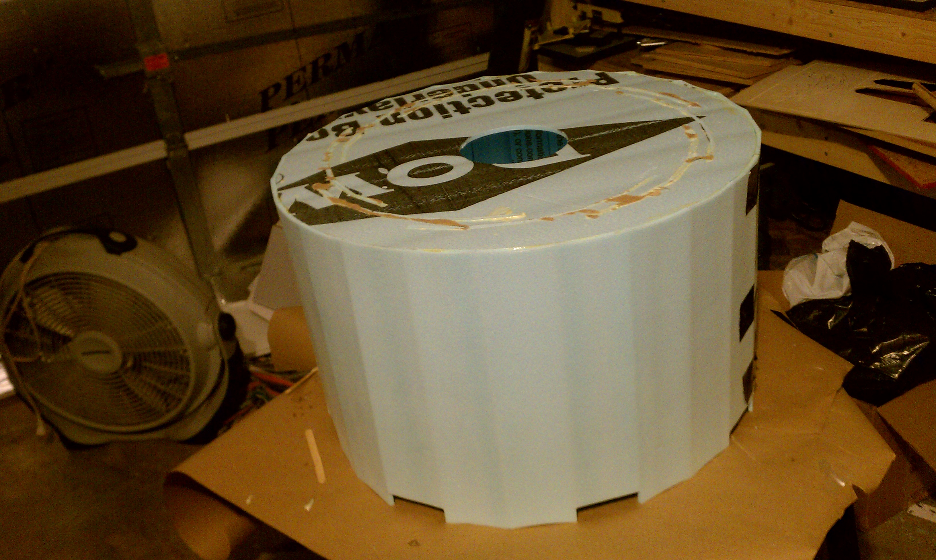

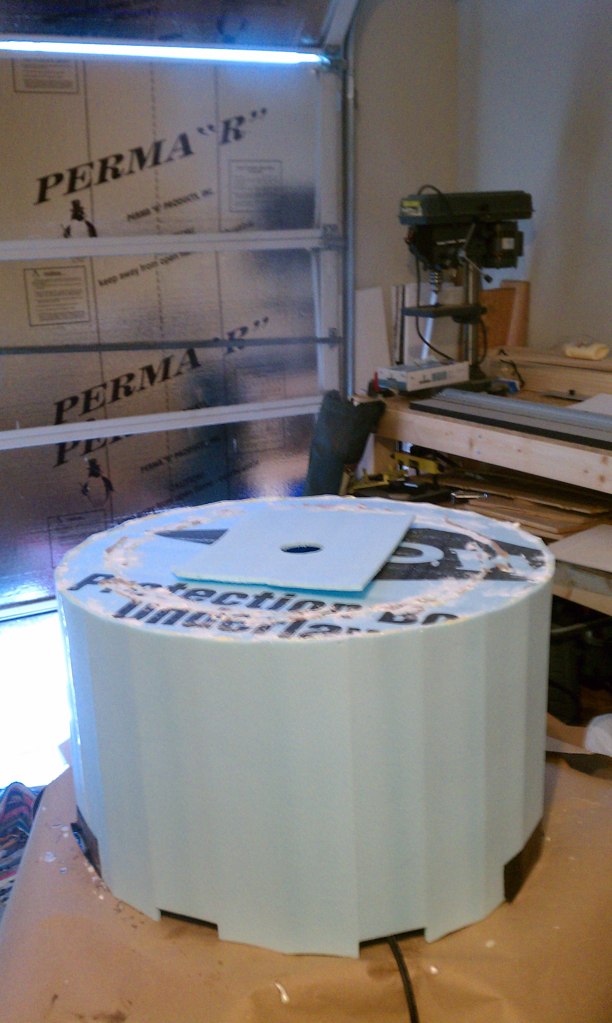

    This is my attempt to study the viability of what is known as an Atmospheric Vortex Engine (AVE). They have been developed as a possible green energy power generation. It is similar to the draft towers that run in Spain and the one being proposed in Brisbane, Australia with the exception that this is designed to be more efficient. This is because by creating a vortex it acts like a huge chimney allowing the effective temperature difference to be greater thus producing a greater temperature difference. Additionally, like hurricanes the latent heat as well as the raw temperature aid to drive the system. See http://www.vortexengine.ca for more details. I wanted to try to build one to see if the principle was easily implemented and to see if something could be made for field use to charge batteries.
    Unfortunately, Its not and instead of getting a nicely formed mini tornado It was more like a steam vent. There was some rotation but not much. and certainly not enough draft to turn a generator. It may be possible with much more engineering work. I have included some photos, a video, as well as the plans I drew up in case anyone else is interested in giving this a shot. Sketchup8

    I took a look at the vortex engine website and it looks like a good way to get a little energy out of the waste heat in thermal power plants.
    It probably wont be very efficient because the temperature differential is really low. The process steam in most thermal power plants is condensed at about 32 degrees C under a vacuum to make the most out of it in the main turbine. There is still a ton of energy in that steam but not many devices can make use of such a low temperature heat sorce.
    What were you using as a heat sorce? Something like this can only really work as a way to recover otherwise lost heat and doesnt really generate energy on its own.

    I was using the rival skillet that everyone uses for the phlatformer to boil some water. Like I said earlier this was mainly to test the principal and see how easily doable it was. If it was going to work I was thinking of using the built up heat in the attic to run with some kind of piping to the outside for home use. For field I as thinking of building a plexiglass base to heat up. That was the idea but as this quick test showed there wasn't enough in that to make it practical.
